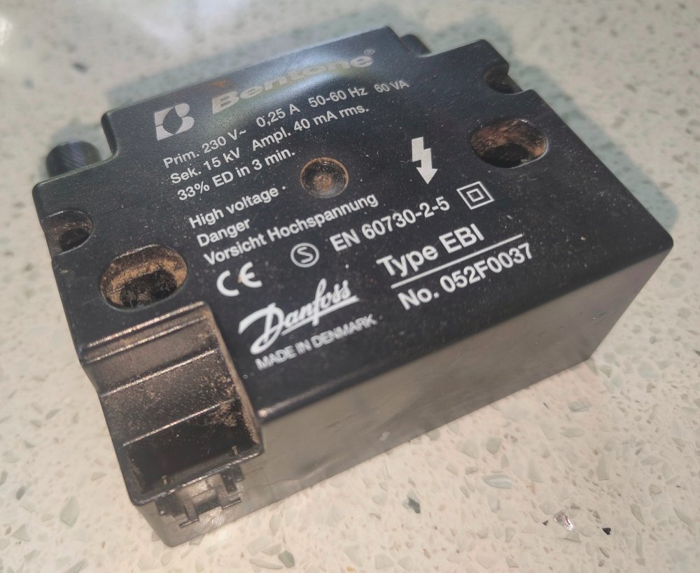

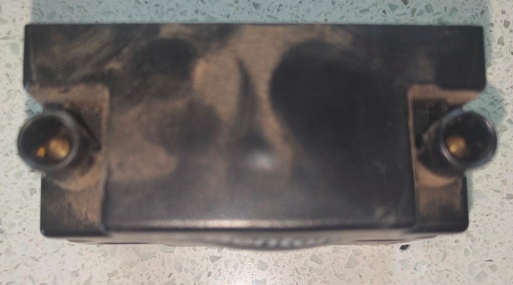

Bearing in mind, that I have already replaced the ignition unit (transformer?), it appears the control box is suspect!
Talking about the transformer, the last time I replaced one was on my previous burner. It was a Selectos. The core of the transformer was an iron laminated one. It stepped up the mains from 230 volts to 9000 volts app. . It carried a death warning. I still have a spare!
Many thanks to yourself, Bob and Oilhead for your help.
Since, I have replaced the transformer unit, is it quite safe to connect 230V across the removed unit and see if a spark is produced?
