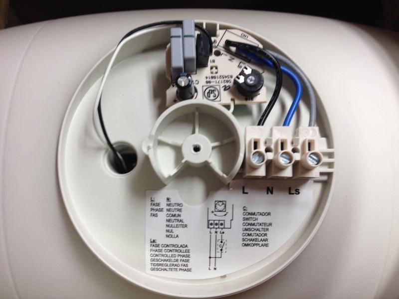

Ok so the new fan has turned up and I'm all set to wire it in tonight.

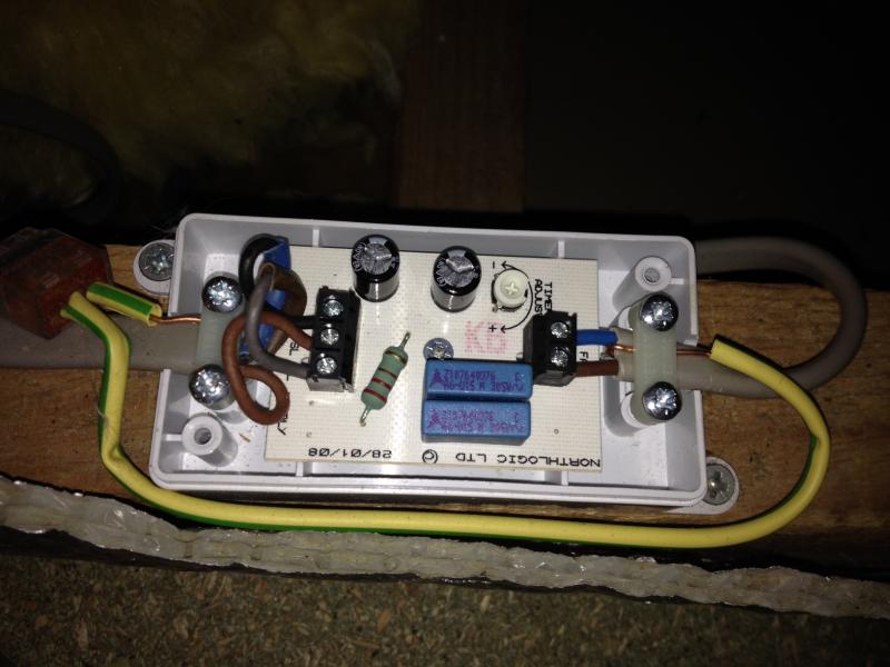

The current fan is wired from the isolator through a separate overrun timer box seen here...
The power comes in to the timer on the left (from the isolator switch), there is what looks to be a little fused earth box and then it goes out (just L and N obviously) to the fan.
The new fan has a built-in timer so I need to get the switched live directly to it from the isolator (bypassing the current timer and making it redundant obviously).
My question is, can I just replace the current timer with a simple junction box (something like this?) and replace the current 2-core + earth that runs from the timer to the fan with 3-core + earth?
Or is that really naughty? Do I need to go right back to the isolator and do a new run of 3-core +earth going directly to the fan?
My question is, can I just replace the current timer with a simple junction box (something like this?) and replace the current 2-core + earth that runs from the timer to the fan with 3-core + earth? ... Or is that really naughty? Do I need to go right back to the isolator and do a new run of 3-core +earth going directly to the fan?
Although it's always better not to have 'unnecessary joints' in cables (so that replacing all the way back to isolator would be the ideal), in principle, there's nothing wrong with what you suggest. However (a) you would need a 4-terminal junction box for the 3C+E (the one you link to has only 3 terminals) and (b), although a JB like that one would be OK if (as is probably the case) it were going to remain 'accessible', if it were not going to be accessible, you'd have to use a 'maintenance-free' one.

Thanks for that John, I was going to ask about the earth actually. There's no earth terminal on the new fan...
As the bathroom lights and extractor are on an RCD is there still a need to pass the earth through to the fan. And if there is, what would one connect it to at the fan end?
The manual just says "If an earth connection is necessary..." but I'm not sure if that's just because it covers several models. :confused:
Thanks for that John, I was going to ask about the earth actually. There's no earth terminal on the new fan... As the bathroom lights and extractor are on an RCD is there still a need to pass the earth through to the fan. And if there is, what would one connect it to at the fan end?
The regulations,in their wisdom, require that a CPC (Circuit Protective Conductor - aka 'earth') be run to every point in the the installation, and to every 'fitting', even if that fitting does not require an earth. One of the 'explanations' is that the 'fitting' (e.g. fan) may one day be changed to one that does need an earth. It also affords some extra protection - if someone were to put a nail or screw through the cable to your fan, if there were no earth conductor in the cable, then the RCD could not trip as a result - but with the earth conductor, it might trip.
If, as in your case, there is no provision in the fan for terminating theearth conductor, you need to leave it full length (in case it's ever needed), with a but of green/yellow sleeving over it, and terminate it in a little bit of connector block (like that block in the JB you linked to), tucked away safely in some corner of the fan enclosure.

Extractor went in fine thanks John, comes on with lights and runs on after.
