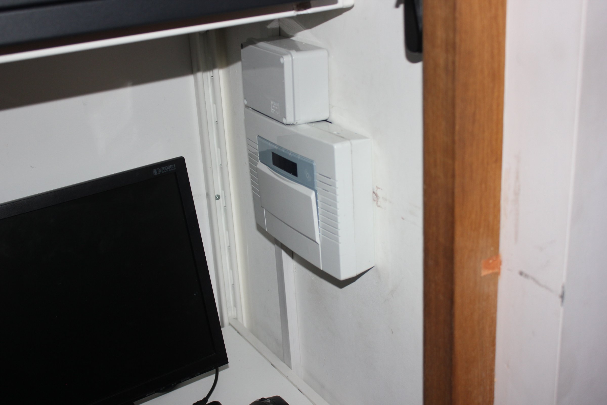

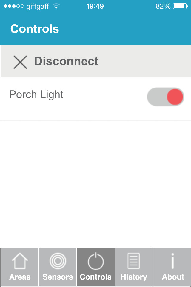

The Panel: The Pyronix Enforcer HomeControl+ panel along with a X10 powerflash module in the box above for controlling the X10 enabled porch light from the panel.

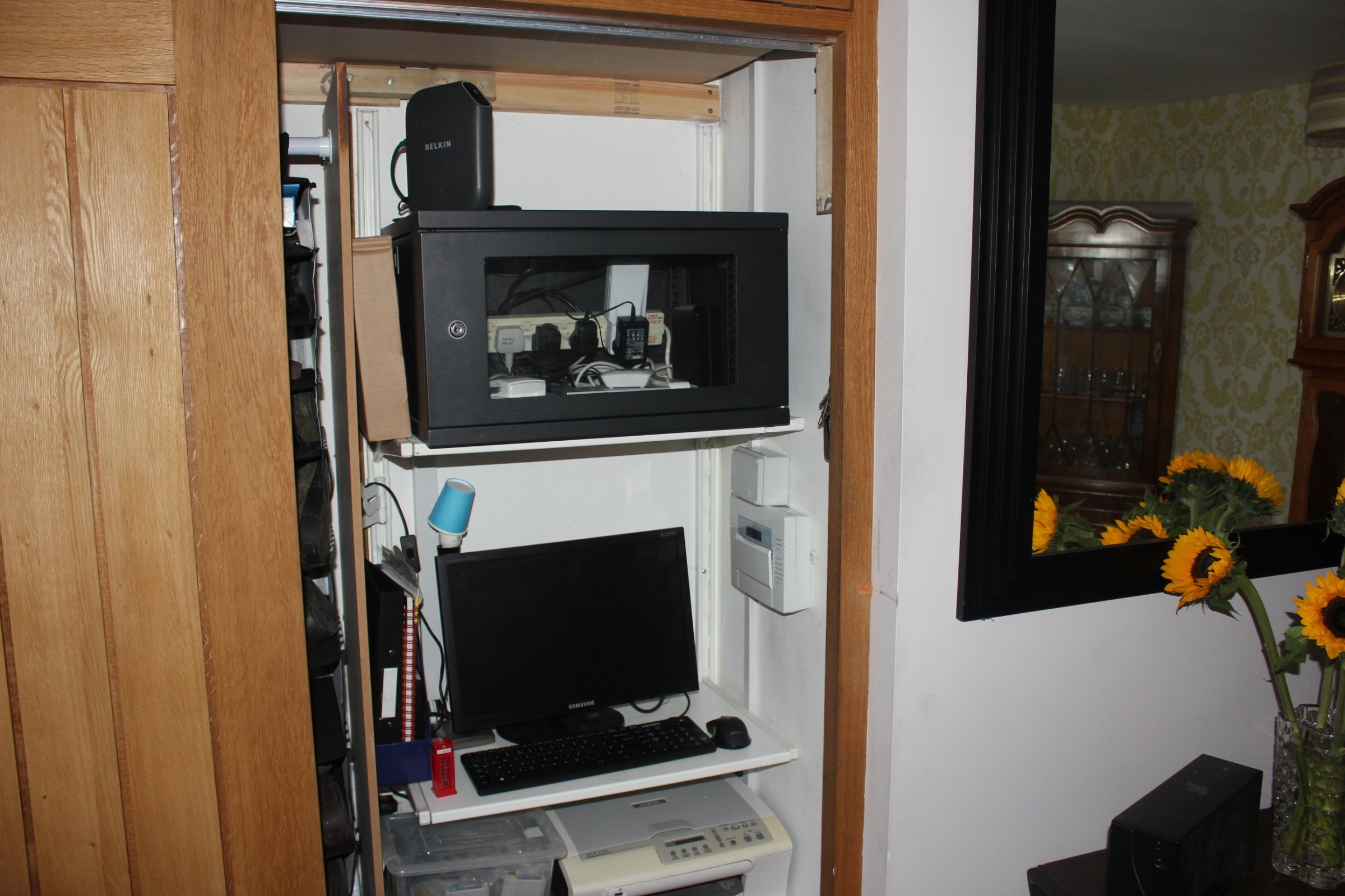

General view: General view of the cupboard where everything is located including the data cabinet for the Network/CCTV stuff. (Not shown is a 1500VA UPS for the 6U data cabinet.)

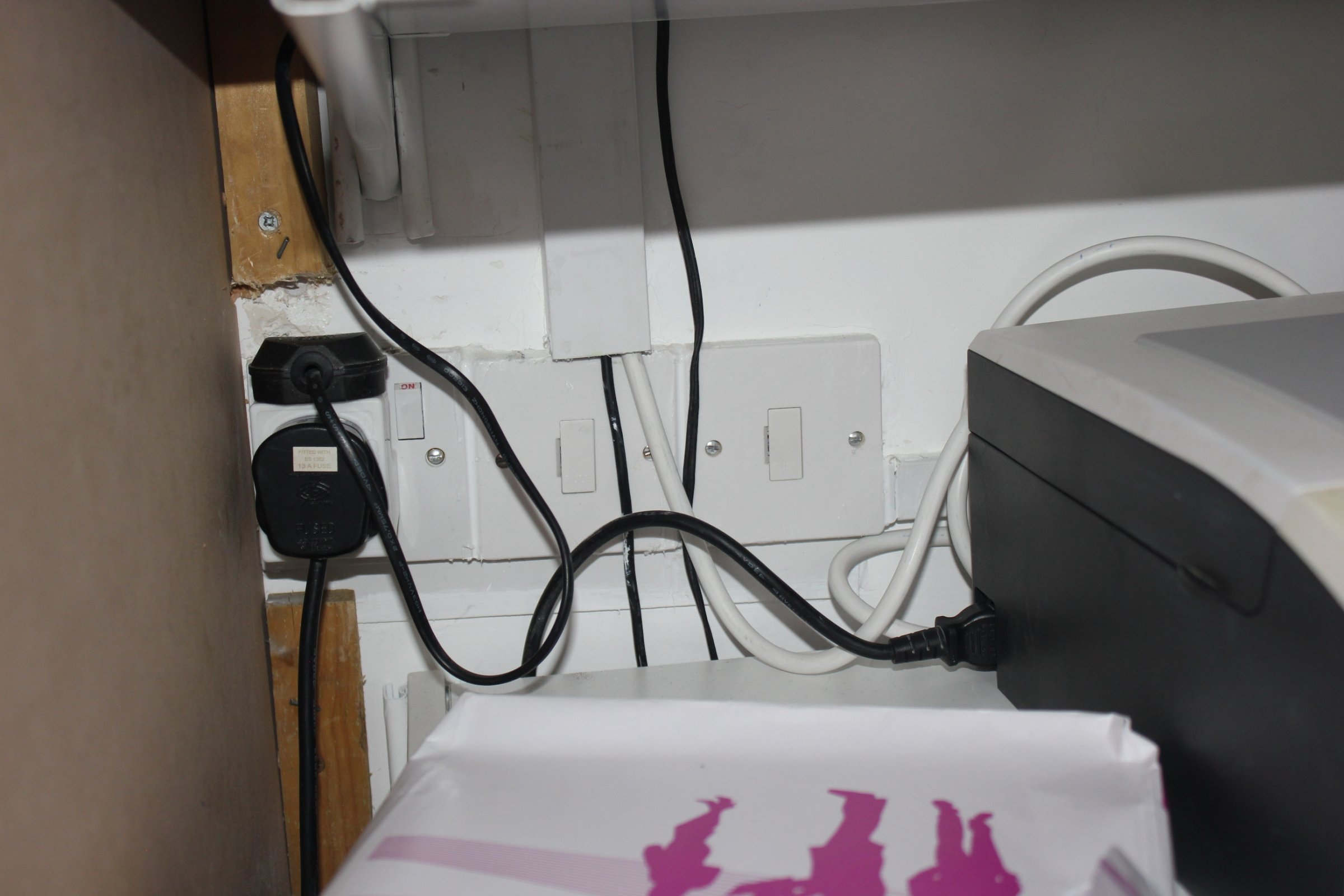

FCU's: Left = 13A Socket, Middle = Data Cabinet, Right = Intruder Alarm.
Data Cabinet: 6U Data Cabinet with a old 2006 Mac Mini running Webcam XP, plus two network switches (one POE for IP cam's, one Gigabit for high speed stuff), a NAS drive, a Printer server and a online energy monitor.

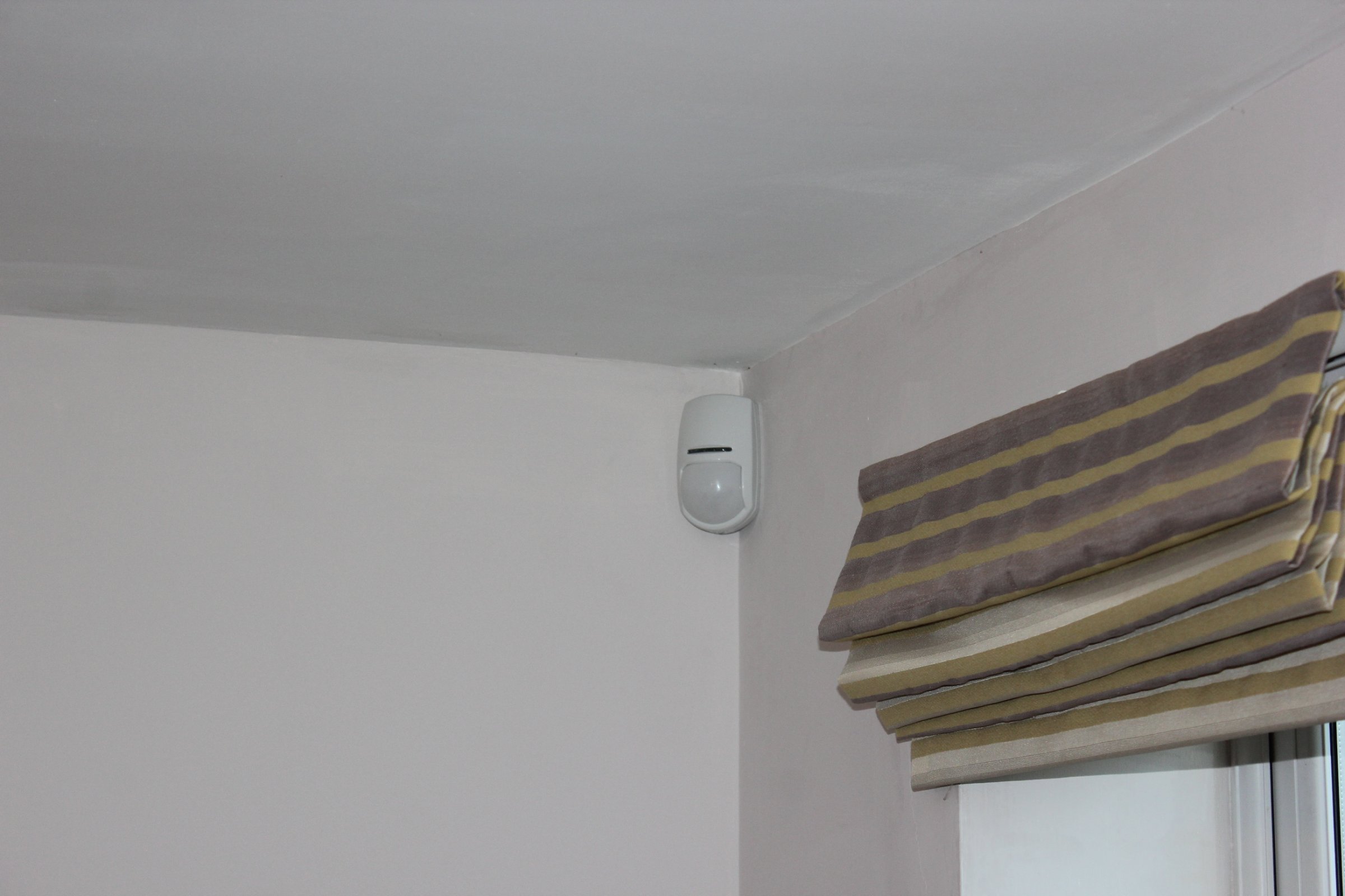

PIR: Just a look of 1 of the 6 PIR's installed. All have LED's disabled, Pet mask removed, and sensitivity set to high.

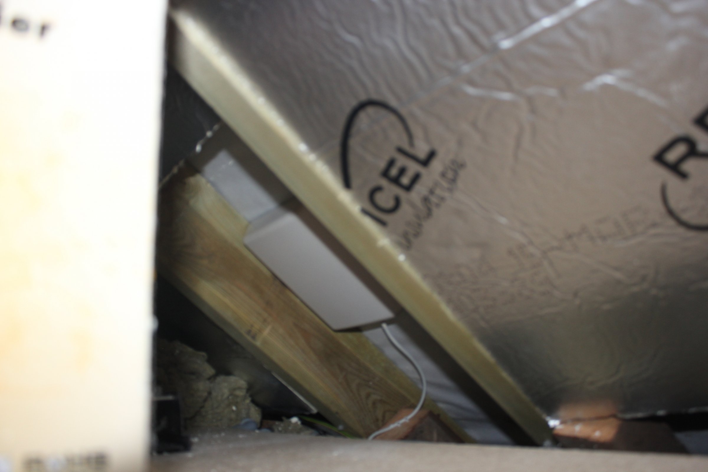

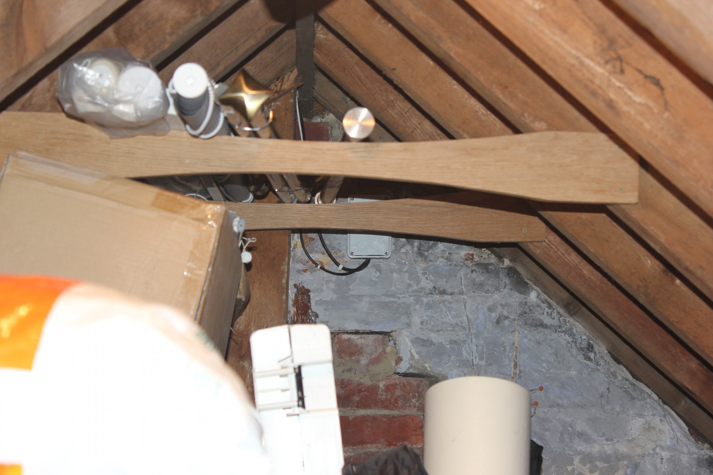

GPRS Antenna: I live in a poor GPRS coverage area, plus panel being in cupboard meant supplied antenna was 100% useless. Antenna is 15dBi GSM/3G type with MMCX connection, got from eBay with 5 meters cable. It is located in the loft space.

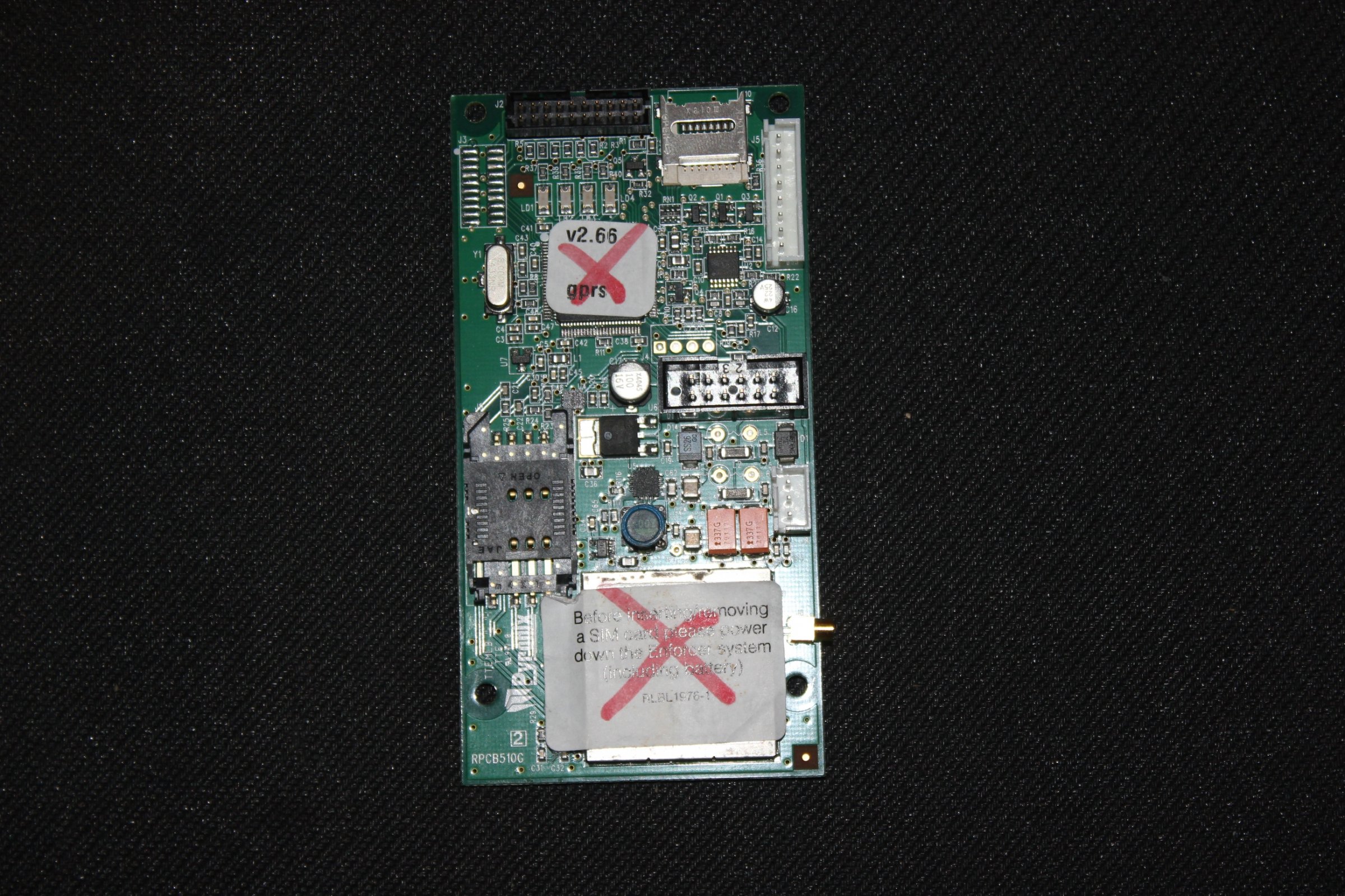

Incompatible GPRS Module: 2nd GPRS module with the wrong and incompatible software revision on it, (has v1.14 despite being labelled v2.66). 1st GPRS module was dead on arrival. So to sort this snag out took a bit of time to figure out and resolve.

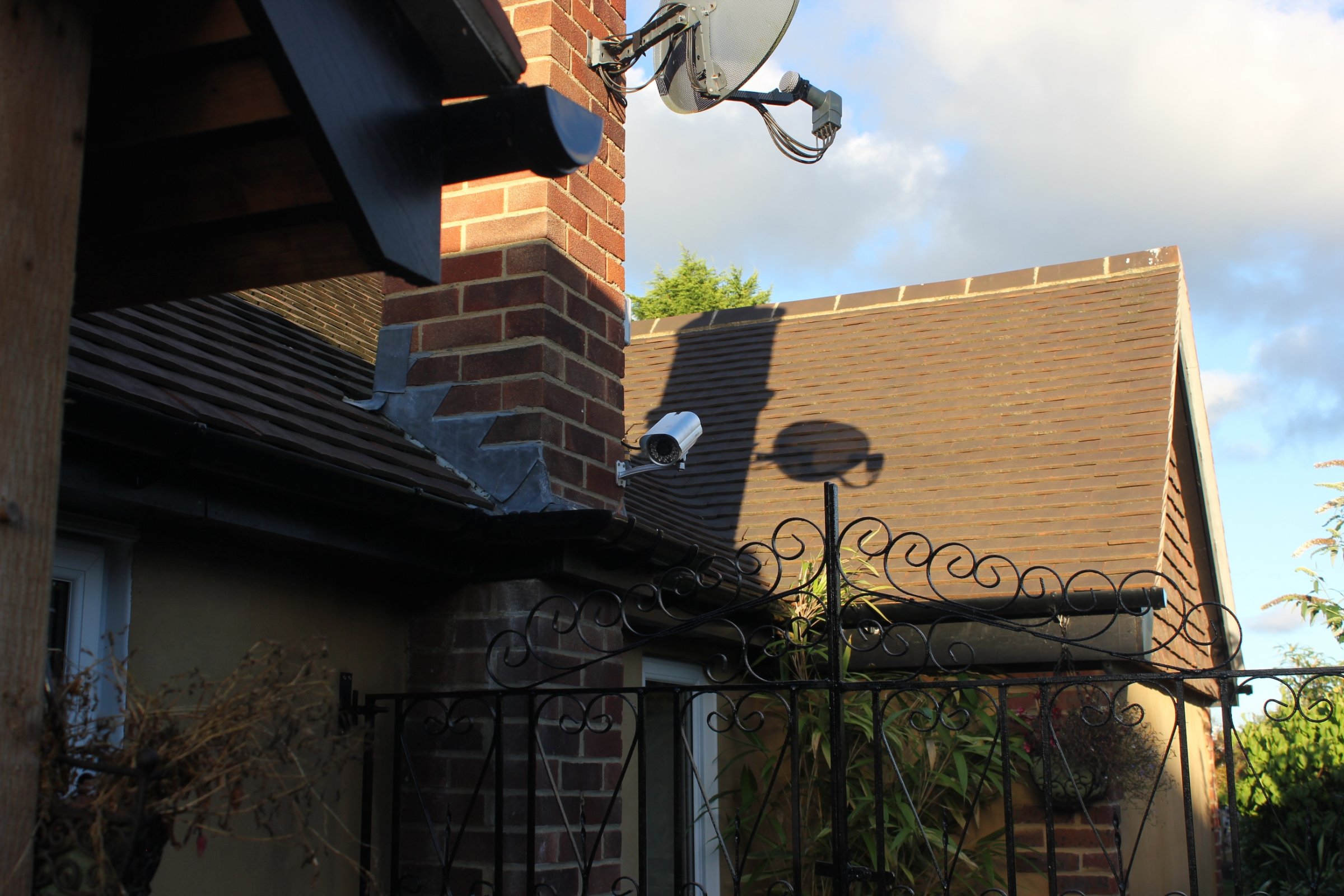

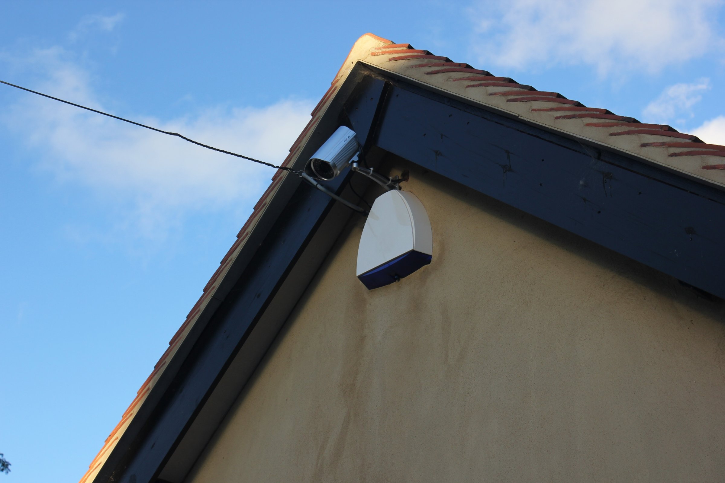

Bell Box and CCTV Camera: I ended up hard wiring the existing bell box (Reson 8 ) due to the wall is not rendered behind it and to eliminate the wireless constraints. Cam number 2 above bell box.

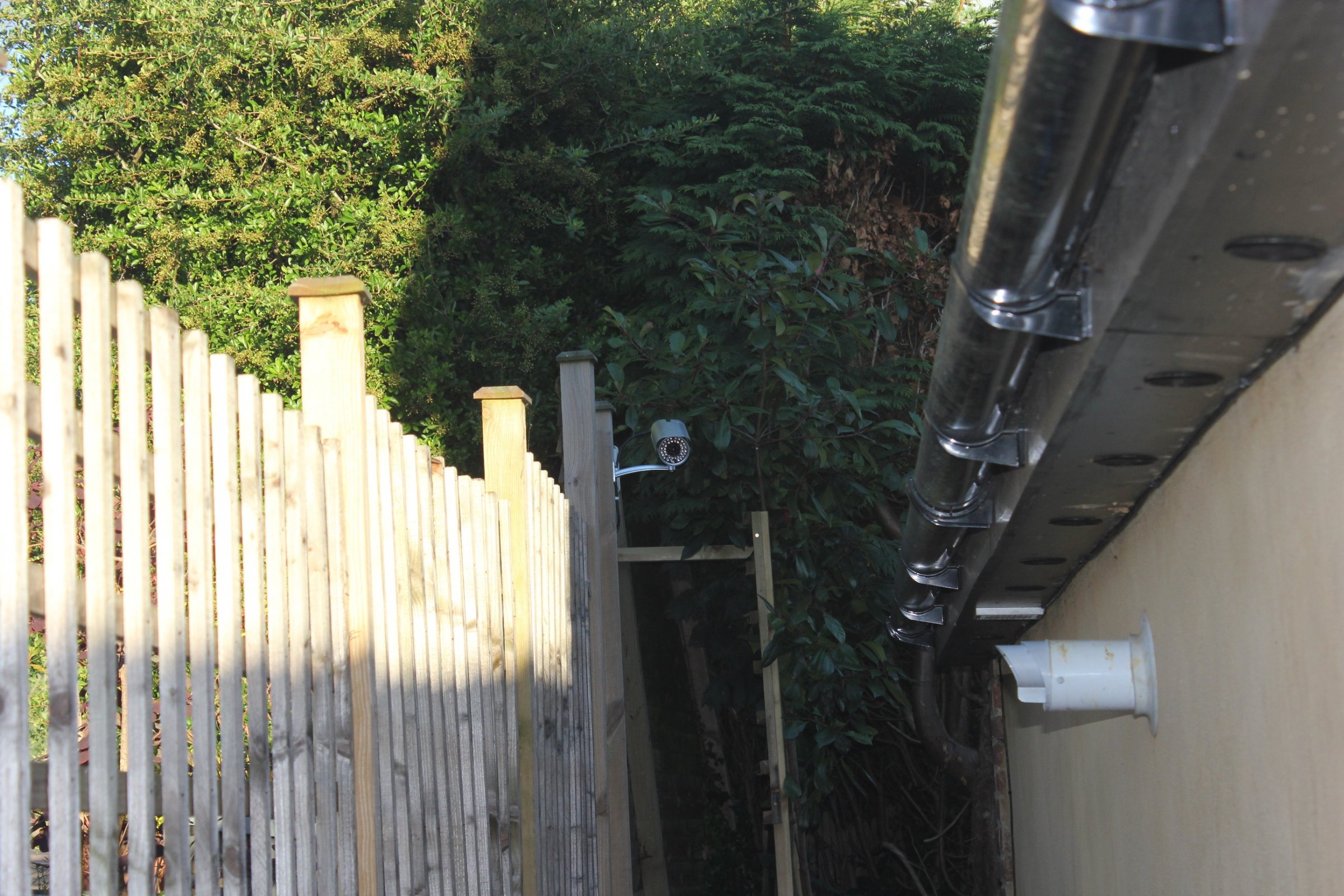

Side ally cam: Thought you could get in without being seen - Think again.

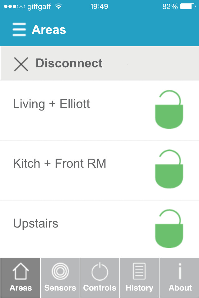

The iphone App: I have deliberately blanked out my Systems name after the word Disconnect.

1) It's very very cramped inside the panel:censored::mad:(n), so I would recommend for anyone wanting to make use of the wired inputs/outputs to get the "Enforcer Spacer".
2) Be careful as the plastic is delicate and easy to break. I ended up having to super glue the nuts at the bottom on top as the plastic what holds them in broke on me - mind you I was constantly opening it up when I was dealing with the GPRS issue.
3) I ideally wanted it wired to my Ethernet based LAN using the Digi-LAN module due to it being in a downstairs cupboard and getting poor mobile reception in general, but I could not source a place what sells the Digi-LAN module :(:cry:. Although it's to late now and the the Digi-GPRS is now working fine :D with my big antenna in the loft.

You can control (inc. Set, Unset, Part set, Checking system status, Check and control Automation outputs, and edit SMS telephone numbers) the panel through standard SMS messages and you can in theory program the panel via the computer using the UDL software what is downloadable pyronix's website - however their is currently no UDL software available for the UK Enforcer HomeControl+ panels.

Lastly, I have not looked into the cameras as I have my own independent set-up for them, although the Pyronix iPhone app does seem to pick them up using their P2P function on my network - although nothing displays as expected.

Interesting to note that two of your cameras are within range of an aerosol paint spray.
And the CCTV recordings are on a nice portable NAS ...
Cynical? Moi?
"and sensitivity set to high."
Don't complain about false activations then will you.

Only via the PGM output on the enforcer to the one X10 power flash module above it. For my main X10 control, I am using a CM11 module with Home seer on the mac mini server.

You can get an 16 way remote output expander board to make use of more than the 1 built in user programmable output. Any data it uses when not in use will be minute, I estimate it will use about 5MB of data a month.
I live in a bungalow so there was limited places I could mount them; plus even if they were high up, one could still cut a cable or break in wearing a balaclava.
Yes and also upload via FTP to my 1&1 hosted VPS server.
That is the default sensitivity the PIR's are set to and I have no false alarm yet...
