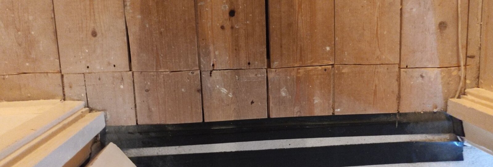

I need to replace the 18mm floorboards in my flat with plywood or OSB sheets, starting with the hall.
Most of the places where I'm cutting the floorboards to lift them it doesn't matter if the cut is straight, but where the new sheets are going to butt up against the floorboards from the adjacent rooms, the cut does need to be straight. As you can see from the attached photo, my attempt to cut a straight line with my multi-tool didn't go very well!
Would this Einhell cordless mini circular saw be a good tool to use for this job? I already have Einhell batteries so that's why I'm considering this one. https://www.amazon.co.uk/Einhell-Cordless-Circular-X-Change-Diameter/dp/B08C7STFVM
I won't be able to cut across the entire width of the hall with that, because the plate will hit the wall at each end, and the handle might get in the way a bit too, but I can just cut in both directions to get as close to the walls as possible. I think the plate will also probably hit the door frame and side wall and prevent me cutting next to them, so even if I can do most of it with the mini circular saw, I'll still have to use something else to cut about 5 inches at the top and 12 inches at the bottom, so what could I use for that and still keep a nice straight line?
I've got some of these old model Evolution rails which I'm not going to use now as I'm going to buy the improved new model kit. Would the Einhell cordless mini circular saw be compatible with them and if so, would it be worth cutting one of them down so I can use it to do these cuts across the hall? https://www.amazon.co.uk/Evolution-Power-Tools-ST2800-Circular/dp/B07HRDG2JG/

Don’t go too deep. You can set most mini plunge saws to a set depth.

Look alright to me - if you're going to put carpet down.
It's not about the appearance though. The line needs to be straight so the new sheet, which will have a straight edge, fits against the remaining floorboards.
Couldn’t you just mark out a straight line and follow that? Is it the exact same thickness?

I thought I'd be able to cut a straight line with my multi-tool but it seems harder than I thought to stop it wandering. Yeah, the floorboards are 18mm thick so I need to cut to that depth.
I'm having doubts about whether a mini circular saw would be suitable for this job now, as I read that they're only suitable for doing rip cuts into wood from the edge, not doing plunge cuts like this and it will kickback a lot if I try.
Does anyone make a mini plunge saw? I think a full-sized one would be far too big and unwieldy to use in this space.
my bosch 10.8v now called 12v is ideal for this job nail a batton to run against on waste side and run against
can get under cabinets at the plinths at 6" to cut 22mm boards[up to 25mm]

you will get attempted kickback all the time this will mostly be when the blade path when plunging is not in an exact path or arc causing odd grip and kick where the blade is fighting and unbalanced in the part cutting/gripping /pushing will constantly be changing whereas careful plunge against a batten both gives support and an accurate plunge path to follow
and by plunging i mean blade exposed to required depth and locked in place but short 0.2 to 0.3mm [about 21.3mm] and touching batton with the nose off the base only plunge cut against batton till blade fully plunged
