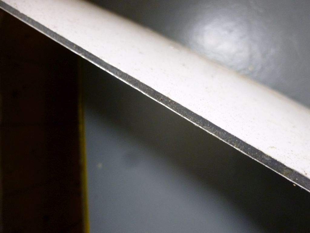

Best way to cut this material - Sign board
I'd expect about 30 quid per cut from my local place based on past experience - as a material it would probably cut at quite a high speed which brings the price down
Oh, it's not worth spending money on - it's just a reskin over a delaminating plywood faced, homemade workshop door.
Melted butter? Like melted plastic perhaps? :D
Edit: didn't see you'd cracked the same quip til I'd posted
Here's a 1.2m long cut in a dibond/composite sign material with a battery grinder and slitting disc. Dirty from lying in an outbuilding for a year, but a nice clean cut, not melted
