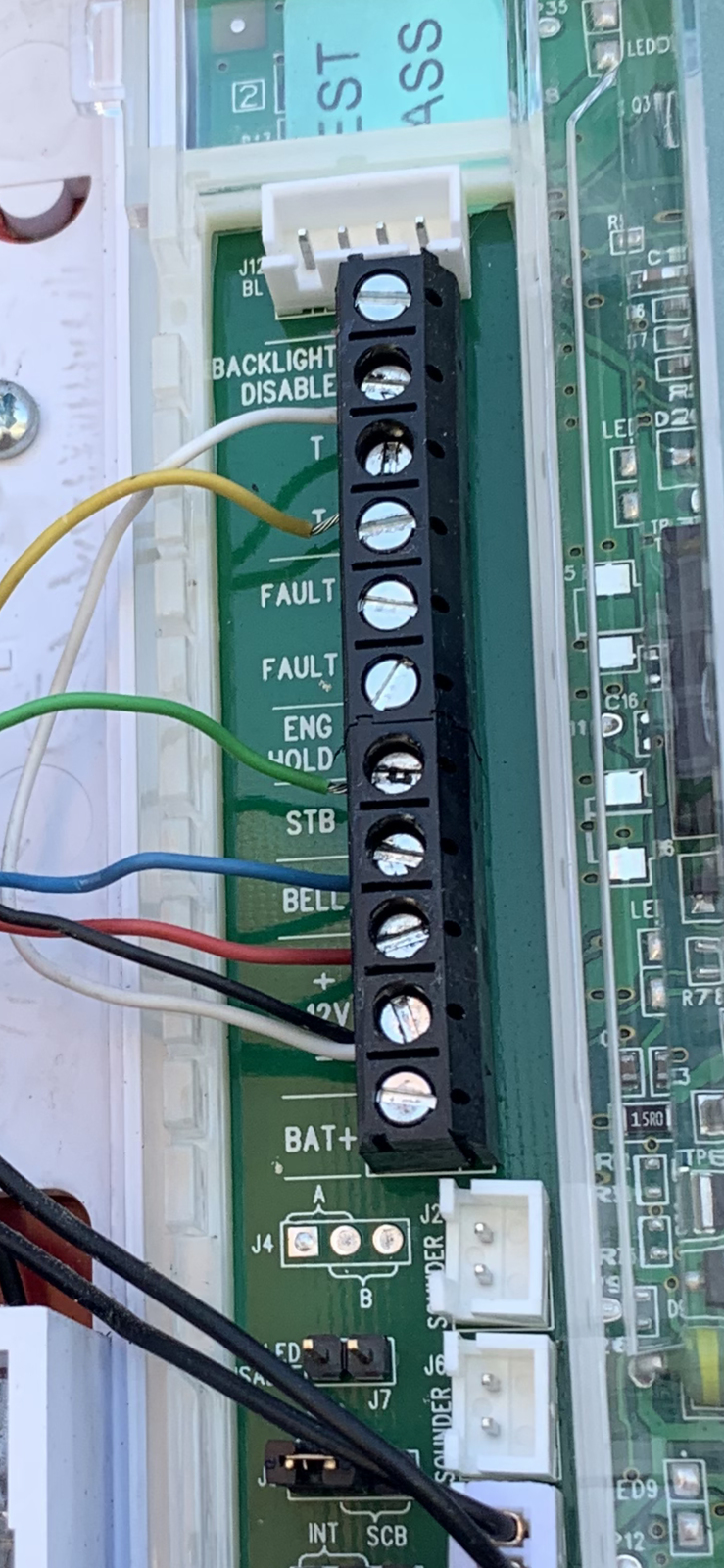

Actually I had a problem with tamper and now remember many moons ago I changed the tamper limit switch, and seem to remember the siren had 2 sounders in and could be unplugged, I’ll try and find a pic…
If so I could just unplug the sounders, remove cables? Seem to remember no battery inside it though, as in large battery, do newer bell boxes have smaller batteries in now, rather than the old style big rectangular ones?

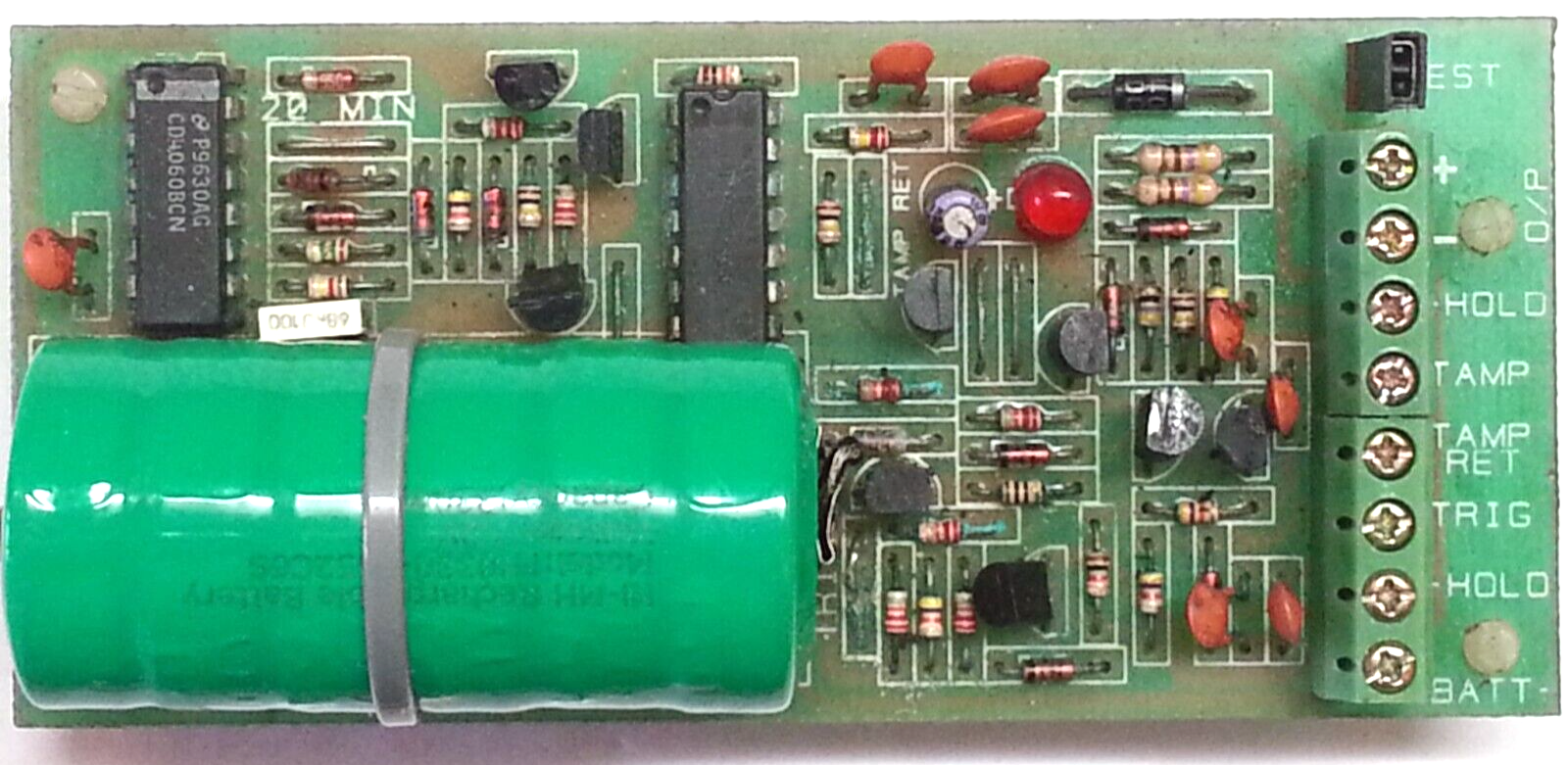

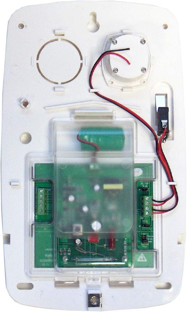

below are two different pcbs from two different bell boxes both have batteries, you only need to cut one of the wires red or black to stop the battery powering the bell, top pic you cant see the read cable coming out of the battery, the other you can see it but from the picture easier to cut the piezo wire possibly as it only has one, or flick open the plastic cover and pull out the battery connection

Best pic can find. Can’t see any battery inside it? Could the battery from the main panel be used for it?
The 2 white connectors, marked siren are where it has 2 sirens, that were unplugged at this time.
Move the bottom jumper pin to the right to disable the battery
From INT to EXT (pic was slightly cut off). What is this to do? Presume means internal and external - but what?
So no battery inside the bell box and the backup battery must be in the main panel? and this runs both the main panel backup and the bell box backup?
is this your bell box as the piezos aren't plugged in so wouldn't make any sound?
Yes put it on ext then the bell will not use its own internal battery there fore if control panel is powered down bell will be powered down too
So where is the battery in this? Is there a small battery somewhere on it?
So when set to EXT where is it using? The battery in the main panel?
Yes the eng hold off is not wired in in your pic so just whip it open and pull the 2 piezo connections off
Then swap the battery jumper then u are ok to remove the power without it sounding
