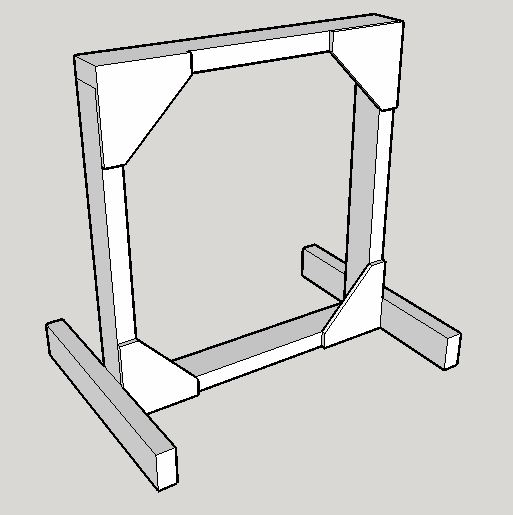

The Scheppach/Aldi ones aren't compatible with Festool/Makita/Hilti/Parkside/Titan/Triton tracks. Maybe not a disadvantage, but there are definite advantages to having 1400/1500mm rails (where two will allow a rip cut of an 8 x 4ft sheet) over 700mm ones (where three joints in a sheet rip size will be difficult to keep straight, especially after a bit of use). Take a look at Peter Millard's video series "Festool vs. Cheap Tool" on YouTube to get an idea about the Titan saw from Screwfix. It's actually surprisingly good, as is the LIDL Parkside saw. To make the most of it you will need to make-up some form of cutting bench - I use a couple of quick and dirty 4 x 2 or 3 x 2 softwood trestles like these:

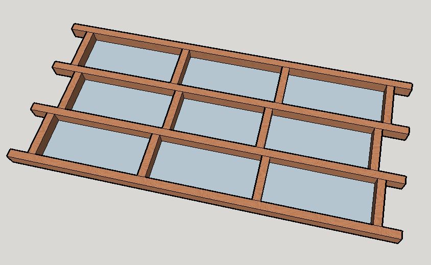

together with a few lengths of CLS to form a breaking down table which can be put away when not in use. When I do make-up a breaking down table top:
out of scrap or offcuts screwed together I aim for something like 7 x 3ft size. But TBH it isn't essential when 4 no 7 ft lengths of CLS will do almost as well
Thanks ever so much for that, JobAndKnock - it had not even occurred to me to actually make some cutting stands.
