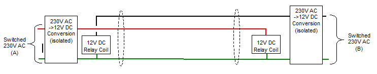

Bi-directional DC ELV Control Circuit via 3-core cable
Nor did I when I first contemplated the arrangement, but then I started thinking (perhaps too deeply?) about what current would (or would not!) be flowing in the common conductor. Time to 'conduct the experiment' to satisfy myself that my thought processes were being silly, I think!
Kind Regards, John

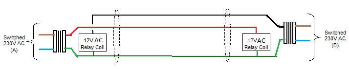

Peraonally if it was something I was doing I would produce 12 Volts AC at each end using small transformers, Either PCB mounted on StripBoard HERE
or a plug top unit ( with a wound transformer )
Peraonally if it was something I was doing I would produce 12 Volts AC at each end using small transformers, Either PCB mounted on StripBoard HERE or a plug top unit ( with a wound transformer )
The only difference between that and what I am actually doing would appear to be the use of 12V AC rather than 12V DC (which I've been using, 'one way around', for very many years).
Why would you do it with AC - just to save a rectifier and capacitor?
Kind Regards, John
I've just noticed that my previous diagram was a little misleading, since it implied that my 12V was not isolated from the mains voltage. It should have been something like ...
Kind Regards, John
