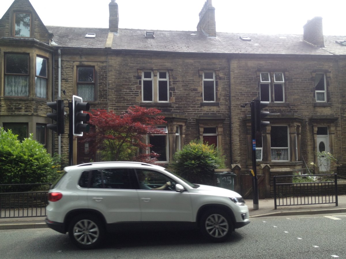

Big leak in attic around chimney stack
OP,
Perhaps you could warn your neighbour that the rain water pipe from his bay roof is a very bad design, and its possible for it to be blocked - maybe it already is semi plugged up?
Has your neighbour ever complained of leaks in his loft?
Taking a look at the way the Velux flashing is fitted Maybe he wasn't in his right mind?
Built later or earlier is fair comment. However its impossible to say the slates are original.
That aside water is going to pee through the stack ..
This pic will tell you more. I think the house on the left was added later than my house.
When i was up yesterday, my neighbours roof is in a bad way. Spoke to him today about it and he is going to come up with me when i tackle mine. I will do him a video because there is quite a lot wrong on his side.
datarebal - are you talking about my velux ? Why is water going to pee through the stack ? It has been fine for 12 yrs, now is giving problems. My first job is to do the chimney pots and i think this is the right way to go about it. Then check this parapet, then look at the soakers and flashing. The soakers and flashing for me is a bigger job. Worked with my mate on these before but not done one on my own. So a touch nervous tackling this job. Just hoping i don't need to do this area.

It will pee through because of gravity! the head of the stack is falling apart in your pictures... Not your velux, your neighbours. The back gutter isnt fitted correctly and there should be clearance at the rear (note the moss) basic stuff.
PS you wont retire on the sale of the pots.. mind you, I guess you could sell the flashings too? :)
I see, i understand what you mean about my neighbours velux. I think he is going to come up with me and try address some of his issues.
