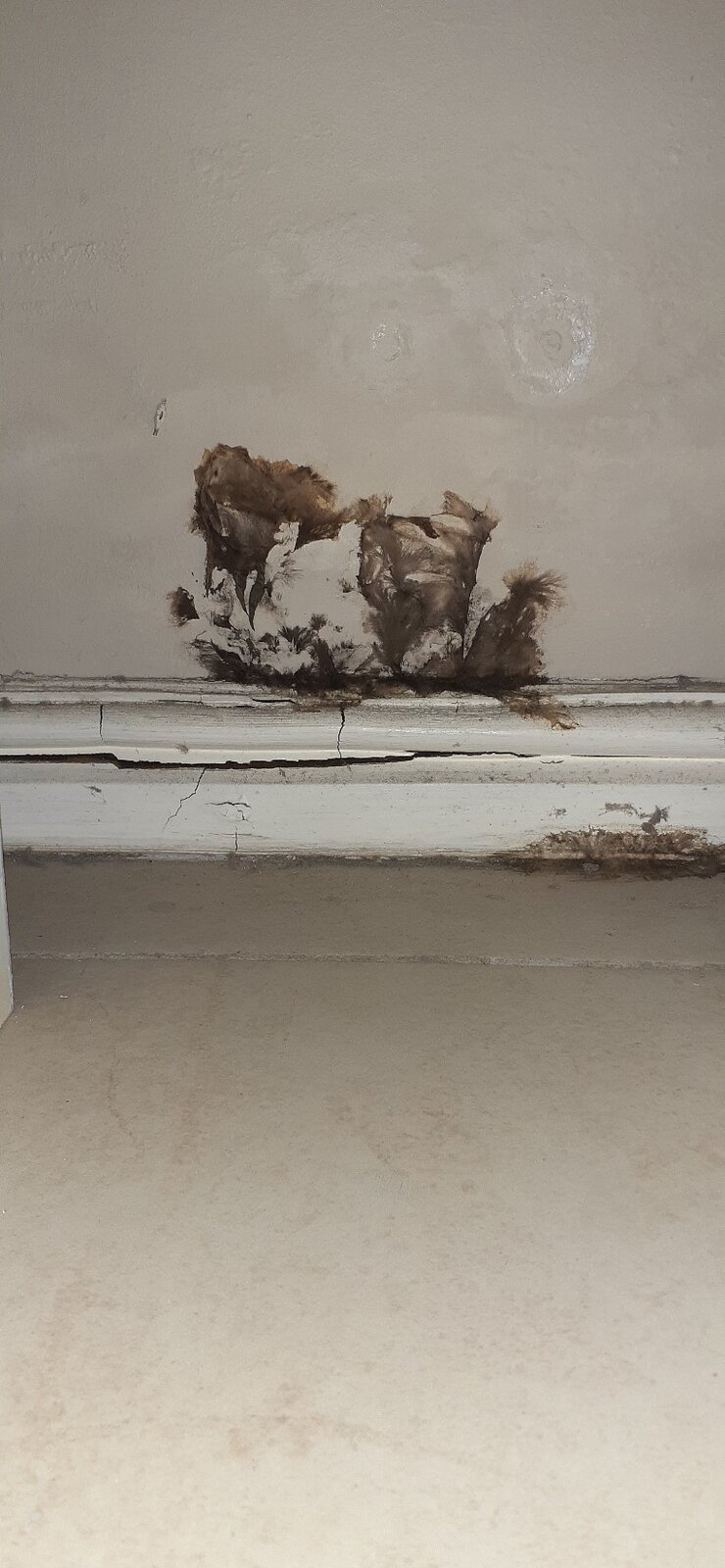

Hi there, was wondering if you ever found out what that substance was on the skirting board and what the cause was.
About a week ago I found something on my lower wall and skirting board that looks the same.
There is also a shower and toilet on the other side of the wall and absolutely no leaks.
Its really odd. One week the wall was clean and skirting undamaged. A week later this odd substance appears and skirting is split in multiple places.There was a box standing in front of it with a canvas painting.
Neither the box nor the painting has any damage.
The strange thing is the substance on the wall looks like animal and human faces....like yours.
I've attached a pic.

@GotGirl
Did you notice this thread is 3 years old? The OP may well not reply.
Your pic shows what could well be dry rot.
