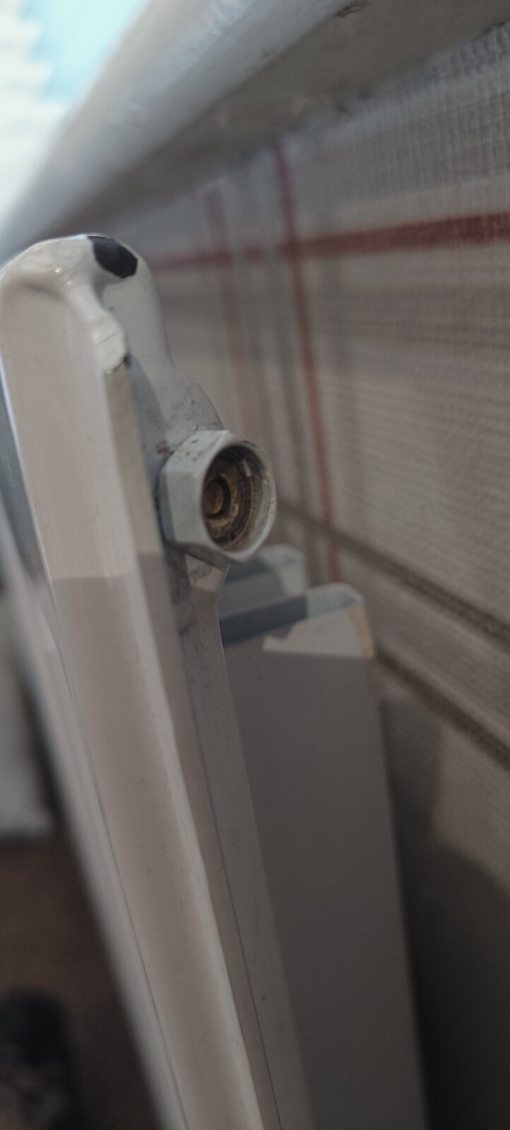

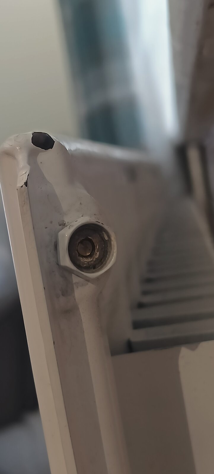

On One of my radiators, the bleed screw has snapped, it is different than the other in that it looks like it is replaceable, but want a second opinion.

All down to whether the fitting will come out of the tapping in the radiator without snapping. Wouldn't take the chance TBH, if it does then it''s a new rad.
You could use one of these, real easy to fit if your handy and have a battery gun.
Thanks, would get new rad but all my rada are the old imperial size and cannot find them anywhere, don't want to have to change pipework
You can get them they just aren't cheap -
