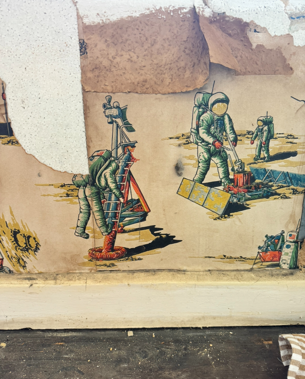

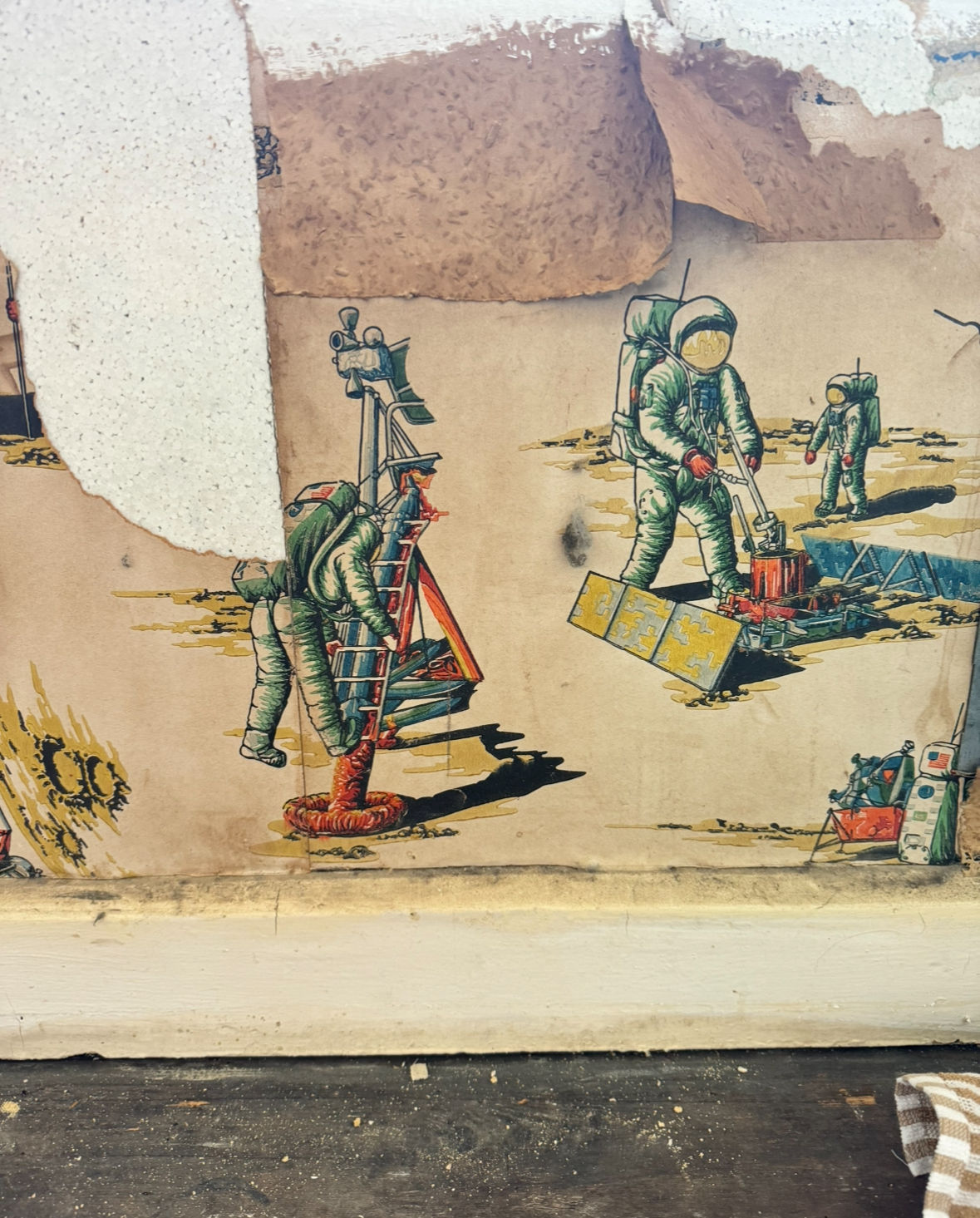

Cheers for the advice all! Managed to get it off in the end, pretty fiddly as there was basically zero play on the return end so had to get it clear of the flow pipe and take it off sideways. Check out what I found underneath!
