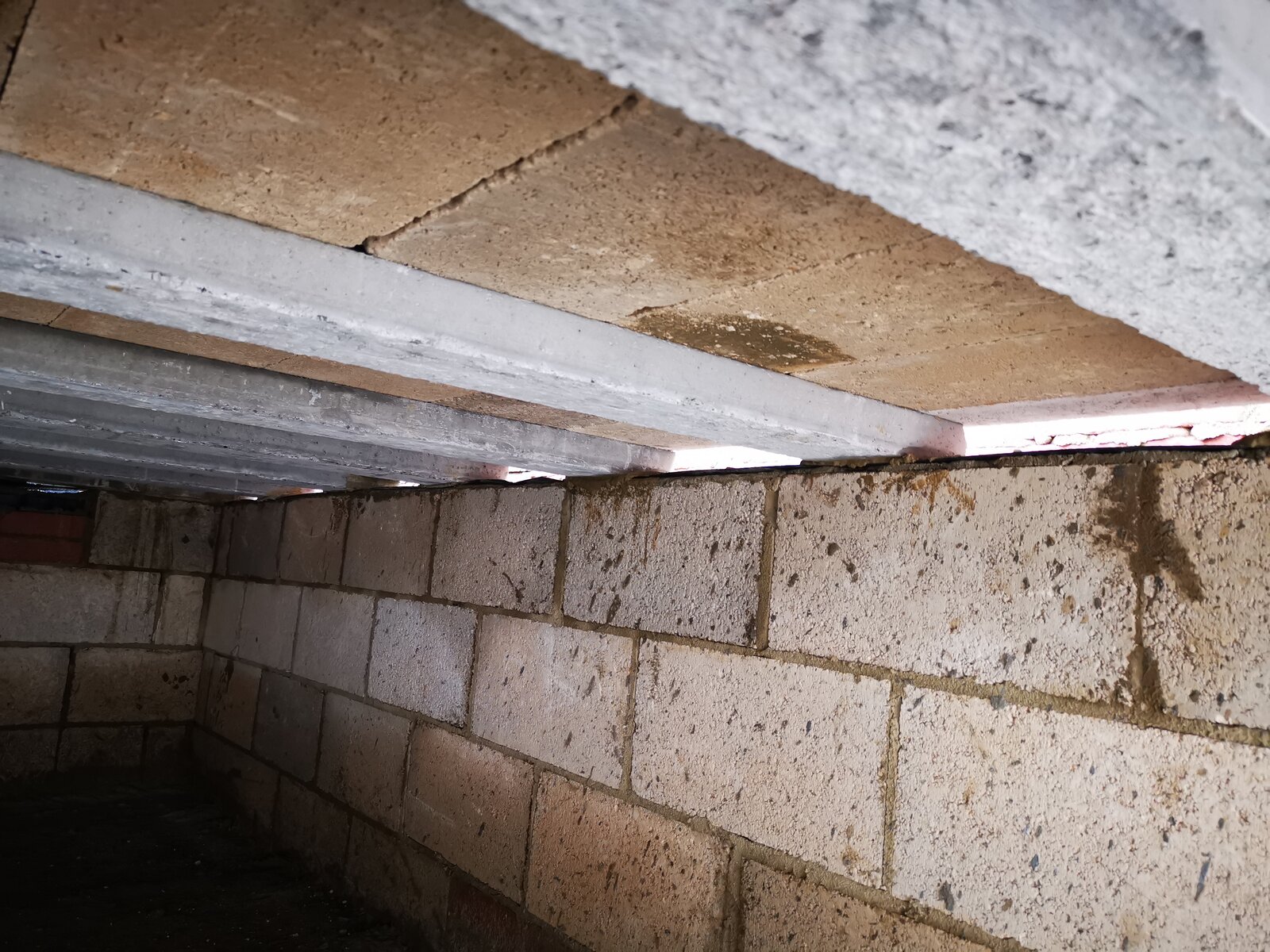

I think something is being lost in translation here. The block and beam by nature is acting as a lintel for the whole construction. We are referring to the edges of the beams which already sit on block work. It's not about support but about ventilation
This has nothing to do with ventilation, you have this:
img_20210930_133953-jpg.245509
But you should have this:
The ventilation goes below the block and beam floor using telescopic vents and lintels above, all gaps above should have slips in,and the beams are not lintels,every detail on the internet from manufacturers show this. Try and jump up and down on your beam floor and see if it bounces,it will.
How will a small slip brick with cement on the ends prevent a bounce in the beams.. Doubt it makes a difference from that perspective
Jesus, I don't know about lost in translation. It's just not getting through!
You have been told to get the manufacturer's guidance, FMT has even posted images as to what it should be built like, and yet you "doubt" that it will make a difference - ie you doubt the very people who have designed the thing!
Not doubting, how much weight can one dense 7N block sustain before it fractures?
Becsuse that same issue can happen to ANY of the other blocks along the span that don't have any support underneath. Thermalite blocks in the perimeter are not particularly heavy,
Why come on a forum to ask advice only to ignore it?
I ask a lot of questions naturally... Forum is for learning too no?

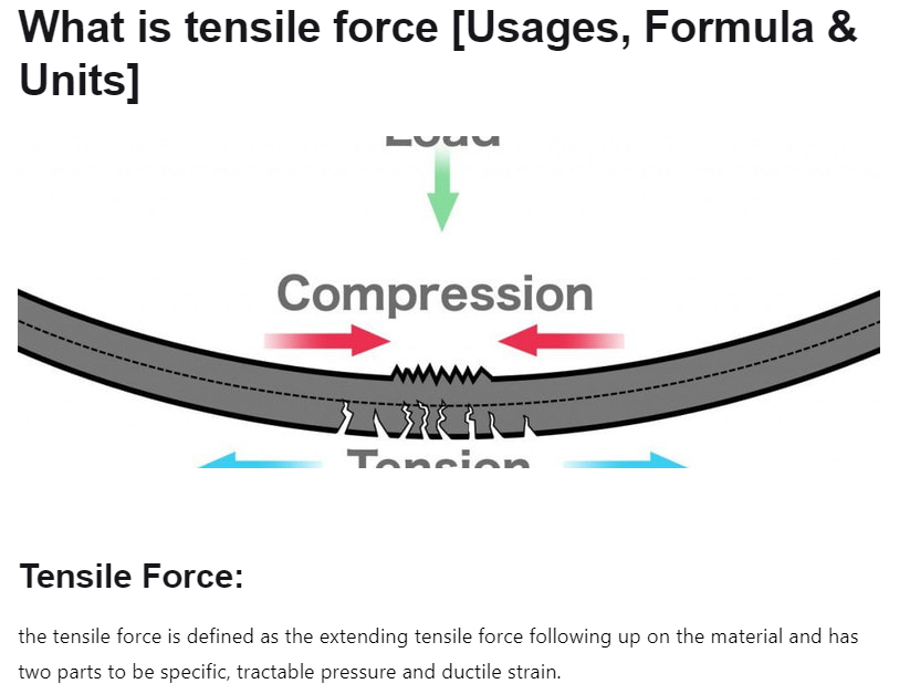

Also why should "tensile" strength matter in this instance when we are concerned about the forces from above. Nothing will be pulling a block along its length

For what it's worth I used your arguments with the builder and informed architect. They did end up filling those gaps (tho it was done to appease me but they still maintained its not vital)
I'm new to the forum and I'm sorry if coming across in a rude way. I do really appreciate your time and replies.
It's not our arguments you should be concerned about, its the manufacturers correct way to install,and any architect/BC ? who says otherwise is not fit to do the job,the cost and time to do it right is nothing on a job that size.
Might be a good idea for them to tell the hundreds of companies/LABC/NHBC etc who insist on slips,they can now do away with them, and what else will they not bother with as the build continues?

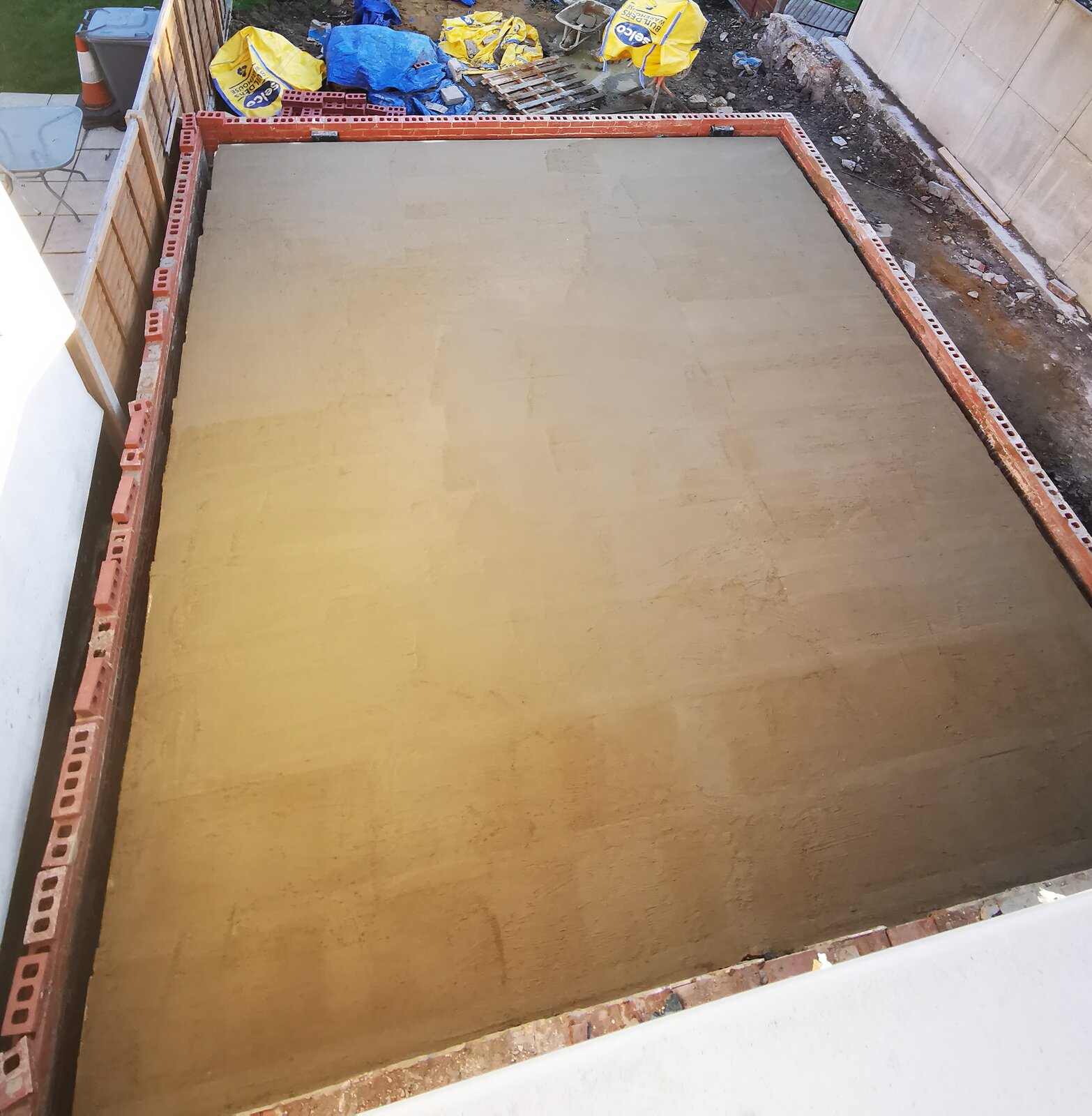

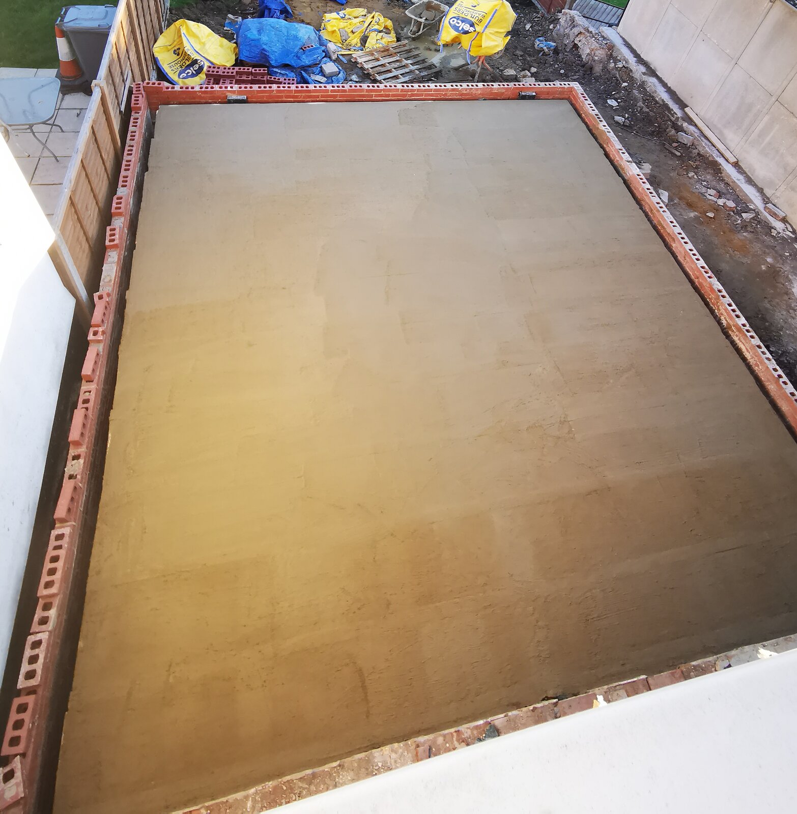

The building control lady is on leave until next week but... they ended up filling those end gaps
A layer of sand and cement on top as grout...
