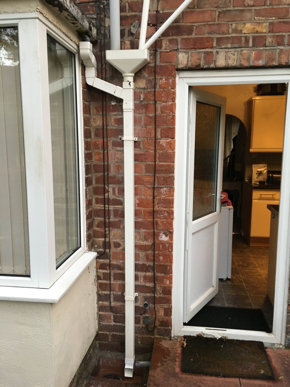

Noticed over the last week that sometimes the drains stink, and been putting plug hole unblocked down them but making no difference. Noticed tonight that it is the outside drain that is blocked. Hoping that with it only been happening the last week that it isn't too major a blockage, so want to get it cleared before it develops.
Could anybody recommend a product to pour down the drain, or any home made remedies?

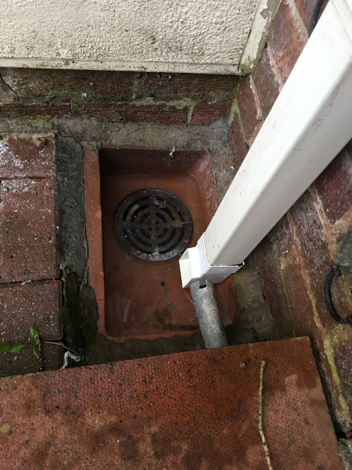

please photograph the drain you have in mind. Is it a gully? Does the sink drain into it? WC? Gutters?
Does anybody in the house allow cooking fat into the sink?
Is there a manhole nearby?
Are the drains made of brownish glazed clay ("pottery")? How old are they?

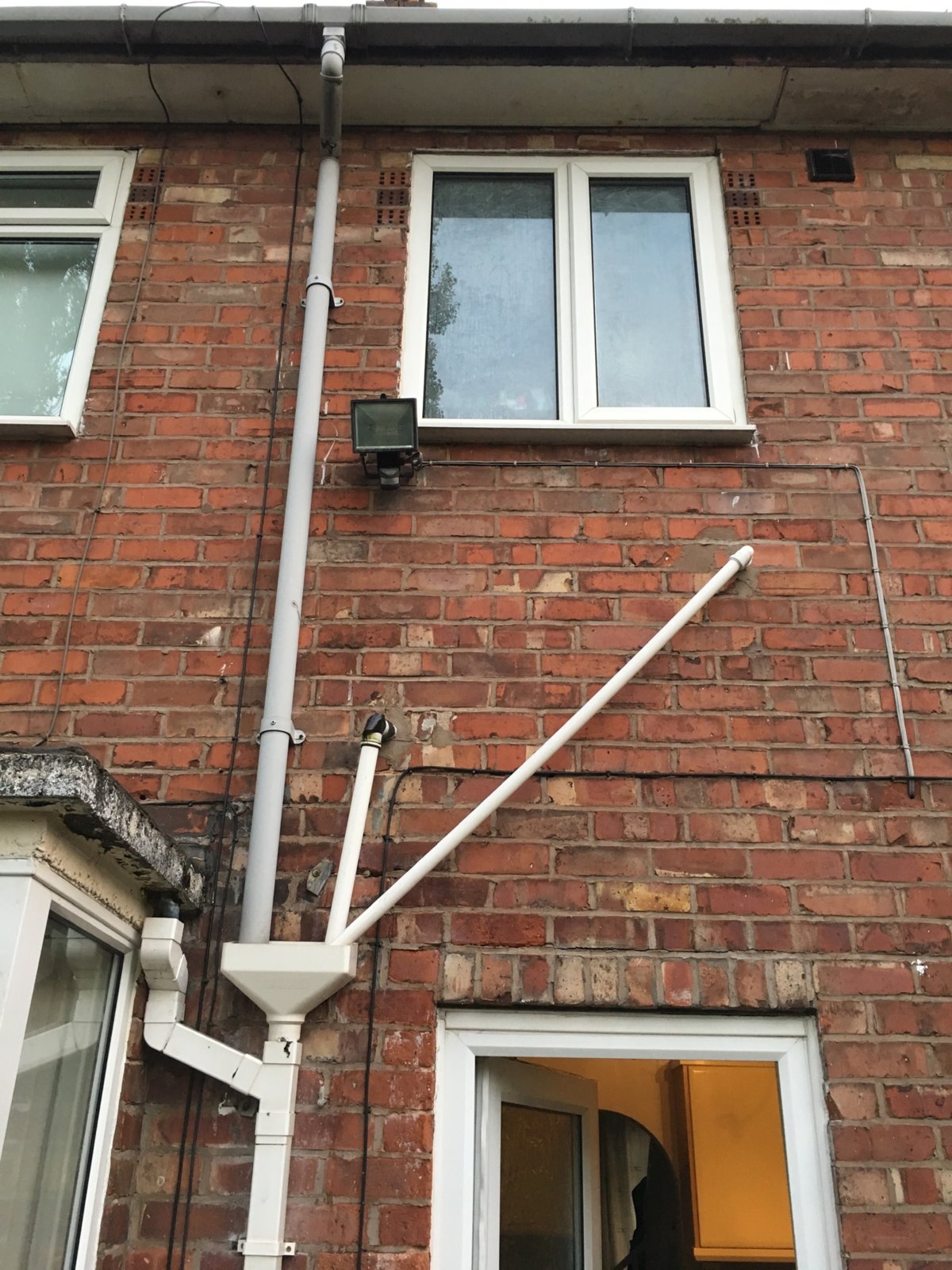

I'm at work at present, but can photograph later. The sink and Gutters drain into it, but has a cover over it so shouldn't be leaves. Only me and my girlfriend live there, but don't use too much fat - and that which we do use we usually pour into an empty jar rather than down the drain.
I've never really noticed the nearest manhole as this is the first drainage problem we've had since moving in 2 years ago - so, again, I will check manhole covers tonight.
The drain is a brownish clay - and the house was built in 60's. When I shoved my hand down it yesterday it went around 60cm down, then into a bend - but all was clear the length of my arm, obviously I couldn't tell anything beyond that.
It has drained a little quicker this morning, as last night I poured lots and lots of boiling water down it in case it was a build up of fat - but I'd still describe it as slow draining.

Photo of drains attached...

First thing I'd try is to remove the grid from the gulley, and using the plunder attachment on the end of a rod, (make sure it's on firmly and isn't going to come off), give the gulley a vigorous plunging, preferably with water running into it to wash away anything you disturb.
If this fails to clear it, then it's time to go manhole hunting, and it that's next door, and it's full, then the problem is downstream and it's time to call the Water company.
