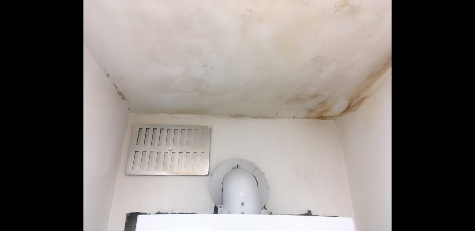

Just received this from a friend.
Vent was kept shut by tenants and boiler room filled with duvets and old clothes.
I think thats an adjustable vent - the face plate moves sideways to open or cover.
I it's on the top corner of the house no chimney. I am going to open lock pvc windows in room not used. I will use extracted fan in kitchen. I will check for condensation every few days and first sign of any the window will be opened in that room.
