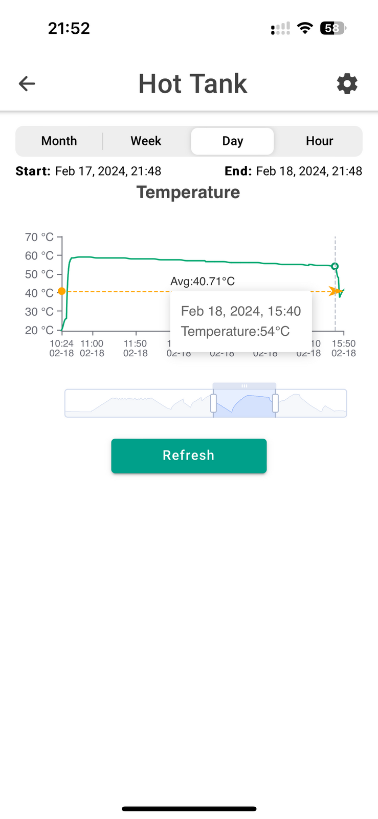

Yea, so I removed their temp probe today, turned the power off to the tank once it was up to temp and left it while I was out. Over almost 6hrs it lost 3.5 degrees, which given the thermostat pocket seems to be at the bottom of the tank, doesn’t seem too bad, so I am wondering if instead of the system leaking hot somewhere, it’s just the thermostat is too sensitive, as during that time it would normally have fired 4/5 times, which would roughly equate to every time I dropped a single degree….this is the thermostat - https://www.unventedcomponentseurop...GzOJeNeve9awYUd_6Cxb0CfOhD6Dtt7xoCOJMQAvD_BwE

I assume that is some sort of electronic cylinder stat? Not seen one like that before in the many unvented water heaters I've wired up. I wonder if it is programmed to cycle that way??

Just a query or two, can you confirm that the stat is a (Cotherm) GTLH3161? and how did you arrive at the 40.71C average?

Loving your data! Just to check, you hadn't turned off the flow of hot water from the cylinder this time? Why does the temperature of the cylinder shoot up so quickly from 20C to 60C right at the start?
How might this explain why the boiler didn't come on at all when previously you turned the flow from the cylinder off?
If you are right, though, and the fall is just 0.5C an hour, then it does sound to me like a dodgy thermostat. Which would be a great outcome!

Hi, yes it does appear to be that model! The average is just what the app the sensor is connected to shows, it’s not correct though as thats over 24hrs and the probe was only in for 6 hrs, so best ignored!
Ah the probe wasn’t inserted into anything before that, so that’s just the amident air temp. The flow of hot/cold was on during this time, so all was normal apart from the fact the cylinder had no power so couldn’t call for heat.
I am going to do the same test today but with the hot flow turned off, see what it loses then.

Below are the calcs on my 150L cylinder and the calcs based on your info above. Your losses, if not due to leakage, are quite high.

Thats great info, thankyou. So I am basically losing around triple what your 150L tank is losing in kWh and double in temp. The manual for the tank says that the standing heat loss for the 300L tank is 2.72kWh per day, so I am losing around 3x that based on the above.
Just waiting for the tank to come up to temp, then will see what I lose with the hot flow closed, try and rule in/out a leak.
