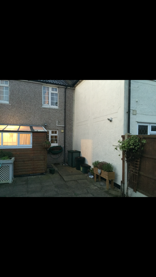

Hi we just purchasing a house and wish to put up a single storey extension but my neighbours boiler flue will stop this happening. It faces out onto our garden. Can any one advise on how we go about moving forward please also do we have the right to ask them to move it legally?

Thanks for your reply, I'm not sure if it was there when they moved in or not and I can understand if they are reluctant, but I'm hoping they will understand our view point. So legally it's not right? Even if it has been in years?
Is it within the over hang of their guttering? It's possible it might be just within their boundary and a flume divertor kit to direct it upwards might cover them.

But as soon as they build their extension, it will become non compliant as access for inspection and maintenance will be cut off
The paint on the back wall seems to show the boundary as being on the outer edge of the over hanging guttering. Looks like there maybe 6" or so that belongs to the neighbour even if it's inaccessible.
It is possible the boundary is away from the wall, the OP needs to check. Also, some boilers do not lend themselves to having a vertical chimney so that needs to be investigated too before it is taken for granted that the outlet can simply be diverted.

The wall was repainted this year by them and the bit on the back wall so I don't know who owns what yet? I'm getting conflicting things and don't know which way to turn so I have left a message with the council planning office to get to me. Hopefully they will.
