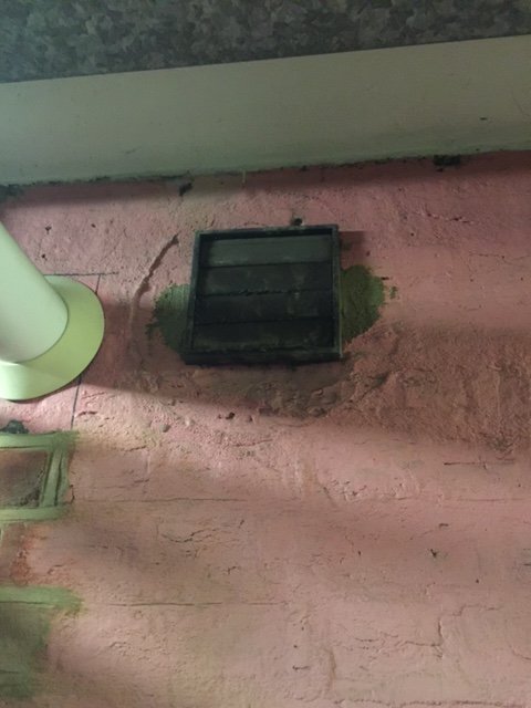

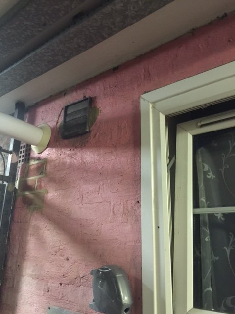

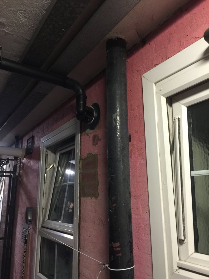

Pics attached (one showing both flues, mine and theirs, the others showing my window etc), I think given what everyone is saying about the type of flue being used, is that the work is above board? But like I said from what I read my fan and window is too close. I have no clue if these pics will help.

Unfortunately the kitchen can get up to 30+degrees c when not in use, and a lot hotter if using the oven so the window is opened when using the over/cooker. The window is beside their flue (as shown in the pics) but I don't know if this is an issue or not (either allowing the smell in or properly fitted). The fan is directly beside their flue. And obviously when the fan isn't in use its just and open vent allowing air flow in and out.

I think I'm possibly going to have to defer to you Sooey, but I suspect this might end up being an arguable point. Does the wind flap covering the extractor outlet technically make it an opening in the same say as an airbrick would be. If it is classed as an opening, then the flue should be a minimum of 300mm away from it, but I reckon it's the window being open that's the cause of the smell coming in, and when closed, the smells stop. I also think that because the flue exits onto a common walkway, it should be 2.1M high, as is the black one in the third pic.

You say their flue is 100 mm from your fan and 140 mm from your flue, both too close but where does that leave your flue from your fan?
It does have a cover that diverts the fumes and condensation away from the properties, horizontal to mine, over the balcony.

Just posted pics. Not sure if it helps because there's no perspective to the pics. Will have to take measurement to be 100% on distance between my flue and fan. My flue is beside my window too but on the other side from theirs. In the pics, there's is the one of the left.

Their airbrick is the other side of their flue. Which is def less than 300mm (you can see it in the pics). My window has to be opened when cooking though and the window has built in vents for air circulation. Even with the window closed air is coming in from outside though minimal and yes likely arguable.

It definitely look as though the installs suspect, both for you, and the neighbor, and it might be worth contacting Gas Safe register to check the jobs been done properly. Does the flue extend as far as yours does, as yours is closer than 300mm to your window as well; so I have to assume that the length of your black piping takes it far enough away to become legal. And as you're flat doesn't have problems when your boilers on, I reckon the wind blows from the neighbors side.

Essentially an extract fan is an opening in the fabric of the building so in my opinion it should be 300mm minimum to your neighbors flue.
As Doggit says, you could call Gas Safe to come out and comment on, but it looks as though your flue is too close to your window as well. Even though yours is fitted with a plume management kit, it still needs to be 300mm from any openings.
It doesn't look great, you don't show us how long that flue is but you said it was dripping condensate to the car park below (which is also wrong), so the terminal is well away from any openings.

Unless anything has changed there is a disagreement between Gas Safe over the permissible distance to openings from an inlet point of a plume management system like your black one.
Most makers think that 150 mm is adequate for the air intake point whereas Gas Safe used to take the view that it should be 300 mm like any standard flue terminal.
Yes both flues/pipes are the same length and extend out over the balcony but as someone else pointed out they shouldn't drip but do, and onto the general walkway and carpark. They're more than 2.1 M off the ground. Called gas safety but no luck. They don't get involved unless there's an official complaint to the company who did the install, which is fair enough. But I don't know who did it and the housing association and neighbour seem to be tight lipped over anything and everything. The alternative is GS send out a letter to the neighbour requesting entry and inspector BUT expressing that I've complained. I'm not about to go down that route, they're not the friendliest of people.
