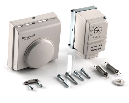

Basically the frost thermostat should by-pass the heating time control and the room thermostat, thus directly controlling the motorised valve. The motorised valve will then operate the boiler as it does in normal operation.
The Frost thermostat should ideally be wired in series with a pipe thermostat set at about 30 degrees C on the return pipe to the boiler. This keeps the pipes warm to stop freezing but also stops the property from overheating. You don't mention whether you have a pipe stat or not, but they usually come as a kit.
Purchased many frost stats coupled with pipe stats over the last 35 of years, I’m not aware that these were/are sold as a kit?

There is the frost stat on my boiler but definately not a pipe stat.
As mentioned before there should be a pipe stat clipped to the boiler RETURN pipe...this will shut off the boiler once the return water is at a sufficient temperature.

Thank you, there is a mass of pipework, valves and pump in the airing cupboard, presumably a bypass too as when boiler is working normally everything is fine it's only when frost stat kicks in there's a problem. Although doing what stem said and manually opening heating valve before I manually activated the frost stat, cured the problem.
So I need to find why when the frost stat operates there is no flow.
Is there any other tests I may be able to do to narrow it down?
Thought I'd do a follow up post.
I removed the Taconova setter bypass thinking that could be the only problem, and it was totally blocked of crud allowing no flow through it whatsoever..
Cleaned it all out, reinstalled and all working perfectly again.
