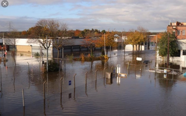

Iv Googled it! Yes that’s definitely what it looks like so by slow releasing the acidity into the ground could this do damage to a building if it’s close to the wall over time? Or like you said with it been so minimal is that not an option and maybe there flood downstairs was purely just from the floods last week also I would like to add we are on a water plane with a stream running though the gardens so purely a flood is possible and it’s just saturated and gone into their flat though the concrete flooring.

Thankyou I know it’s got to be from the floods last Friday but I wanted advise incase anyone started saying it’s that! But it’s been there three years so far and done no harm so I can’t see it being the soakaway.

Yeh I’m sure that it’s not this was here before we moved in and for how long I do not know. I’m worried now that it’s caused damage to their property aiding the flood the other day. I only found this pipe on Sunday when I went down to have a look.

Stop worrying.
Torrential rain the suspected cause.
No mention of boiler condensate pipes.
