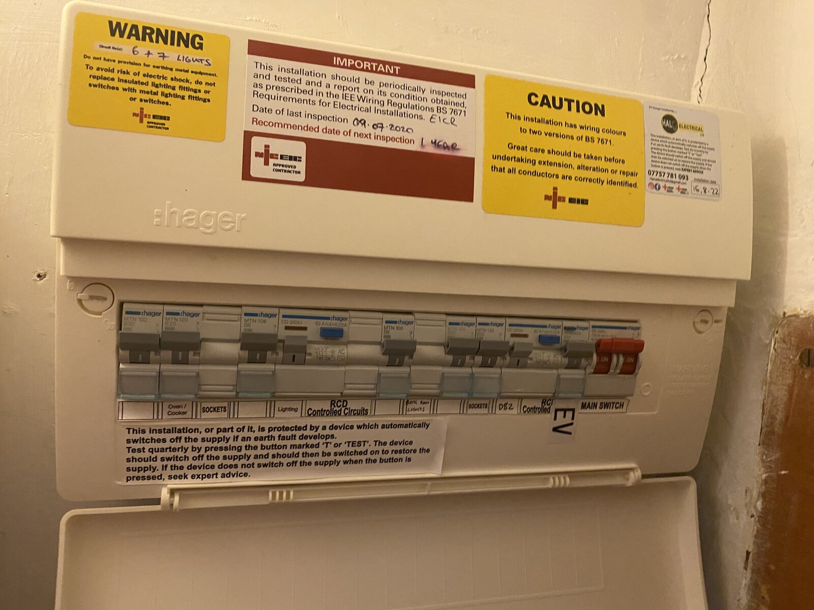

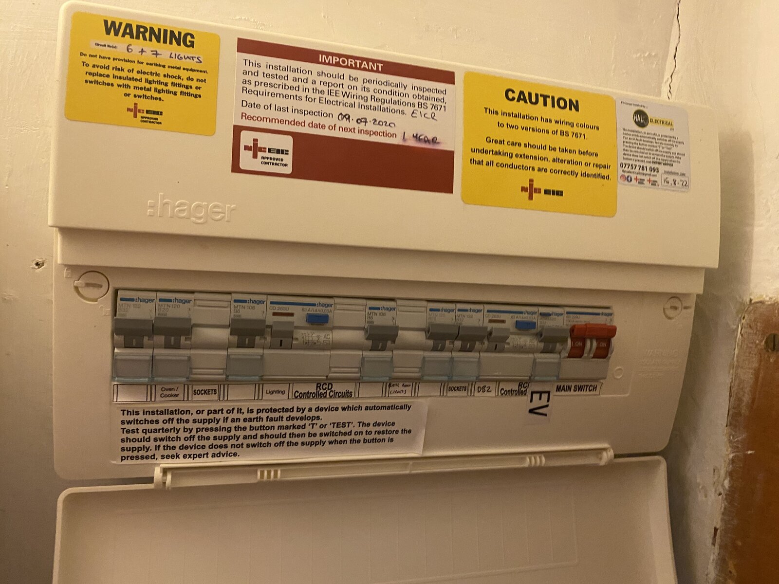

First thing, have a look at your consumer unit(s) (take a pic and share it here if you don't know what you're looking for).
Second, if you are creating an ensuite presumably there will be new cabling for lights etc?- any NEW cabling, lights, sockets must be RCD protected now.

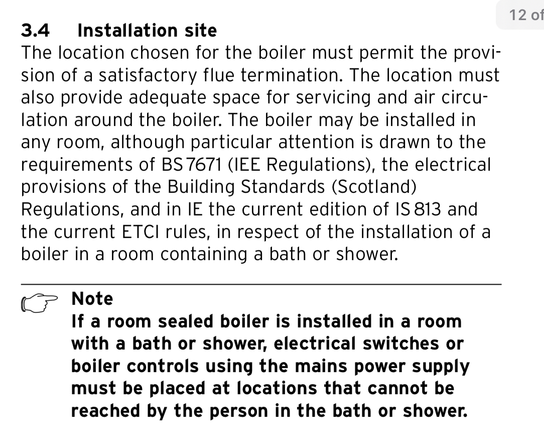

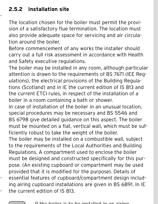

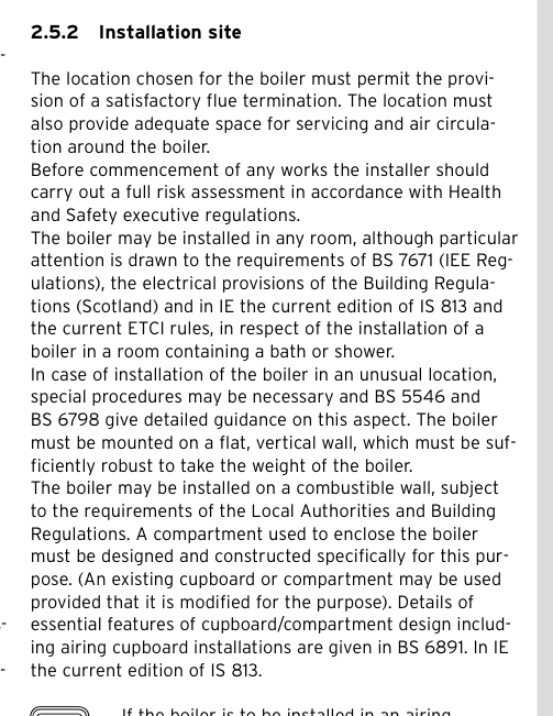

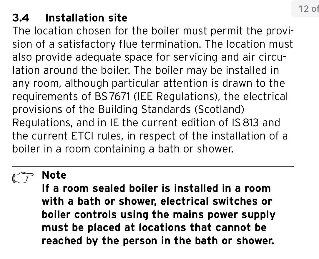

Slightly conflicting information from the 2006 EcoTEC manual to the approx 2012 manual - the latter stating refer to BS7671 electrical wiring regulations.

Picture attached.
I had a new boiler installed in a shower room, it was about 2m away from shower and 1m away form sink basin, still passed regs.
Recently I presume? Is the circuit covered by an RCD, if it isn't, then I may be wrong but I don't believe it should have.
Think the 'new cabling etc must be RCD protected' change was about 18 months ago. There are requirements for earth bonding in bathrooms where supplies are not RCD protected which can get complex.
