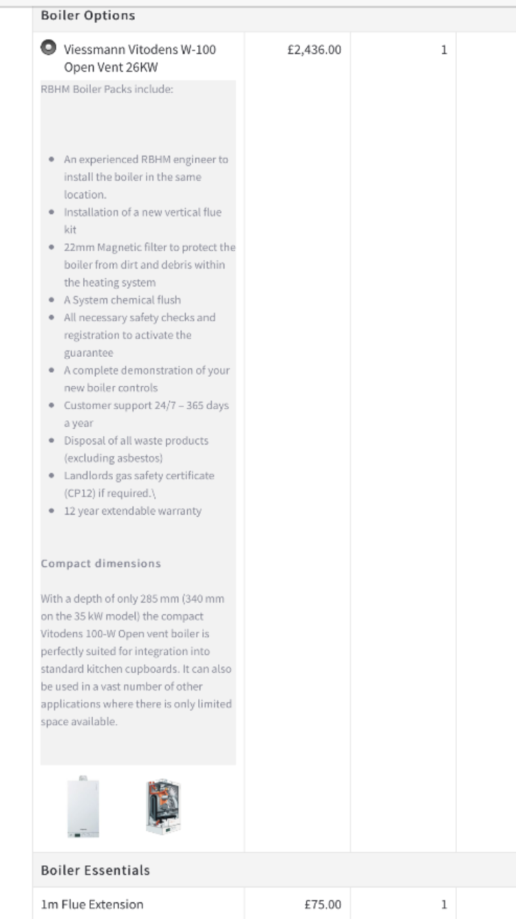

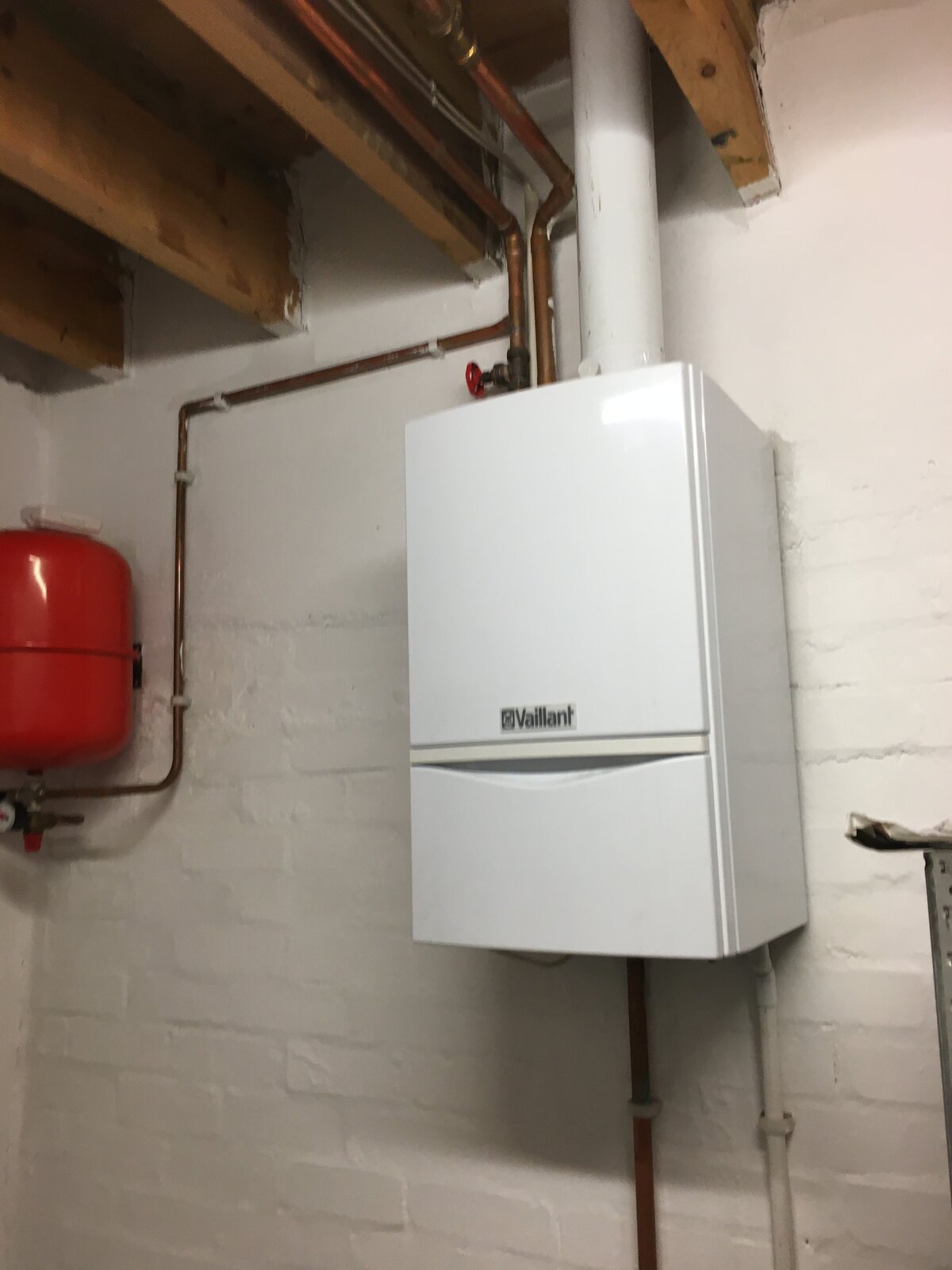

Hi all I’m looking to replace my valiant regular boiler which is not very reliable with veismann 100w boiler I have a quote of £2400 considering the boiler cost is 1k that means £1.4k install price does that seem too high? It seems like a straight swap no other plumbing to do etc, also comes with 12 year parts and labour warranty. I live in London just wondering if the price is too high any help/ advice would be great thanks
does not include power flush is that needed?
Get more quotes . They are free . I personally wouldn’t fit a new boiler on a dirty system but hey ho
Is it to much if you trust the guy to do a decent job.
Break the cost down over 12 years, is it expensive when compared to paying out for boiler insurance over the course of the year that you may or may not use?
It is doubtful that if the boiler is looked after well that you will have any problems over the next 12 years, that's why the manufacturer offers that length of warranty.
Is it as straight a swap as you think?

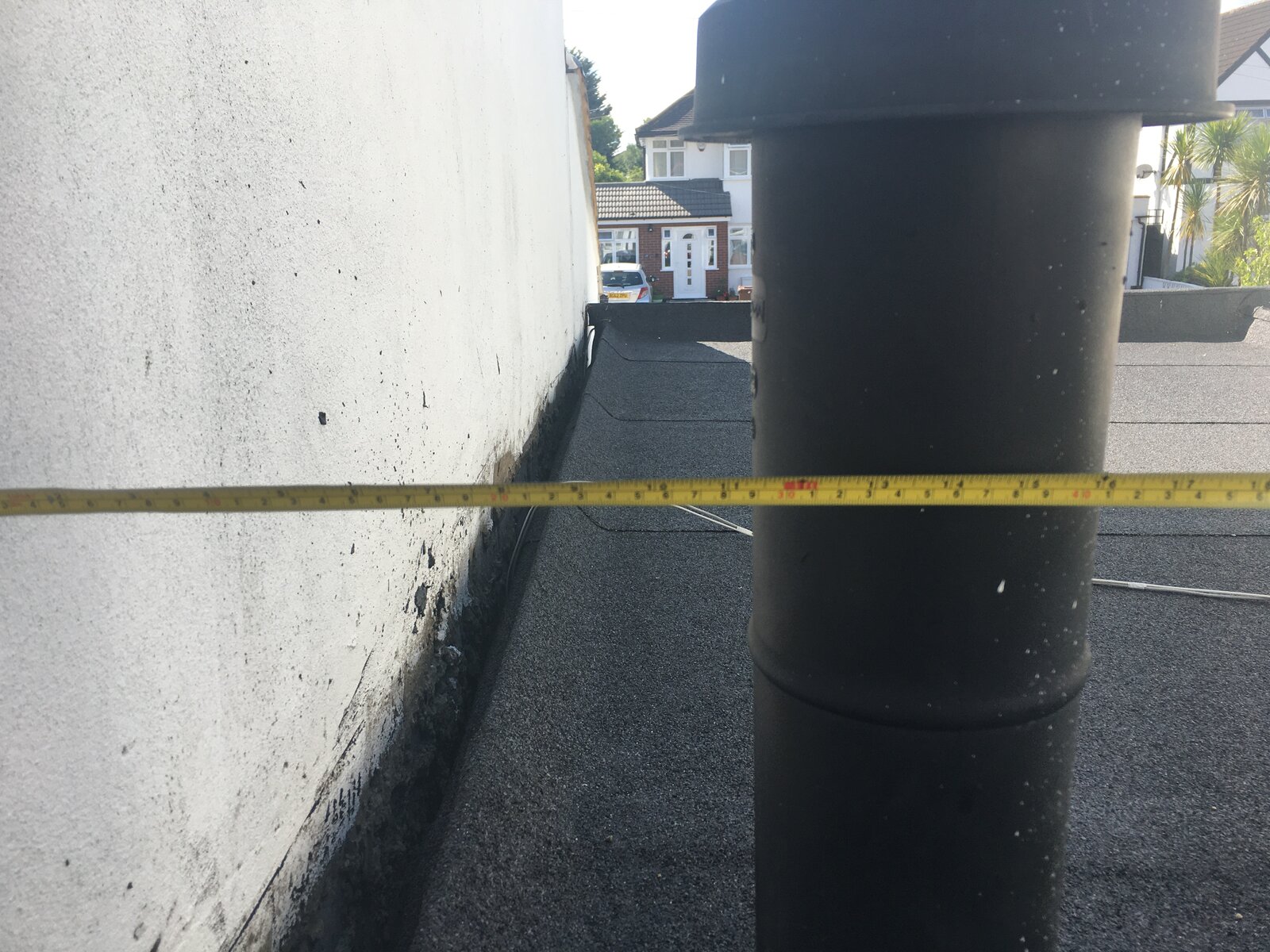

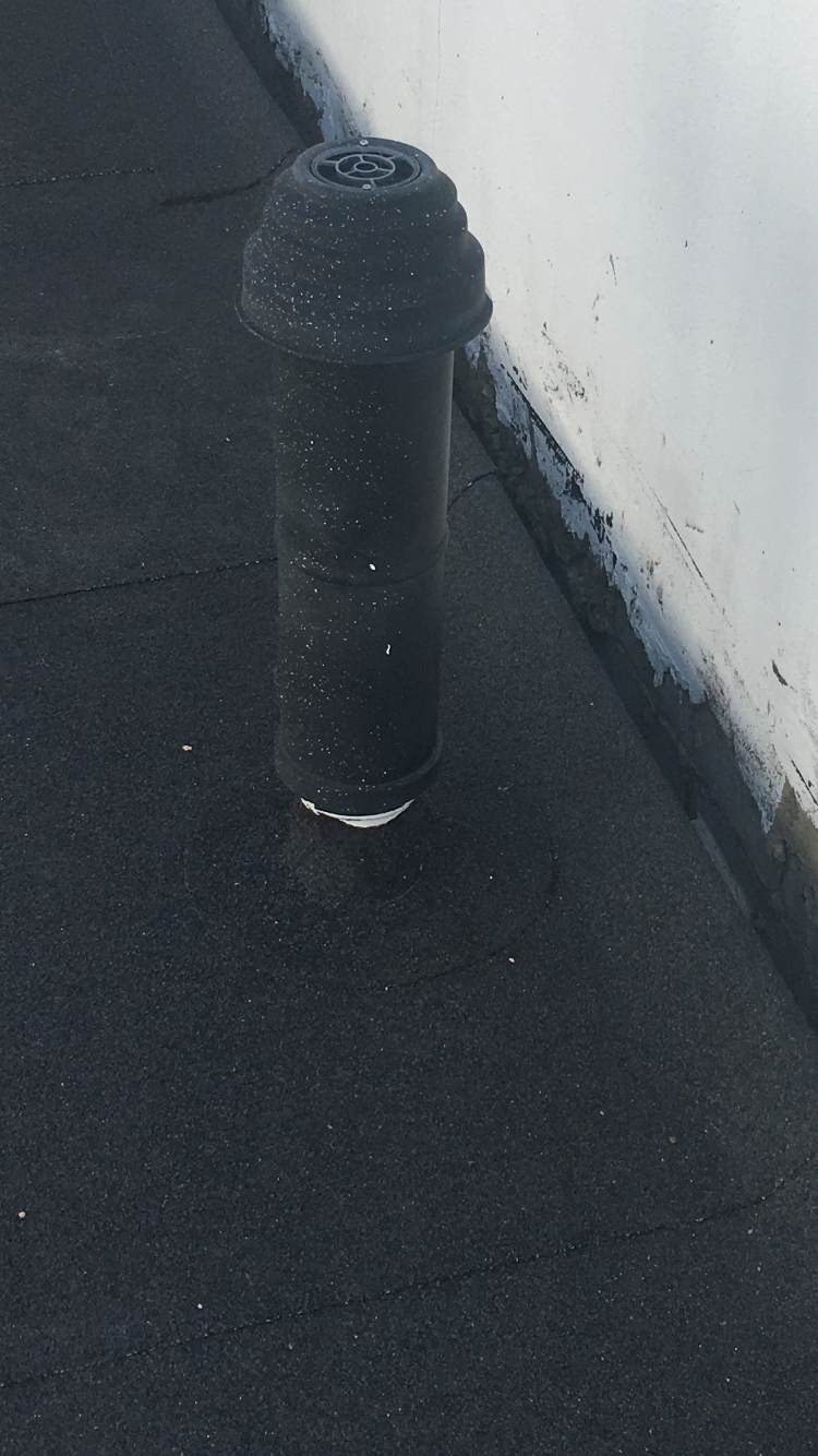

Where does the flue go to? It looks like it's a non standard flue this adds to the cost.
The installer will be doing a flush of some sort.
Does the quote include a new filter and an aerator, or expansion vessel? This all adds to the cost.
So you googled the price of the boiler. What about the vertical flue kit, extension, filter, chemicals, pipe, fittings and sundries ? Easily another 400 there. Price seems ok for London

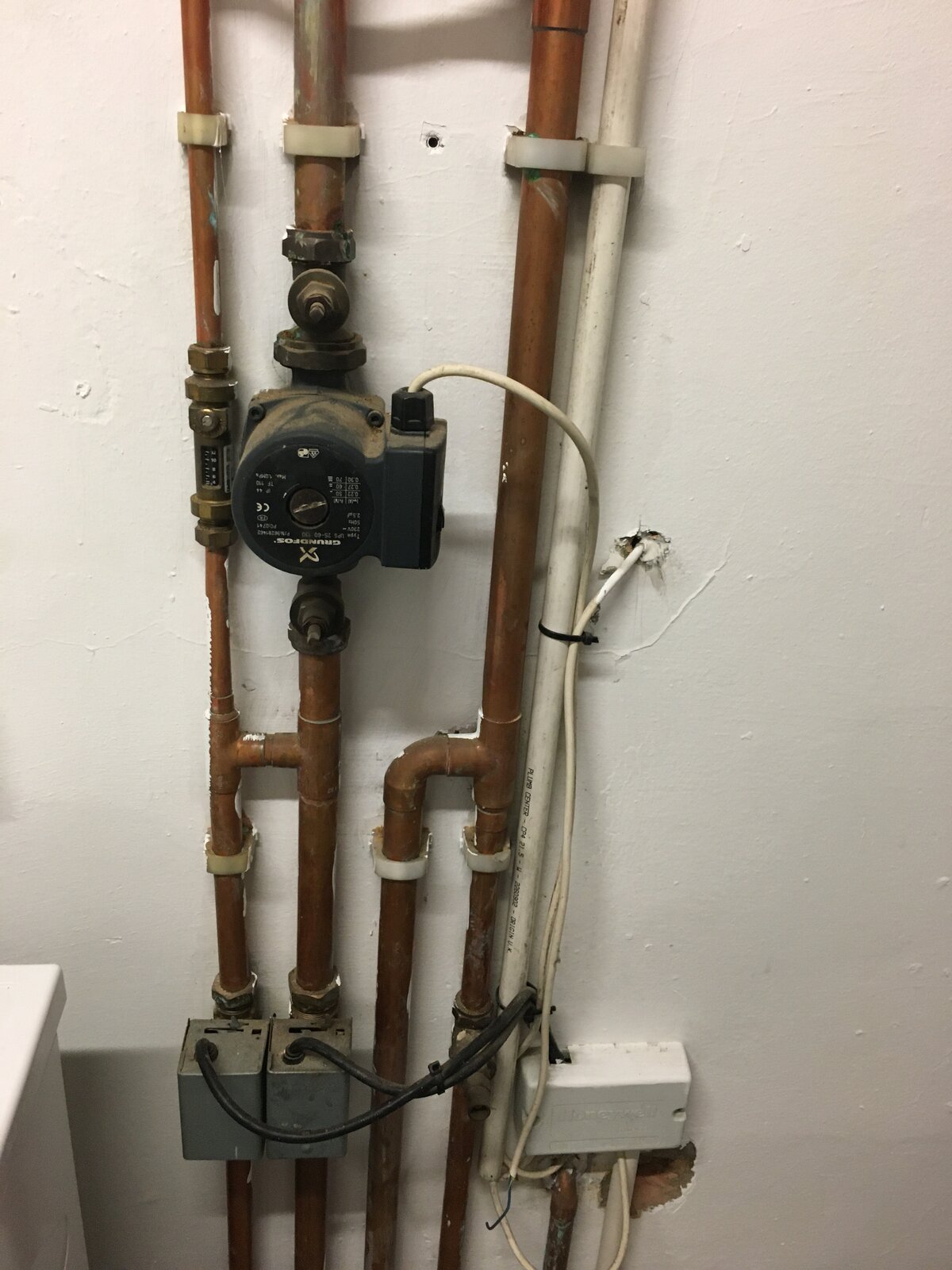

Also should I got for system or conventional? Right now I have a seperate pump and expansion vessel? Thanks
Vertical flue kit and extension about £200

It's down to how big the property is and whether the pump in the system boiler has enough flow to get it round the whole system.
I would be surprised if the internal pump on a system boiler wasn't powerful enough for the size of system the boiler is designed for though.
The installer says if you go for a system boiler the pump is under guarantee, but somebody else said keep your existing pump as it’s easier to fix if it goes wrong? Confusing

Also the flue is just over 300mm from adjacent wall which veismann allow but Worcester bosch dont
I’d say conventional. At least your pump and expansion are separate and can be easily and cheaply replaced.
