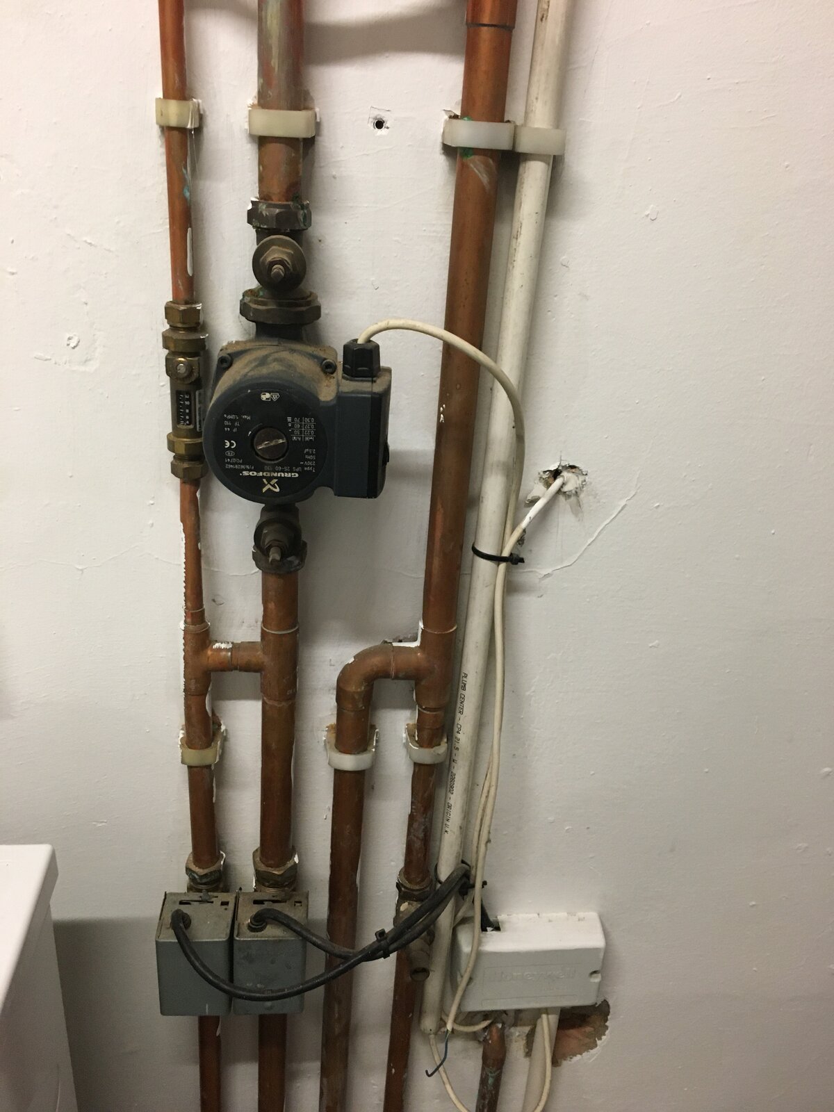

View attachment 201772 The installer says if you go for a system boiler the pump is under guarantee, but somebody else said keep your existing pump as it’s easier to fix if it goes wrong? Confusing
Makes little difference as to how easy it is to fix if it fails.
I would agree with your installer, get the internal pump system boiler, your covered then

Look at the flow rate you need for the system load, the minimum flow rate across the boiler then residual head of the internal pump from the Viessmann booklet. That's might just be why you pay a price for the installers knowledge.
