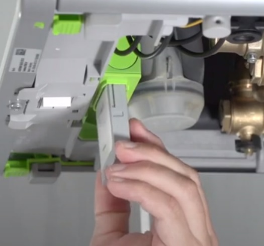

Seems the Easy Control receiver is "plugged" into the boiler and may rely on WiFi for it's link to the thermostat.
That said this appears in the Tech manual f (RF) MHz f = 868.3 … 869.5 [EU] which is not a WiFi frequency. I would assume this mode of communication is to enable the system to be sold to people who do not have a home WiFi network
What ever it uses for the link between thermostat and boiler the system would appear to be very much over designed and it not surprising that the average service technician could be out of his or her depth when fault finding on such a complicated system.

Thank you, yes that’s exactly where our receiver is. I have emailed Worcester and asked if they have a more experienced electrician team that can look in to this, will follow up with a call tomorrow. Seems from what you say it won’t be a simple fix or easy to get someone who knows what they are doing. Appreciate you taking the time
