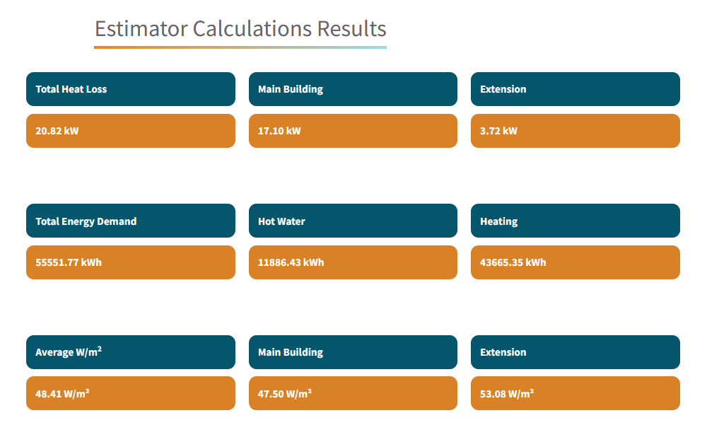

To do the job properly you would need a heat loss calculation done by a competent engineer to size the boiler correctly. The idea of these systems is to keep everything at a low comfortable temperature constantly rather than zoning things off and blasting heat into certain parts of the house. The theory is to tune it so that the exact heat being lost from the building is constantly being replaced which is where the efficiency comes from.

I've done a Heat Engineer calculation (attached) for the heat loss and it came up with 20kw - which I'm not sure how to convert into a boiler sizing or for the right flow temps etc. I suspect though that with a house like this you would probably need the boiler to run at a low flow temp for about half of the day at least to keep whole house feeling sufficiently warm.

20kw heatloss means you need a 20kw boiler (20kw of power when it's -2 outside)
However heatloss studies are rarely totally accurate especially if you have guessed a lot of it.
