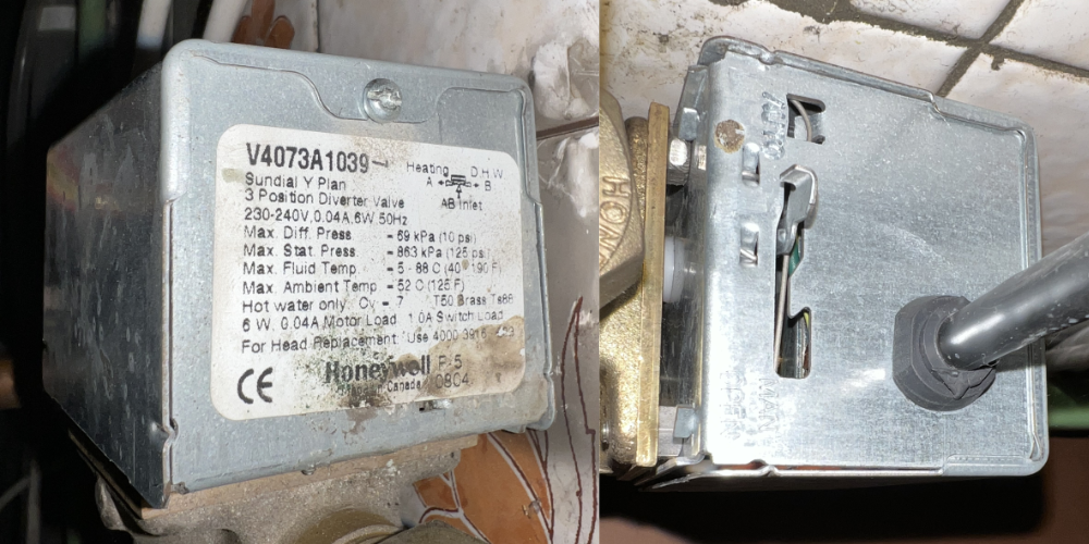

You will have a motorized (zone) valve which stays open once HW is selected on and the cylinder stat is calling for water, you will either have seperate valves for the CH and HW or just one, called a mid position valve, with three pipes, try and locate these/this.

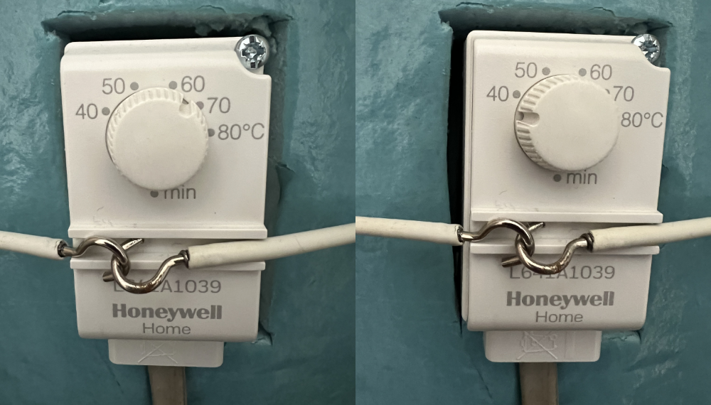

I cant see the cylinder stat scale clearly, what is it?, and what setting is it on?, turn the dial slowly anticlockwise (until you hear a click, note the reading, turn it back up slowly until you hear another click and note this, return it to its original setting.
I assume you mean the 3-position diverter valve? This was replaced quite recently as it was faulty but is there anything I should check that could indicate whether it's become faulty again?
It's a Honeywell L641A1039 Cylinder 230 V Stat and it's currently set to 65 degrees.
I only seem to hear a single click when the dial is turned to approx 38 degrees or possibly if there are two clicks is within a range of about 35 to 38 degrees I would say.
Normal Setting - Left | When I Hear a Click - Right

The 3-position Diverter Valve From the Top and Bottom
