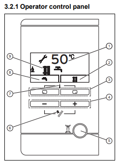

Thank you for all the help. Heating is controlled by Hive on the phone, it switches off via timer ( schedule) (not switching mains off) can't find any i buttons.

Maybe try these buttons:

Can you post a photo of what the display is showing when the boiler isn't working?

it's a Valiant Eco Fit Pure OV boiler
Do you also know either the exact version or the power output? The boiler comes in a range of outputs from the 412 version (12kW) to the 435 version (35KW)
