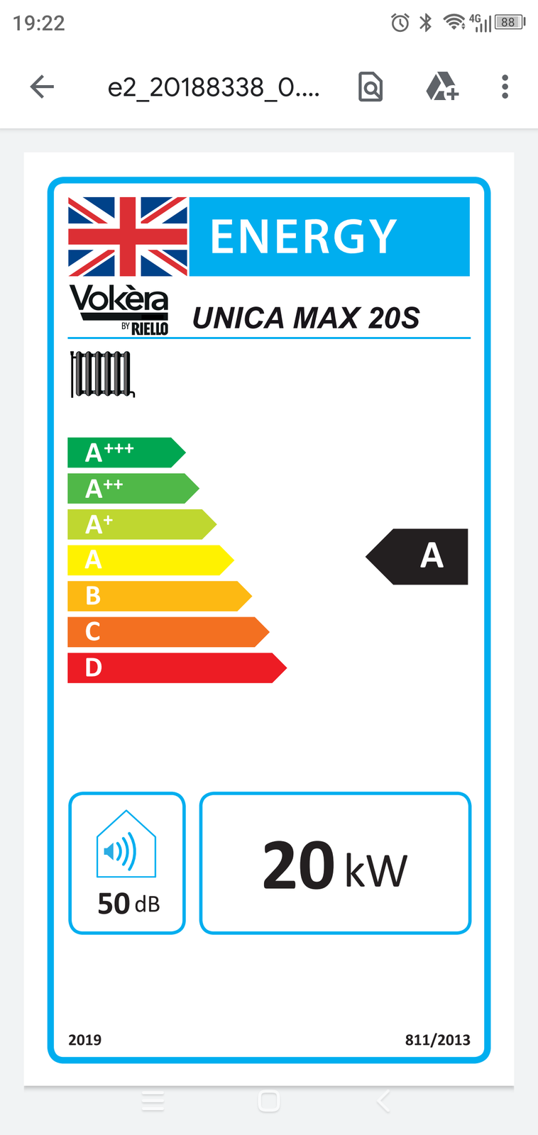

The ErP energy label has the sound level
Thanks, I didn't think to look there! The Intergas HRE 18 SB is rated at 45dB, which is a fair bit lower than the 50dB for the Unica MAX S 20. Not sure how much different it would be in real world conditions though...

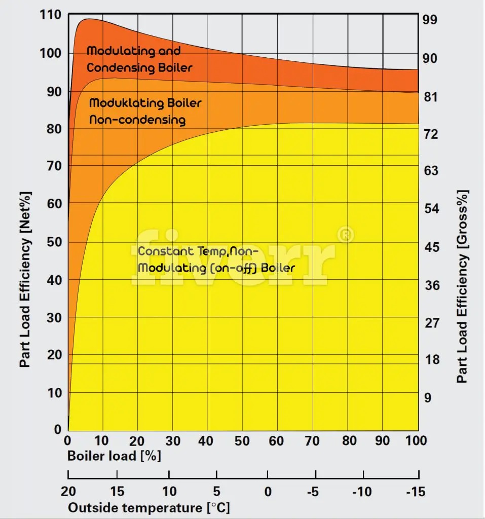

EDIT: It would definitely be nice to have 1.9KW in terms of comfort, but in terms of efficiency the gains of extreme modulation are disputed. Viessmann did produce this graph which shows good gains. I don't know if you've seen it. It's quite confusing, but you want the gross efficiency figure on the right.
