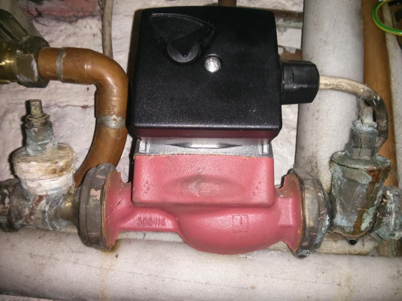

We had a plumber out last week when it was overheating and he got it working by turning down the control knob to "2". It was still overheating but came back on after a while. He replaced the pump a few days later. Now it is overheating again but we cannot get any hot water at all. The pump is extremely hot to touch, but the pipework beyond that is only warm for a few inches.

Hi,
Not sure what I should be checking with the pump? I took the front cover off to make sure the wires were in properly and they seem fine.

Is the pump spinning? The small tank in the loft should be about a 1/3 full. If its higher the you have a blockage on the cold feed to the system.
for starters the pump is fitted incorrectly, air will collect in the top of it & it will burn out in weeks, pumps don't drip, who on earth was this numpty cause it looks to me that he hasn't got a clue, make sure the arrow on the pump body is facing towards that three port valve (where on earth is the head of the valve ?), make sure the two valves are open either side of the pump, get a screwdriver & loosen the silver screw in the middle of the pump & let the air out, then tighten it,

I can't feel or hear any noticeable spinning from the pump. The tank is about 1/3 full so seems ok from what you said. The central heating is on the same system - note the diverter switch just after the pump. You turn it all the way to the left for hot water only, all the way to the right for C/H and in the middle for both. Should I try it with C/H selected?

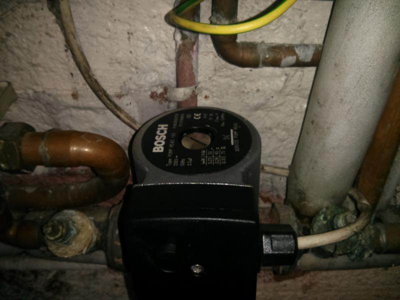

I'll get a close up picture of the pump to see if you can find what you're looking for any easier. Since the pump is so hot I guess I should wait for it to cool before loosening any screws?

it's facing the right way
you don't need a multimeter i can hear it running & it's full of air not water,

a pump is lubricated by water & in that position it will fill up with air & it WILL burn out (which is why it's so hot), thats providing it's not already knackered

That's a relief, I wouldn't be comfortable doing much more than loosening some screws :)
So to get the air out I loosen the big screw on top? Is it like bleeding a radiator as in I wait for water to start coming out and then tighten again?
Am I right to say that the pump feeling so hot is because the motor is overheating rather than the hot water is getting stuck there?
yes, then get them back to turn the pump body down so the screw is facing you (facing out)
