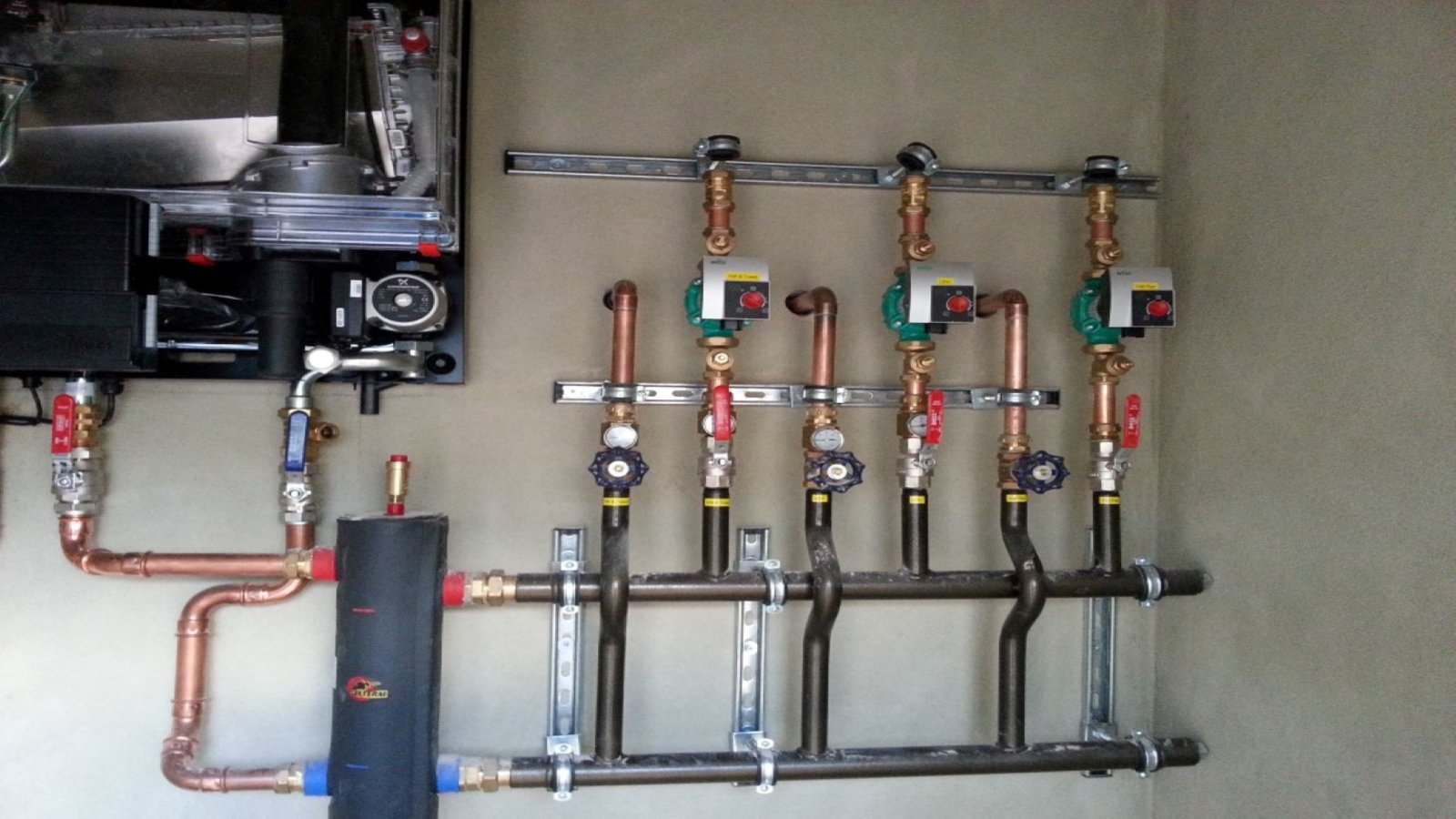

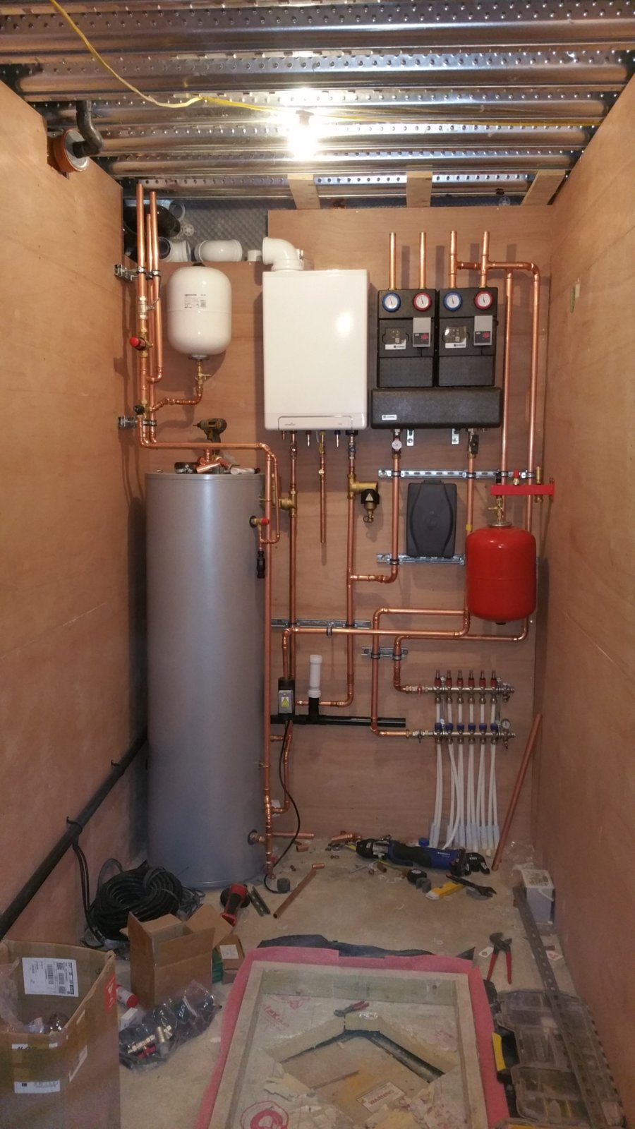

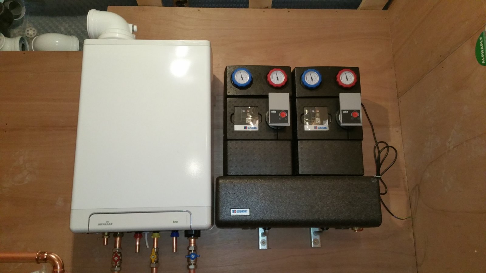

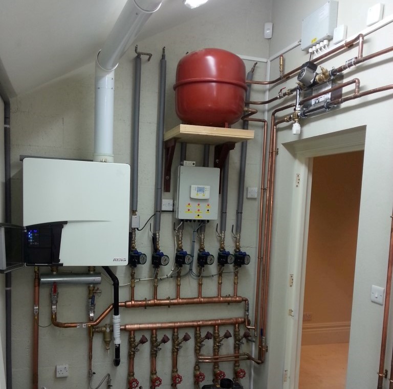

I'm intrigued by this low loss header concept. You're the third person to suggest hydraulic separation on this thread; so I will definitely have to look further into this. How does your set up look?
The are various ways of doing it, here are some examples we've done recently in varying states of completion:
Some beautiful looking work. Turns out the system just needed a second powerflush and now works in a way that we've never experienced since moving in. Every room heats up and the boiler is running constantly on full flame at whatever temperature we set!
