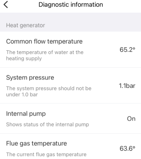

Boiler pump running when no heat being called for
16 Mar 2014
71
5
Devon
I'm finding that occasionally the boiler pump will be running when no radiator is calling for heat (and the boiler is outputting none). I havent really timed it, but its just for a few minutes I think.
Its not directly after heat has been called, but seemingly at random.
Do some boilers run it periodically for any purpose?

Viessmann have said:
"The pump will run on after a water demand for 3 minutes, and after a heating demand for a minute .
Occasionally if there has been no operation the boiler may do a system check also "
So I'm thinking its these 'system checks' that I hear at odd times.
