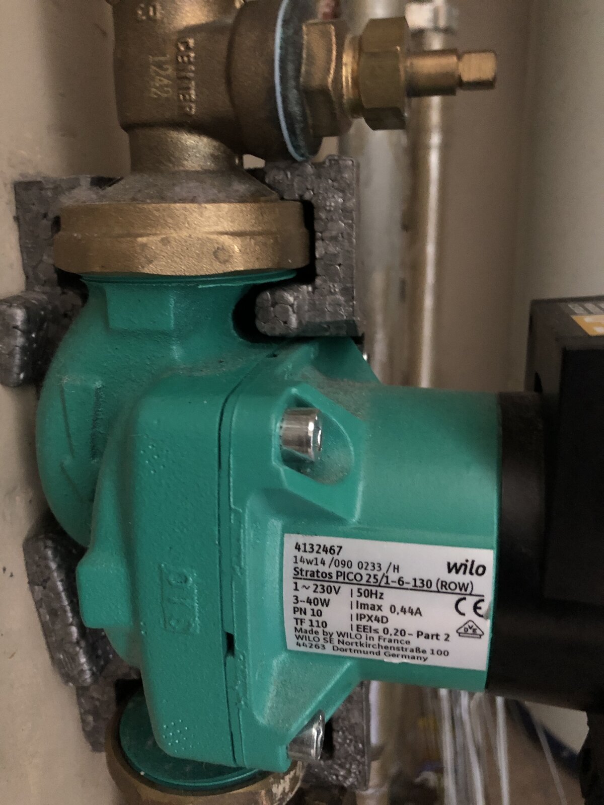

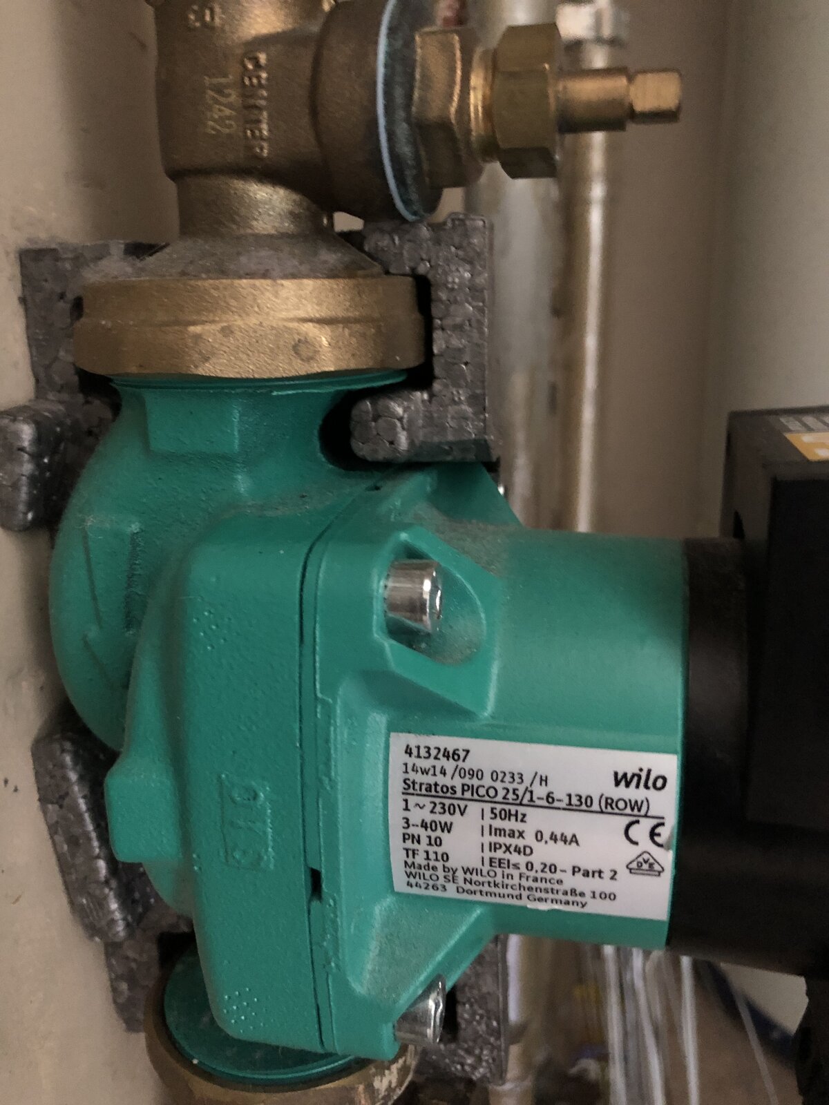

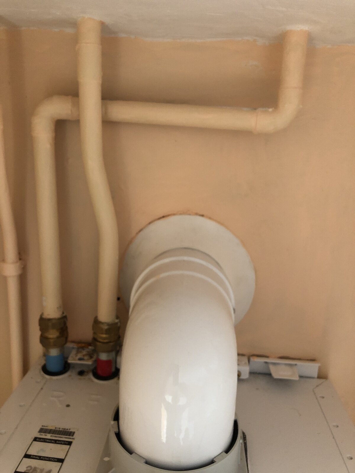

Doubt for such a short time it would have much effect on the new boiler, reason I asked origionally if the pump was new, I suspected it was the wrong way round, it was because the flow and returns were reversed, much more common than you think , with sealed system combis it is usually only the old TRV valves that suffer as the pump is inside the boiler, but on an open vent it is crucial that they are correctly orientated

Ian got me thinking. Yes pump is definitely pumping right direction

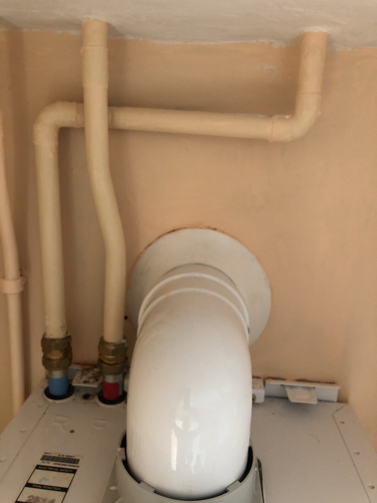

On reflection I think they have installed correctly

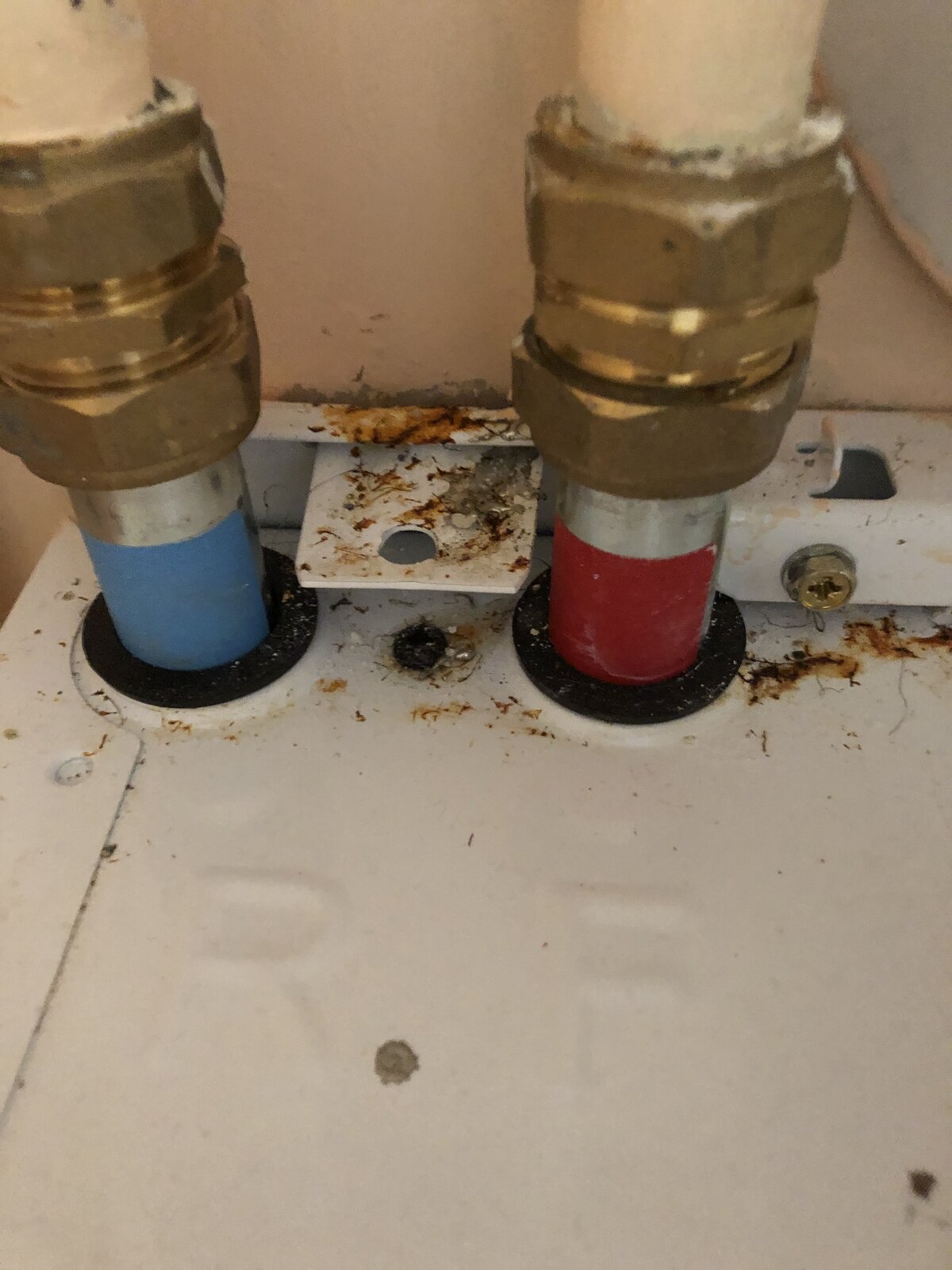

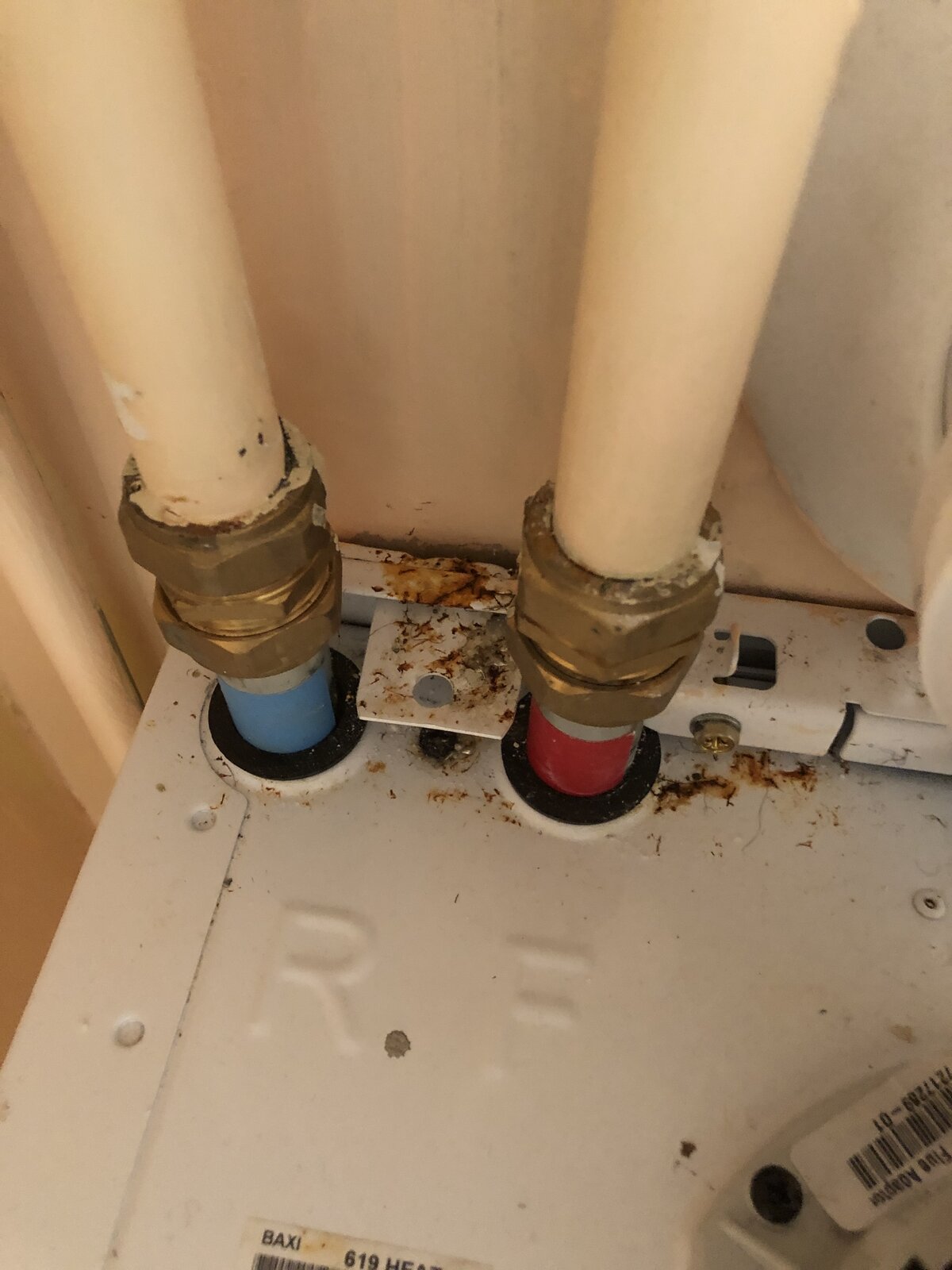

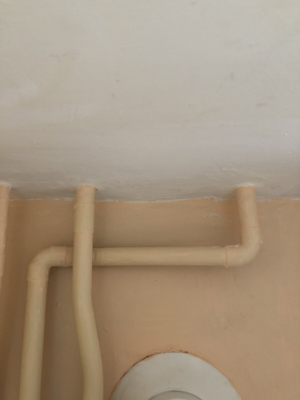

This shows the original piping to Potterton Prima boiler flow left and return right. Plumber has crossed them over to connect Baxi boiler.
Nope the pipes would have to be crossed, better if you mark each pipe Blue and red then follow where they go after they enter the ceiling, then mark them all the way to the cold feed vent and pump, they should all be on the red pipe
Thanks for your assistance. I am getting the gas safe installer to check out the installation
Why don't you just fire up the boiler and feel the flow&return piping??. does the boiler menu display anything as well?.
