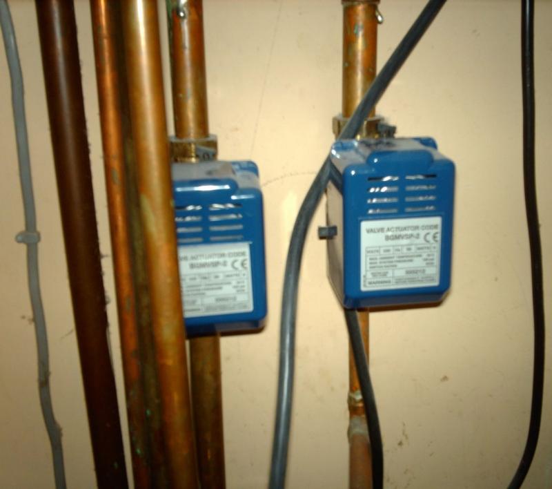

Valves are in the post above mate

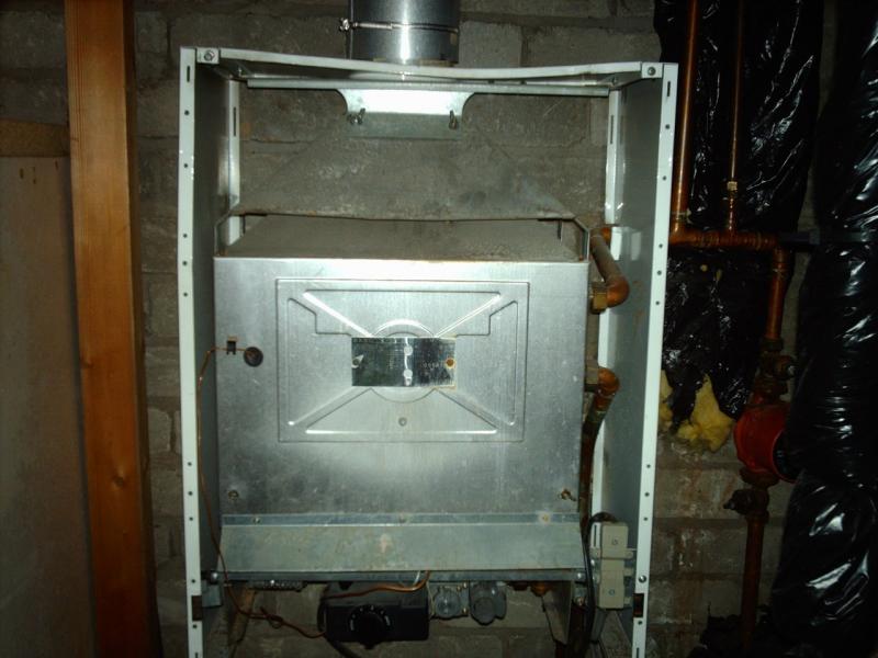

3 boiler model no is :- baxi wm 40/30 of
4 actuator valves are in airing cupboard

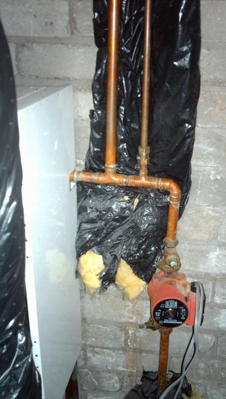

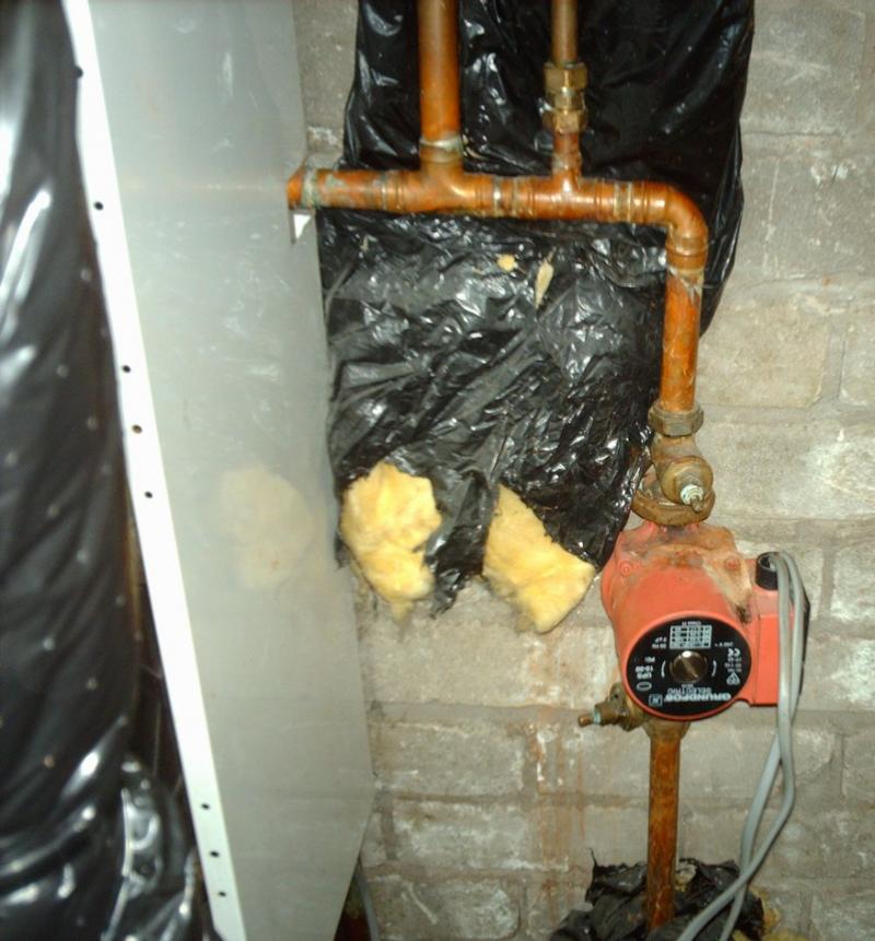

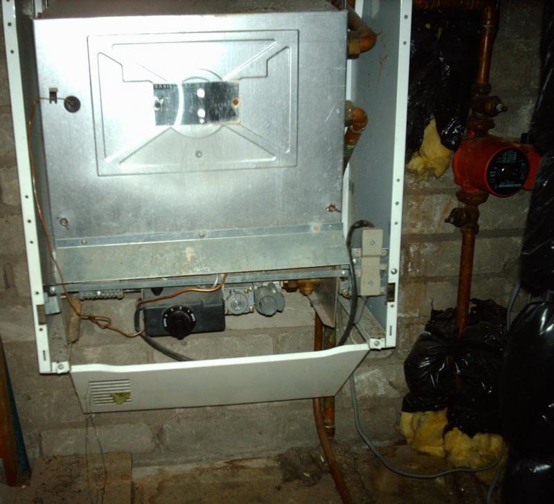

have taken pics as requested

turn the system off, above the pump to the left is a 15mm pipe, can you crack open the 15mm brass coupling and see if you get any water from it/?
May be worth while placing a few towels and a bucket under neath.,

1 yes water from towel radiator. pump is next to boiler highest in loft, yes pump is dry
cracked pipe open as you sugested plenty waterfrom it

we are looking at evidence to see if the system is being topped up from the tank. What you are describing often happens if there is a blockage.
It is usually just below that brass joint that you losened, you could try taking it off and poking a stiff bit of wire down. Or hold a strong magnet against the copper pipe and see if it is attracted (this happens if the pipe is clogged with black iron oxide)
