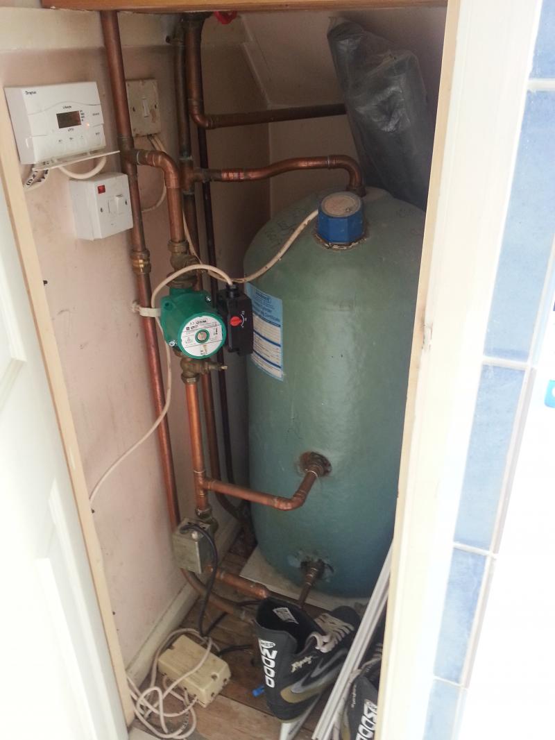

Hi everyone, ok the heating system is a standard none combi type and
The boiler is a new Valliant, basically after turning the heating on for about one hour the boiler will start sounding pretty rough then shut down,
If I then bleed the central heating pump with the bleed screw in the middle of the pump the boiler will then start up again and run perfectly well for maybe an hour or so until the same problem starts again,
I have drained and flushed the system a few times, I have also added sentinel inhibitor, all the radiators get hot and never have any air inside and there are no leaks in the system,i have also replaced the heating pump just to make sure the old one didn't have a fault, but I would like to point out something that I am not sure about, the pump was fitted so that it pumps in the same direction as the old unit that I removed and that is upwards away from the solenoid that you can hopefully see in the picture
is this correct... thanks everyone Stephen
no it should be pumping towards the zone valve, you need to turn the pump body around so the arrow is facing down, plus if you have had a new boiler fitted then you should have had another zone valve fitted on the supply to the cylinder & had the single channel prog changed to a twin channel one, are you sure the installer was gas safe reg ?
looks like there is no cylinder stat fitted either! where's Matt Allwright when you need him?
or auto bypass, not that it needs it with cylinder always open due to no zone valve.
And the immersion is spurred of the heating supply.....You should get the installer back but something tells me there was no installer.

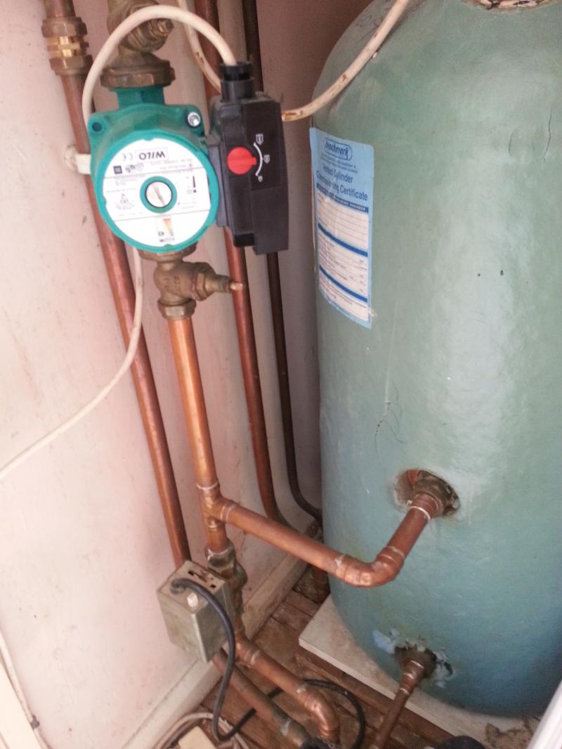

Why does the coil reduce to 15mm ? Get the installer back and punch him in the mouth.
Presumably he was trying to regulate the flow through the coil to avoid robbing all the heat from the heating circuit?

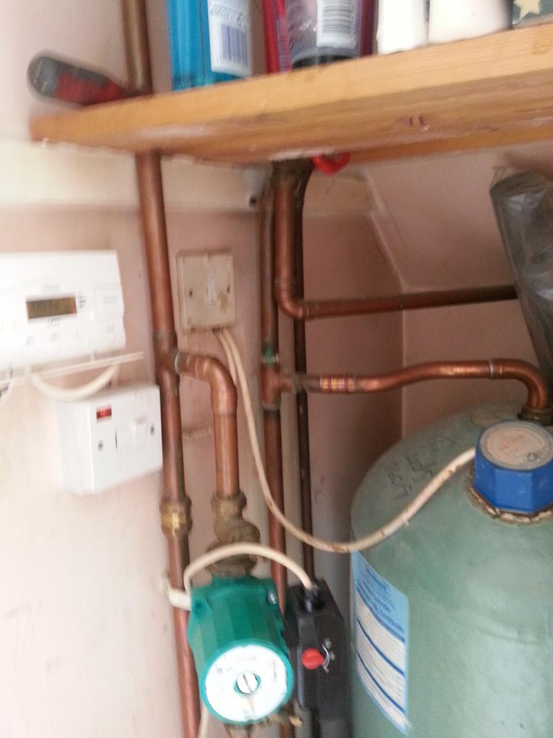

I was a little concerned about the angle of the hot water draw-off pipe. From the pics it looks like it could be going downhill as well.

So its possible that the original system was just pumping round the HW cylinder until the boiler stat was satisfied and the 2 port was wired up to a roomstat for the radiators....?
Seen that a few times on naff housing developments penny pinching.
All the same..if the installer you used for the boiler was Gas Safe registered he has broken every rule in the book as he is required to update the controls not least because you cannot utilise your new boiler at all properly unless it is managed correctly, Any installer worth his salt would have repiped that cylinder and added an extra two port and a new programmer and a cylinder stat.
It clearly doesn't work properly or you wouldn't be on here. I suspect that what you really need is a PROPER heating engineer to come in and sort it out. It may cost in the short term, but it will be a saving in the longer term and you will have a good working system. I don't know the installer who put your new boiler in, or the terms on which you engaged him, but what I can say is that what you have shown us is not a good advert for the profession one way or another.
