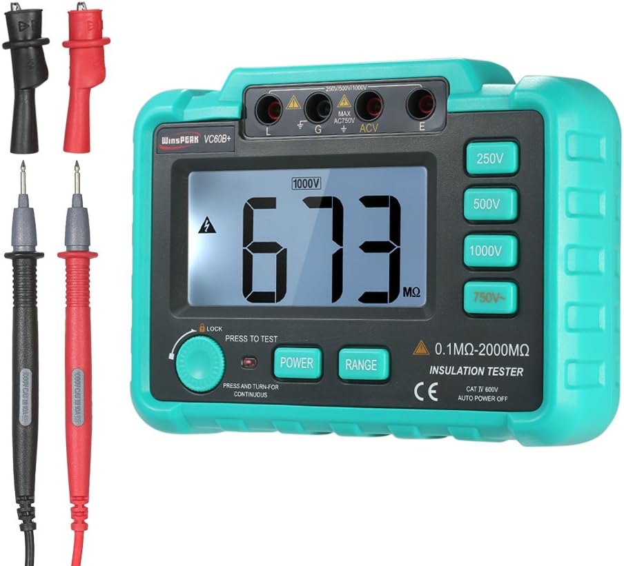

Seems a little odd, one would expect an electrician to use an insulation tester and clamp-on ammeter and be able to work out the problem rather quickly. I can see the problem with DIY but not an electrician.
The testers can use 250, 500, or 1000 volt which can damage a boiler so not the thing for untrained use. But you have already worked out the area of the fault, so why has he not found it, are you sure he is an electrician?
He should be using something like this

But clearly once tripped you can't measure 9 mA anyway, so the other tool is the insulation tester, which is rather important, as the RCD measures current in and current out, it does not measure current to earth, it just assumes if two don't equal then it must be going to earth, and in the main it goes line to earth. (Live is both the phase and neutral, so to differentiate with single phase we call it Line) However it can also go neutral to earth, and this causes a problem, as the more current that is drawn the bigger the voltage difference between neutral and earth so the more current that will flow, so bit of wet bread in a toaster can cause RCD to trip when kettle is used, because when kettle used there is a bigger difference between neutral and earth.
So we test neutral as well as line, and we use 500 volt DC to test with, but DC does not have capacitive or inductive linking, so it is not 100%, but finds most faults, however some boilers have a filter to stop spikes on the supply for doing damage, and 500 volt can damage the filter, so we normally use 250 volt only with anything using electronic controls.
