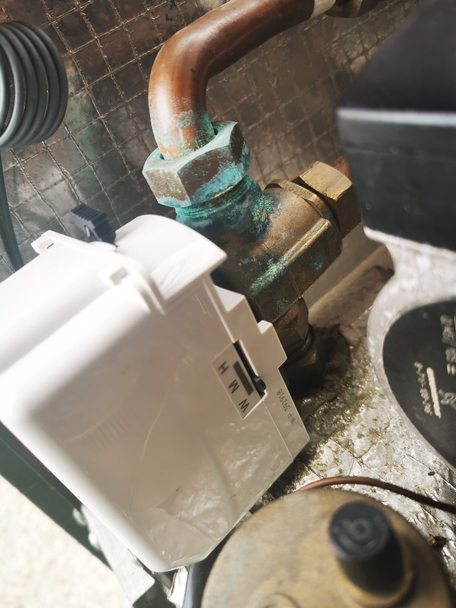

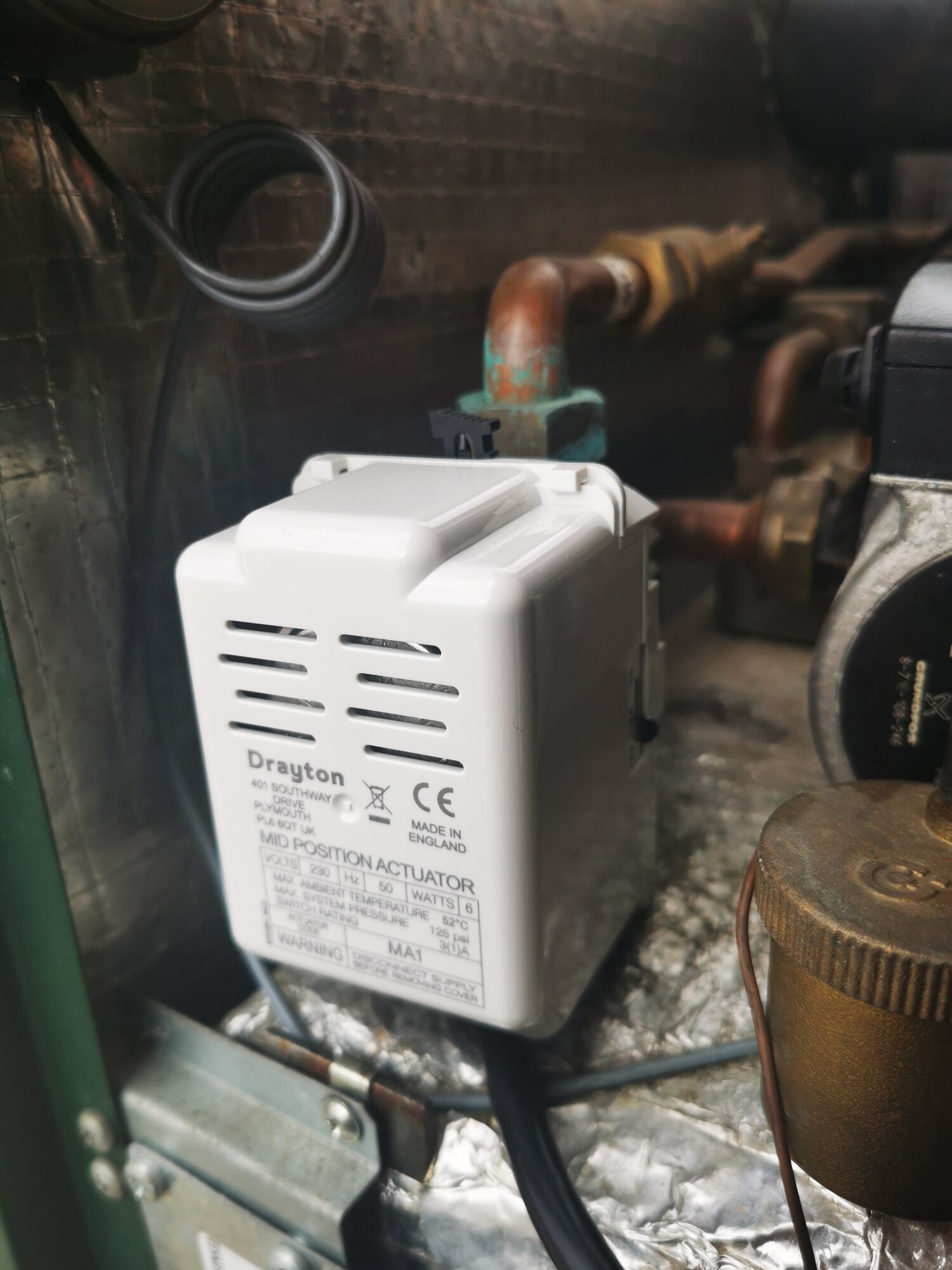

Had to replace the valve actuator as the old one was sticking. Wired up the new one with the same pinout as the original. Tested but got the following failed outcome;

We only moved in a few months ago and haven't needed the heating much, but we did notice it was coming on at random or when water was run. Worked out that the valve was sticking, removed it and only got around to replacing it today.

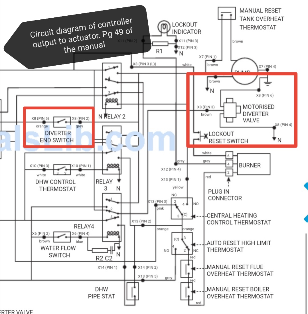

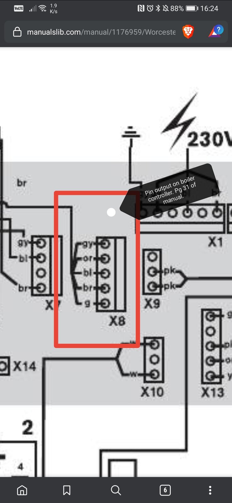

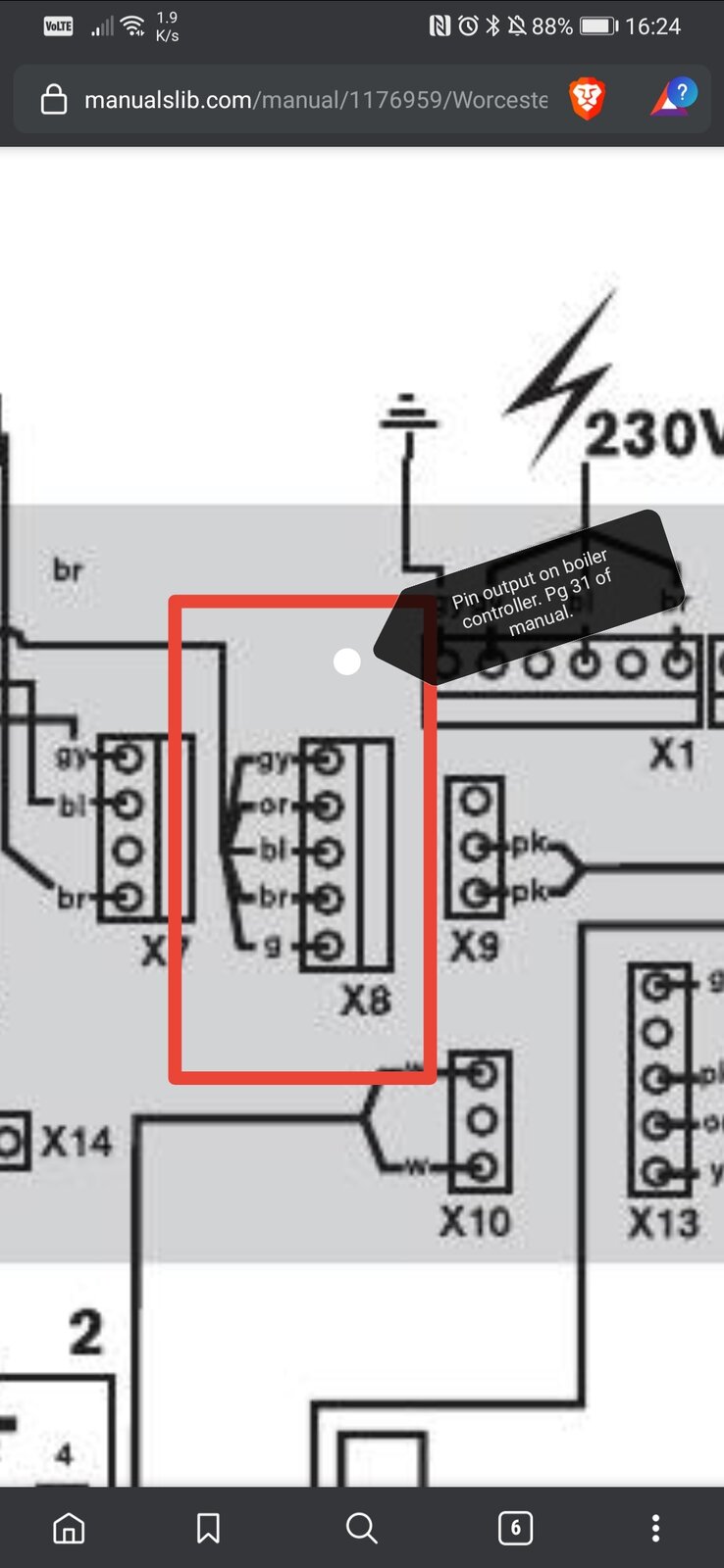

So I after the actuator failed to move to the expected positions I thought must have always been wired wrong (as i matched the previous wiring). So I hunted out the Greenstar and Drayton manuals and tried to figure out what wires did what. A multimeter, a lot of cursing and 6 hours later, I managed to map what the boiler outputs and matched it to what the actuator does.
I've now got the DHW and CH working separately. But for the life of me I can't figure out how to get them to run both at the same time (actuator at mid position, yenno, the whole damn point of the £70 hole in my pocket!).

It sounds like you're tying to bodge on an off the shelf Drayton mid position valve rather than buying the correct Worcester part which is a simple diverter valve (ie. diverts the primary water to either the rads or heatbank).

As I said above, I replaced the exact diverter that I found in the boiler. I didn't try to bodge anything. I would have bought the original Worcester if I knew one even existed.

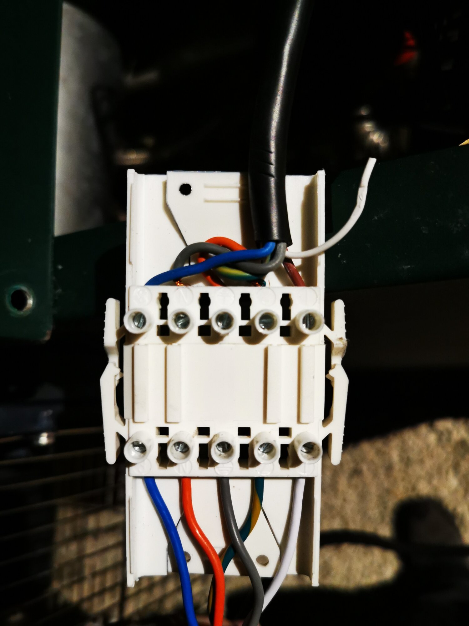

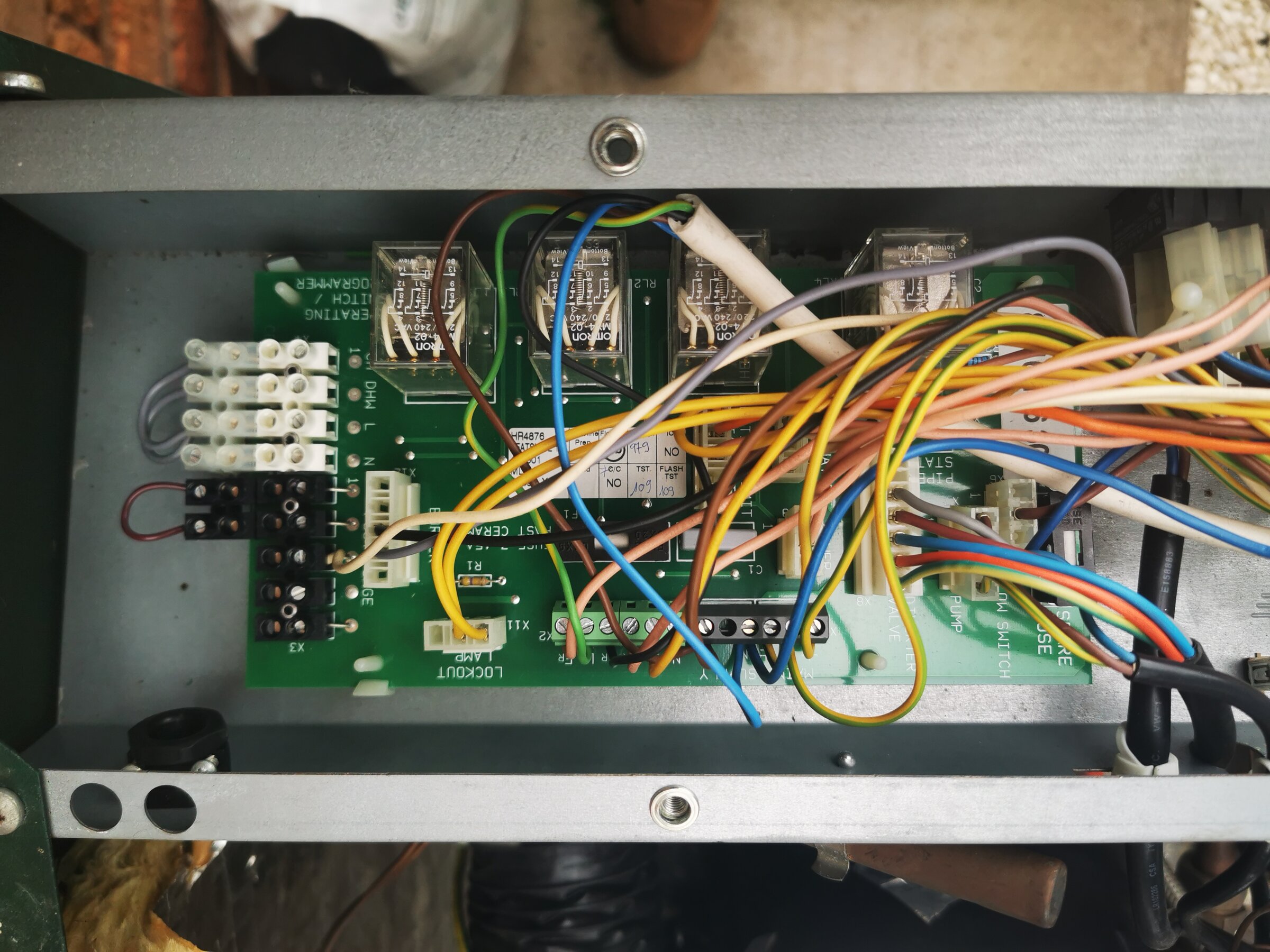

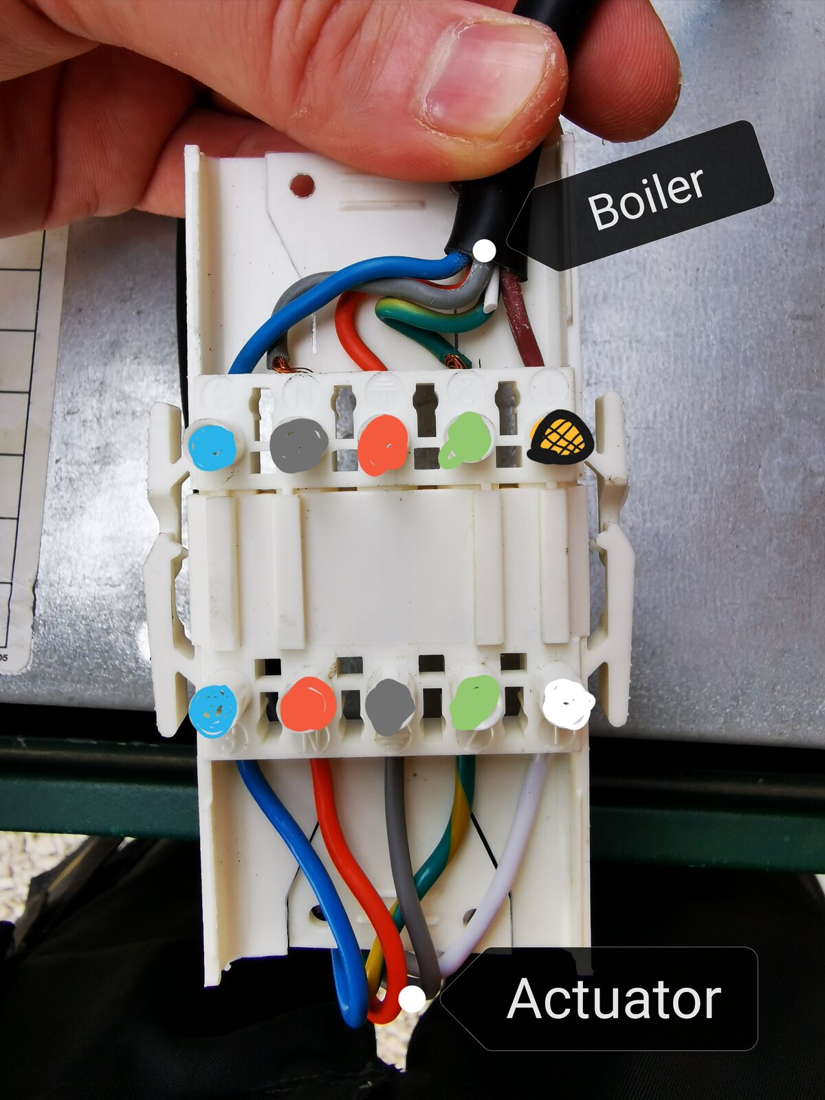

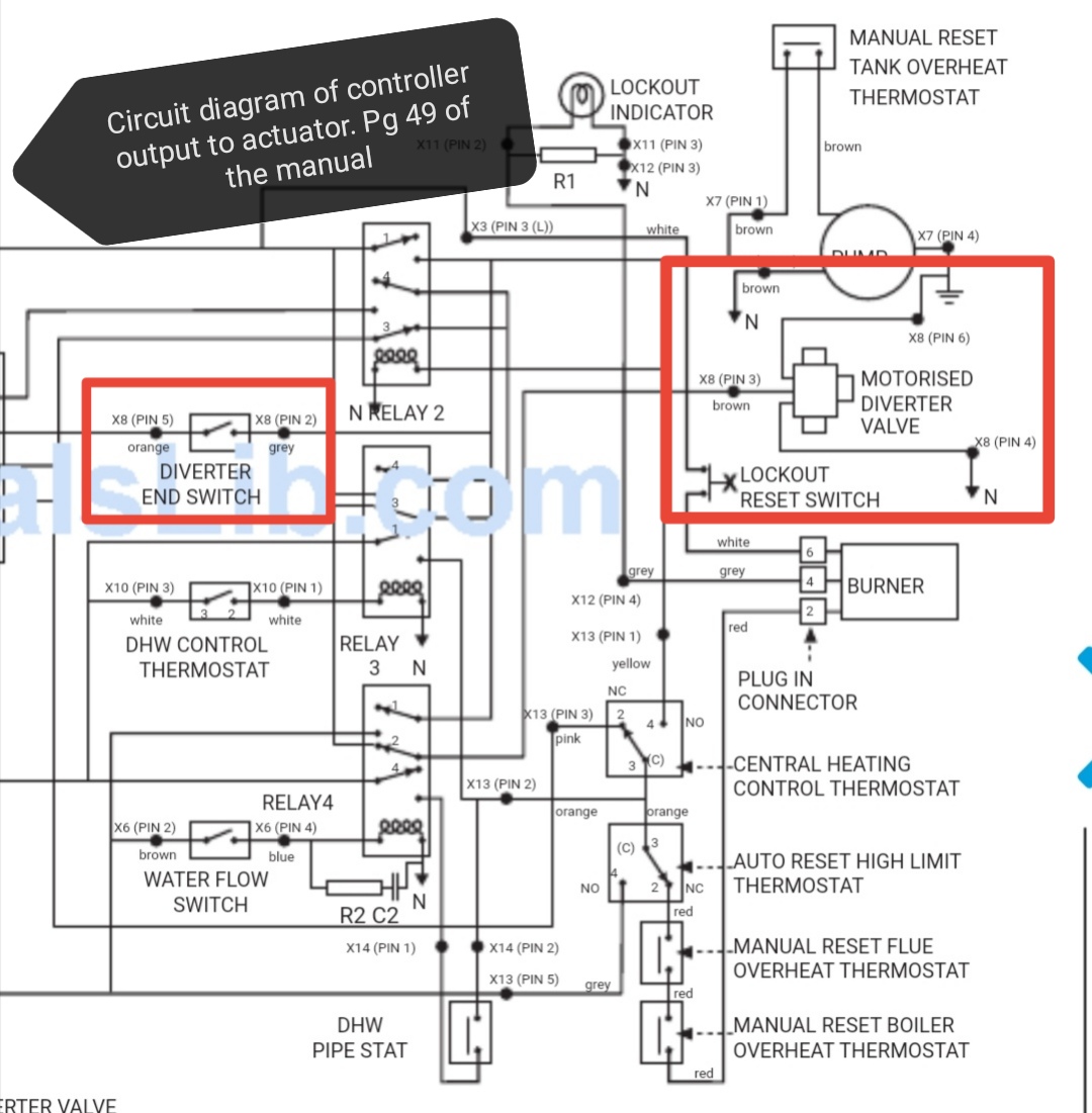

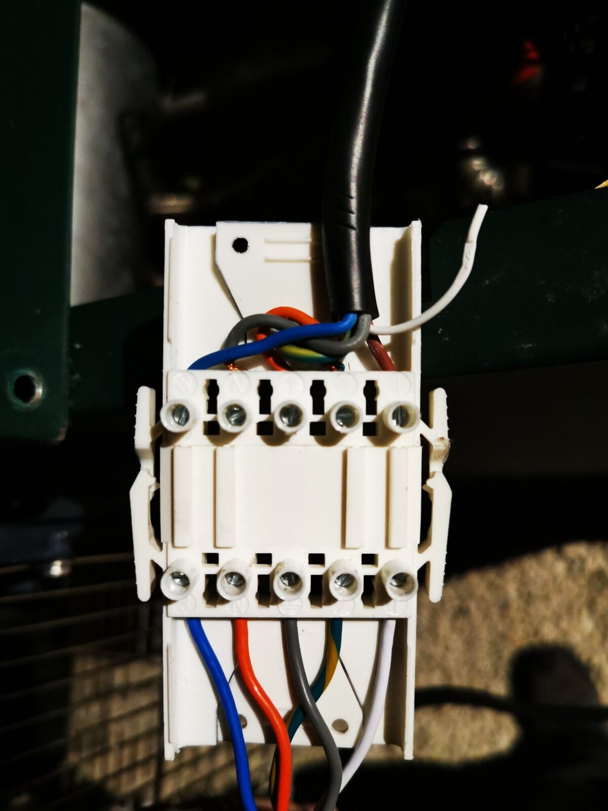

That image there, it is not very clear , that connector is used to join the multi core cable when replacing the valve actuator, cant really tell but it looks wrong, can you straighten out the cable at the top and post another pic so we can see what is connected to what
Yea sorry about that, not the clearest :LOL:
I've added some more photos and labeled them as best I could.
This current wiring let's the heating and hot water work separately but not together. I tried other configurations of orange, white and grey and non of them did anything the right way. This was the only way that worked.
Wiring the colors to match like for like, with brown matched to white, was how the old one was wired but neither the old nor the new actuator worked properly with that wiring.

The heating and hot water are not designed to work together...a DHW demand and replenishing the heatbank always has priority.
For the sanity of yourself and any future eng. working on the boiler buy the proper diverter part no. 87161087230
Perhaps a previous owner of repair tech has tried to be clever...
Check the wiring diagram fully but in theory connecting boiler brown (motor Live) to the actuator grey & white will result in the motor winding fully to the heating position.
And connecting boiler grey to actuator orange will obtain the Live feed once the valve has motored. ie. replicate the end switch in the proper diverter actuator.
If the wiring isn't perfect on a mid-position the motor can become magnetised and stick...
I think you; findif you have amid position actuator, if you simulate theCH only position, i.e just power the brown then it will work as a diverter. Just make the white safe and ignore it.
Er..no brown on a mid-pos.
An end microswitch is required to operate the pump....hence powering both the grey & white and using the the orange to simulate the switch.
And as for trying to get the boiler to have heating and hot water...too late in the day to get my head round the relays etc...
The micro switch is operated when the the motor opens. The PCB feeds the grey, energising the orange to fire burner and pump.White opens the valve I think so put that where brown is in PCB. ( was getting confused with H.well) I've not adapted a Drayton Actuator, but have done the Danfoss HSA3 on Boulter Combi's. At 5 o'clock on Christmas Eve, you have to try and do something
O.P., if you have a mid position actuator, you may as well try and use it as it is paid for. Now you know the boiler does not do 'mid position', the orange and grey are the same as your old actuator, and make the switch when the live feed opens the valve fully.
