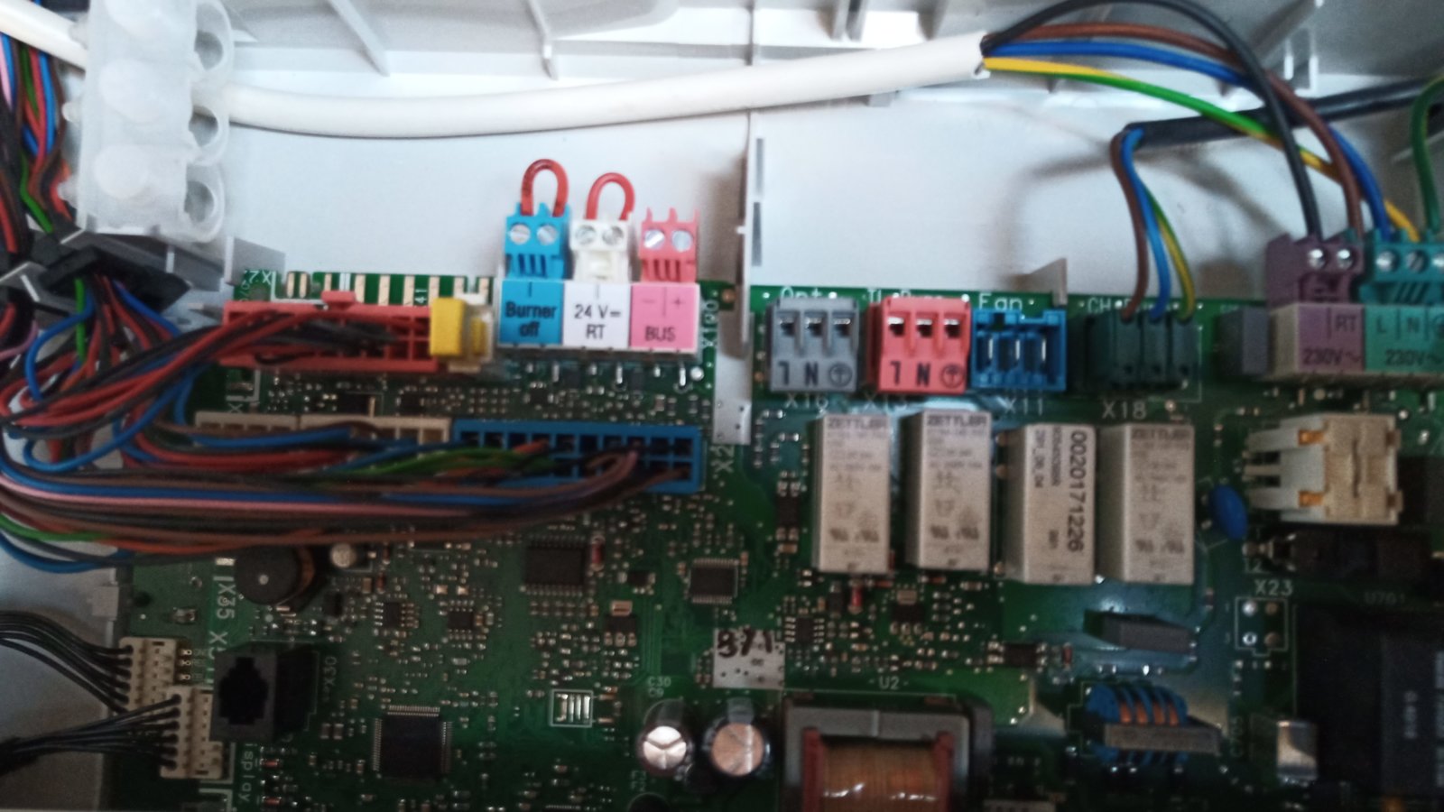

Boiler working overtime (vailant pump overrun)
Photo of board attached. 24v loop is there
So just remove that?

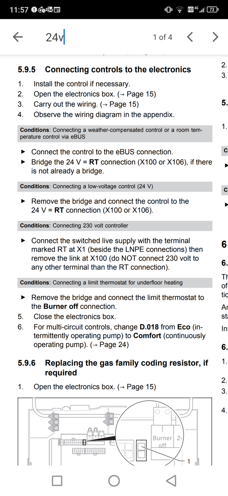

Just looking at the instructions and it doesn't seem to suggest it needs removing unless you're using 24v controls... Am I misreading?
Jesus mate just remove the link, if it all goes t1ts up put the link back in, the fact you have a wire to the 240v rt means you cant have the 24v connection as well.
Fair. It's out.
So far so good
Will watch it (well listen) over then next 24hrs and see if it's behaving properly!
Appreciate the help guys, fingers crossed!

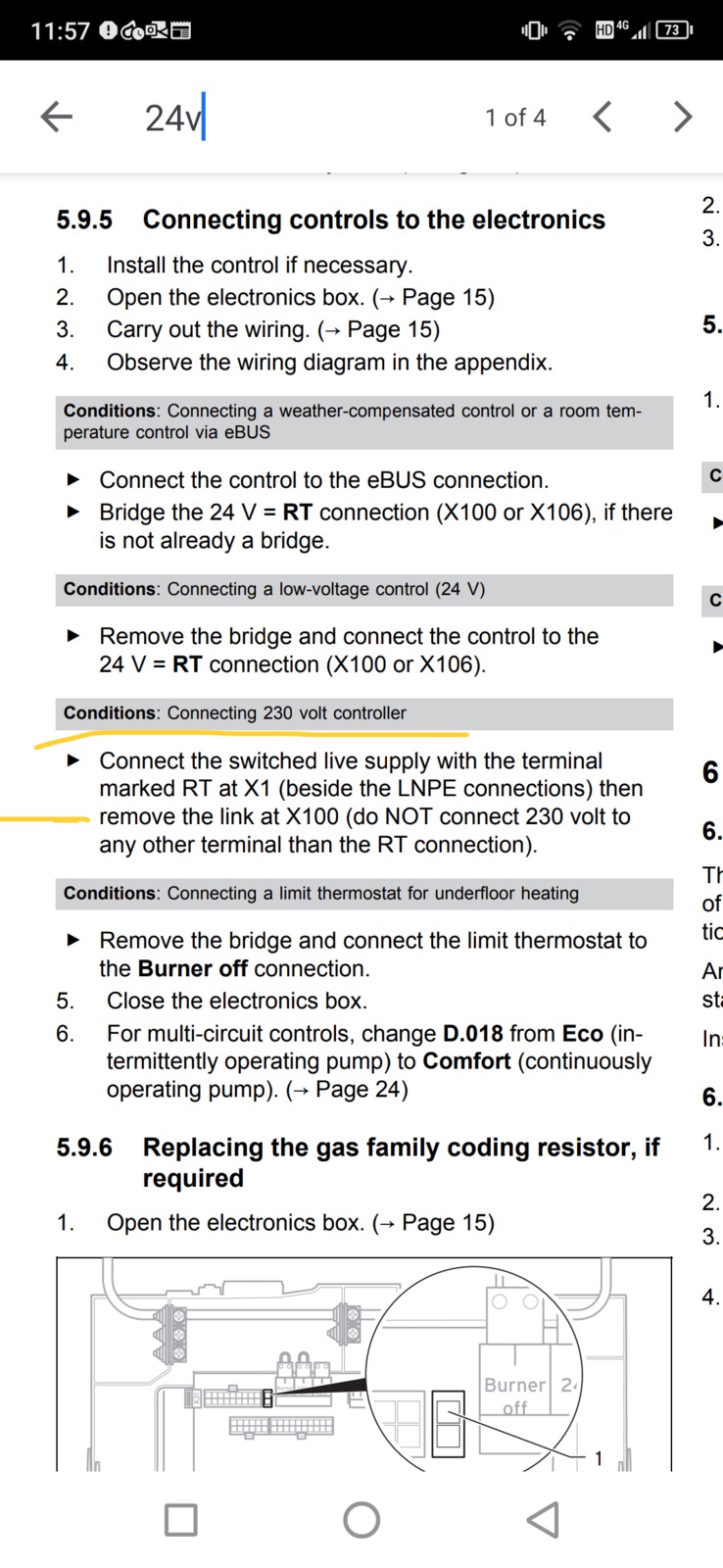

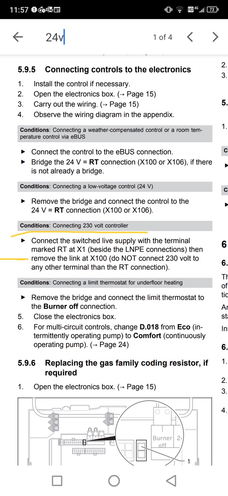

You’re misreading. See edited photo, it states if using 230v controls, then remove link at x100, which evidently is the 24v link (y) Also please ensure that since you have removed the case, which forms part of the room seal, that it isn’t checked in accordance with gas safety installation and use regulations 1998, after performing work on a gas appliance.
Did you post an edited photo?
I thought I had, but it appears not. Try this one, although it’s not very clear by vaillant, it refers to that link.
