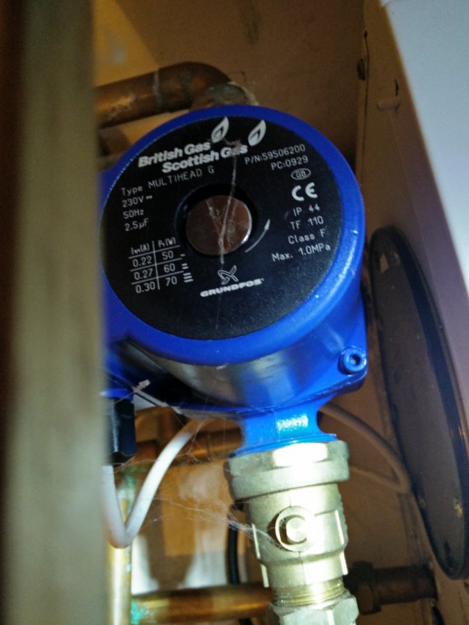

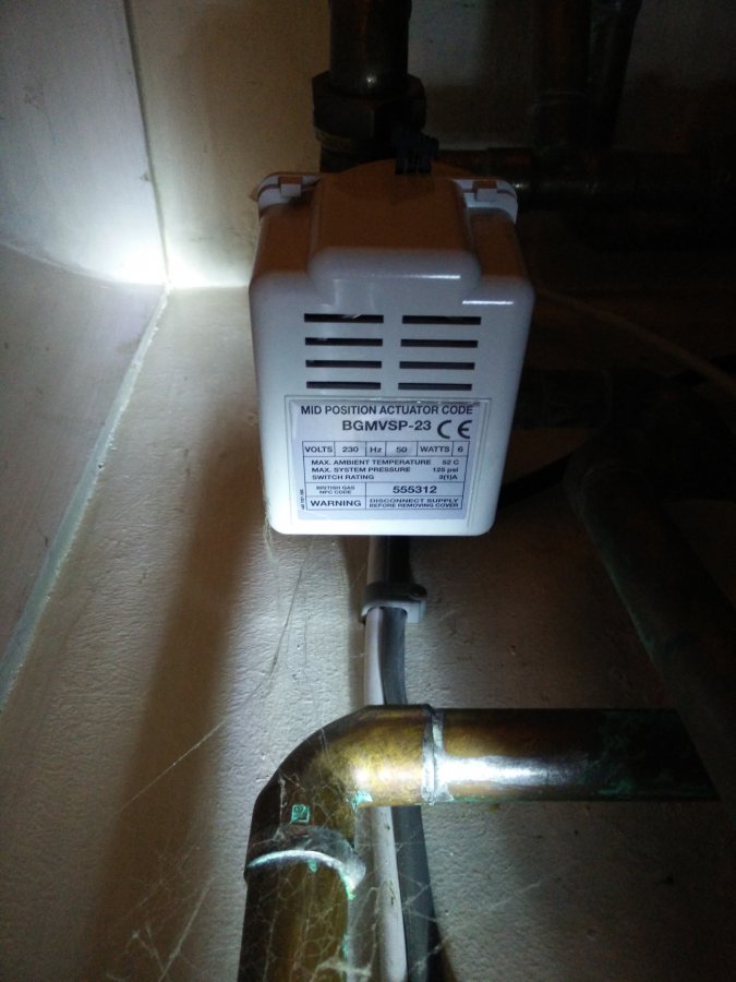

I attach two photos here. I guess the first one is the port/valve? what is the 2nd one for?

The second one is your three port valve, what you have described sounds like the three port is playing up, get the head changed and see if it cures both problems.

First pic is your circulation pump.
Second is your midport valve which is motorised to divert heat between Hot water cylinder; central heating, or both.
The head contains an electric motor which can wear out and it can fail electrically as it has a microswitch. The valve that it operates can also become stuck due to wear and/or blockages in the water system that it controls.
I searched and found Honeywell 2 port on the web. But I must admit I don't understand it completely. So it has nothing to do with the timer? I thought that the timer would cut off the power!
Yours is a 3 Port valve; and as has been stated, it does indeed contain a switch that operates the boiler. However, it is different from the 2 Port valve, in that the switch in the 3 port valve is powered from the programmer, via the room thermostat. (if one is fitted) Therefore, if the heating is switched 'off' at the programmer, the boiler would also go off as power is no longer supplied to the switch.
Although your valve is labelled as a British Gas product the valve is actually a re-badged Drayton MA1
