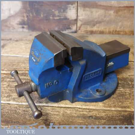

Right the Vice is a Record No 0. The worktop is 25mm thick. The bolt hole in the vice is 5mm.
Its on a old sideboard that I use as bench/storage thing. Not a big vice but fine for my use. It was my Dad's.

A small steel vice with 2 1/12 inch jaws. Sometimes described as a modelmakers vice

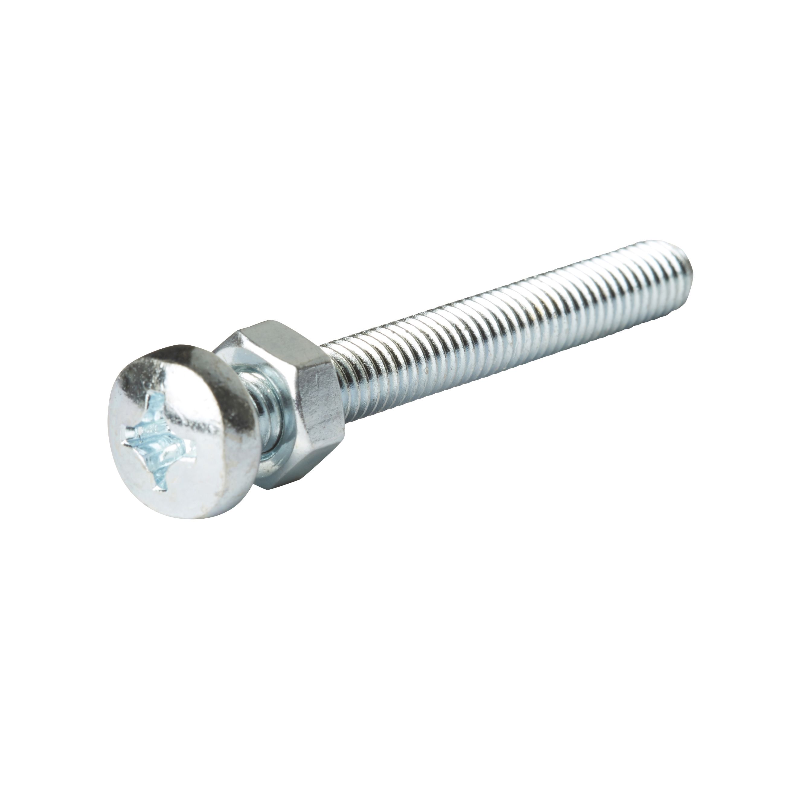

Add the thickness of your bench to the thickness of the vice base, i.e. bench =25mm thick, vice base = 15mm thick. Bolt needs to be minimum of 40mm PLUS length for washers and nuts, so looking at minimum of 50mm long. Its a small vice so simply take it with you to B&Q. Look in their loose bolts boxes, (or even open a closed one), and select one that will go through the hole and have enough length to go through the worktop and fit a washer and nut on the end. I would suggest putting a washer under the bolt head as well as one underneath so, assuming only 2 fixing holes, you need 2 bolts, 4 washers and 2 nuts. I would use nyloc nuts as ordinary ones have a tendency to work lose through vibration.

Order M6 HT screws and nuts. M6 means a metric thread of 6mm diameter. You order by length such as M6 x 40 hex HT which means the threaded shaft (excluding the head*) is 40mm long. Hex means a hexagonal head you can turn with a spanner (but not allen or socket head). If you want to be able to remove it quickly, you could get wingnuts, but they are not as strong. I think you will have enough room for the ears. HT or 8.8 means High Tension which is a very common grade with extra strength. A screw is a bolt that is fully threaded. If you are clumsy you can buy Acorn nuts later which are very pretty and will not gouge your hand.

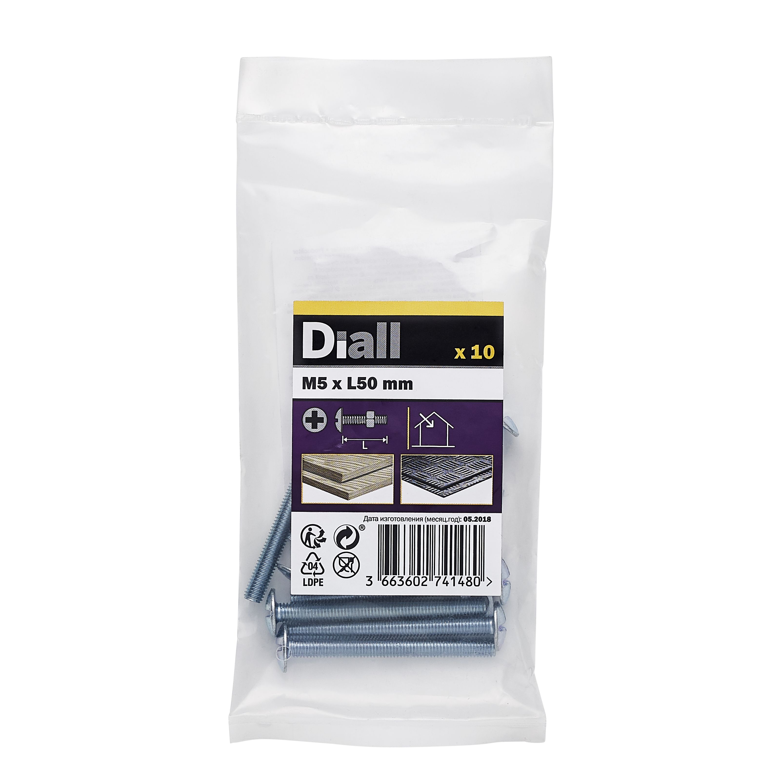

Note that OP claimed the holes were 5mm.
OP, if that's the case, you should acquire M5 bolts and nuts
