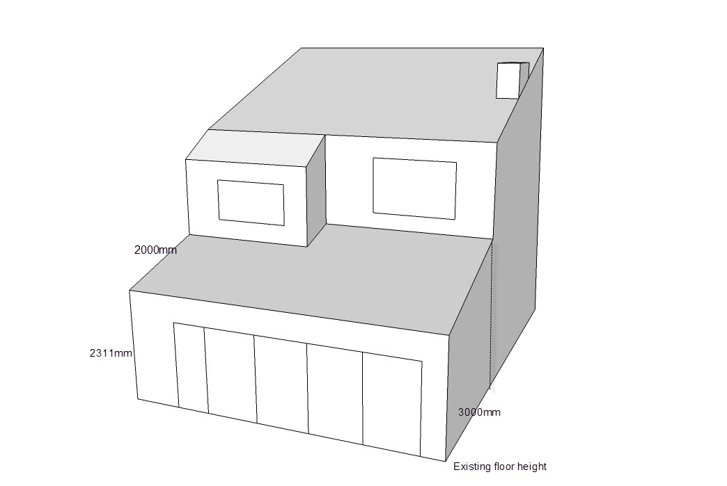

The rear wall will need 2 Pitching plates because the existing kitchen sticks out 900mm from the Lounge wall. Although I have calculated where the lower plate needs to go on the kitchen wall, practically what I thought of doing is fixing the pitching plate & rafters over the Lounge wall first then fix several battens across the span and offering up the shorter rafters to the battens to see where the pitching plate for the kitchen wall should go ? Hopefully that should agree with my calculations.
The roof will be tiled with Marley Modern or similar, pitch is around 18 deg, I'm not putting any Velux in, and will space the rafters at 400mm centres. Do I need to put any double width rafters in or will it be OK with just singles, and noggins, right across ? The overall width of the extn is approx 6.3m
Is a 50x100mm timber thick enough for over the patio door beam, bolted to it, or do you guys go for 75x100mm ?
