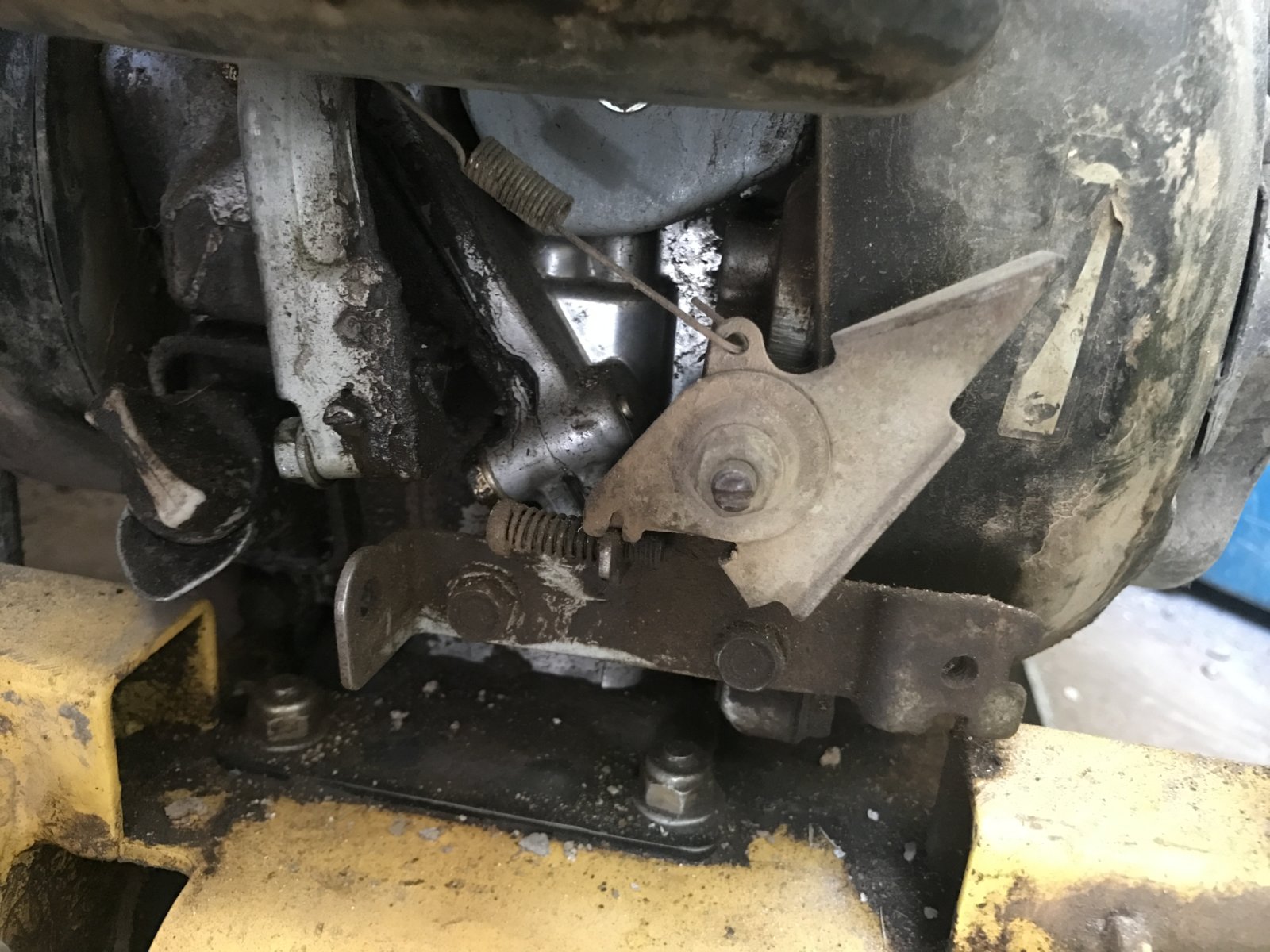

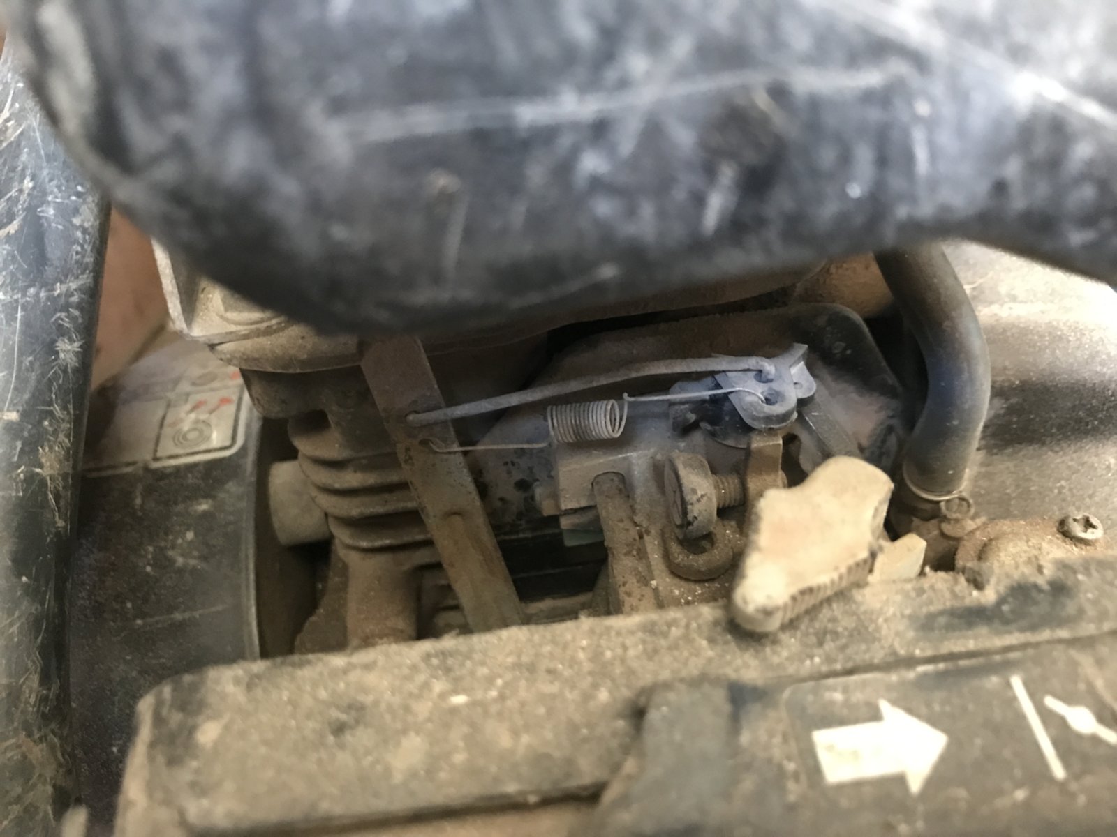

First oroblem though, it's starts easy but has a very very fast idle. Any ideas?
Throttle cable pulling away from the stop on carb ?
Does it have a throttle on the handlebar, or a lever type on top of the engine?
Give us a pic of the linkages if you can.
John :)
It's a level on the engine, I'll take a pic when I get home :)

On the top pic, the machine is set on full bore. When the lever is turned clockwise it should touch the spring loaded stop and start to idle. Does it respond to this?
Lower pic - that vertical lever should spring to and fro around 15 degrees if the governor is active.....with the engine off it should try to keep the engine at full throttle.
