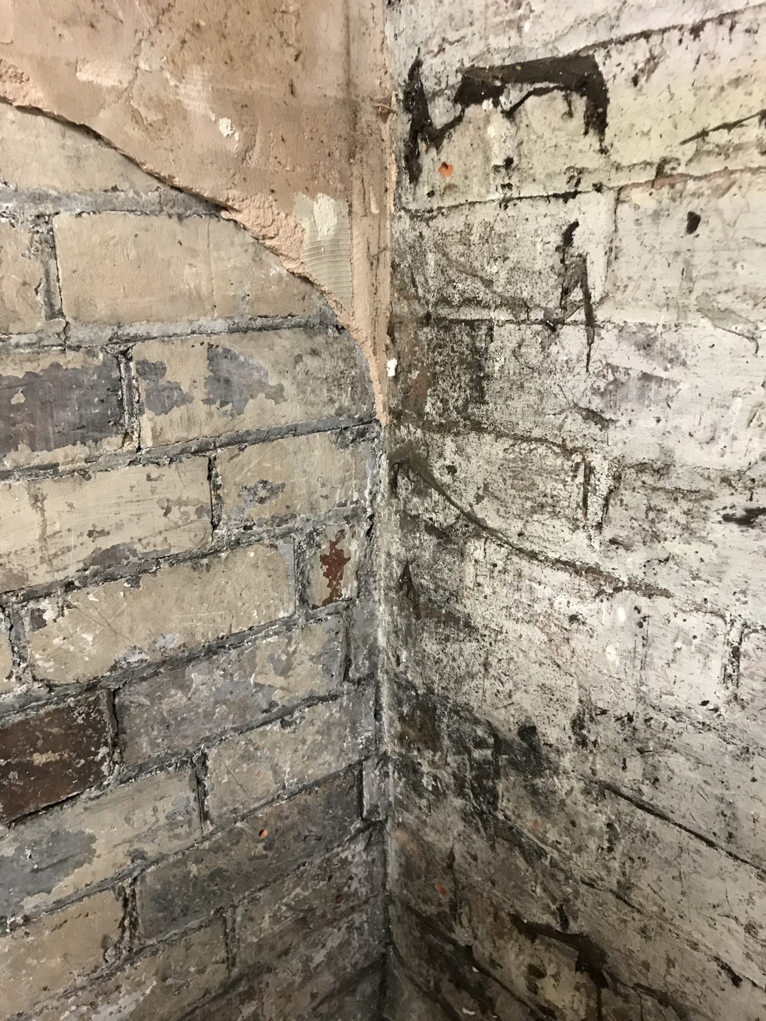

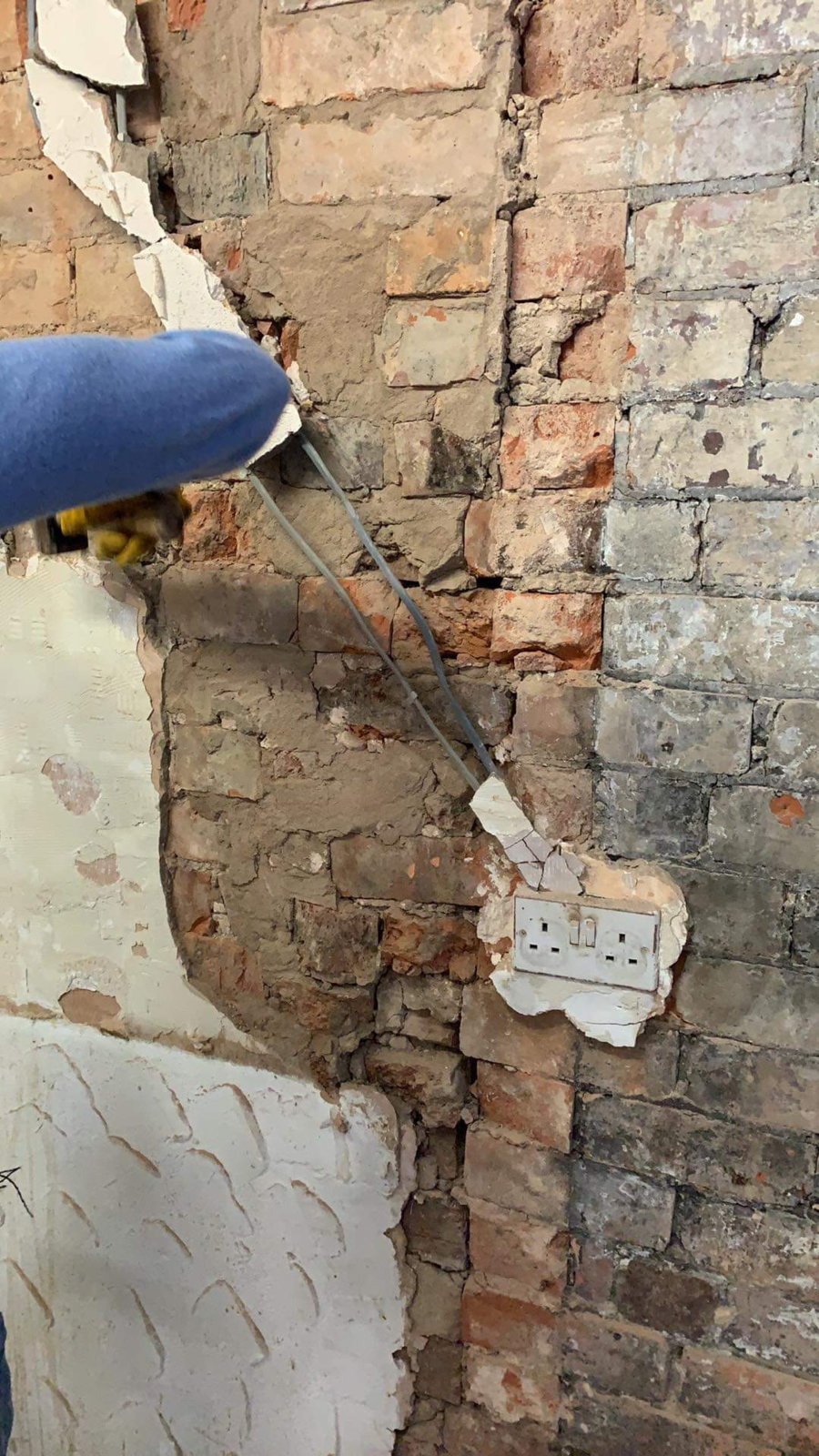

This tbh. There is a big hump in the centre of the long wall (pics to follow very shortly). I’m fairly confident I could correct that with dot’n’dab, but as it’s a 4.4m long wall and 2.7m high, I’m not confident I could bond and set it successfully.
I’m tempted to have a go at the smaller wall 2.2m x 2.7m. What’s the worst that can happen? ‍♂️
So just got onto site after 4 days without heating (gas meter moved).
The walls aren’t damp. I think the darkness is the remnants of dust of some sort. The bricks are fairly cold as would be expected but don’t feel damp.
Is there a Jungle math way of testing for damp?
Really appreciate all the advice so far guys, hopefully those pics will inspire more

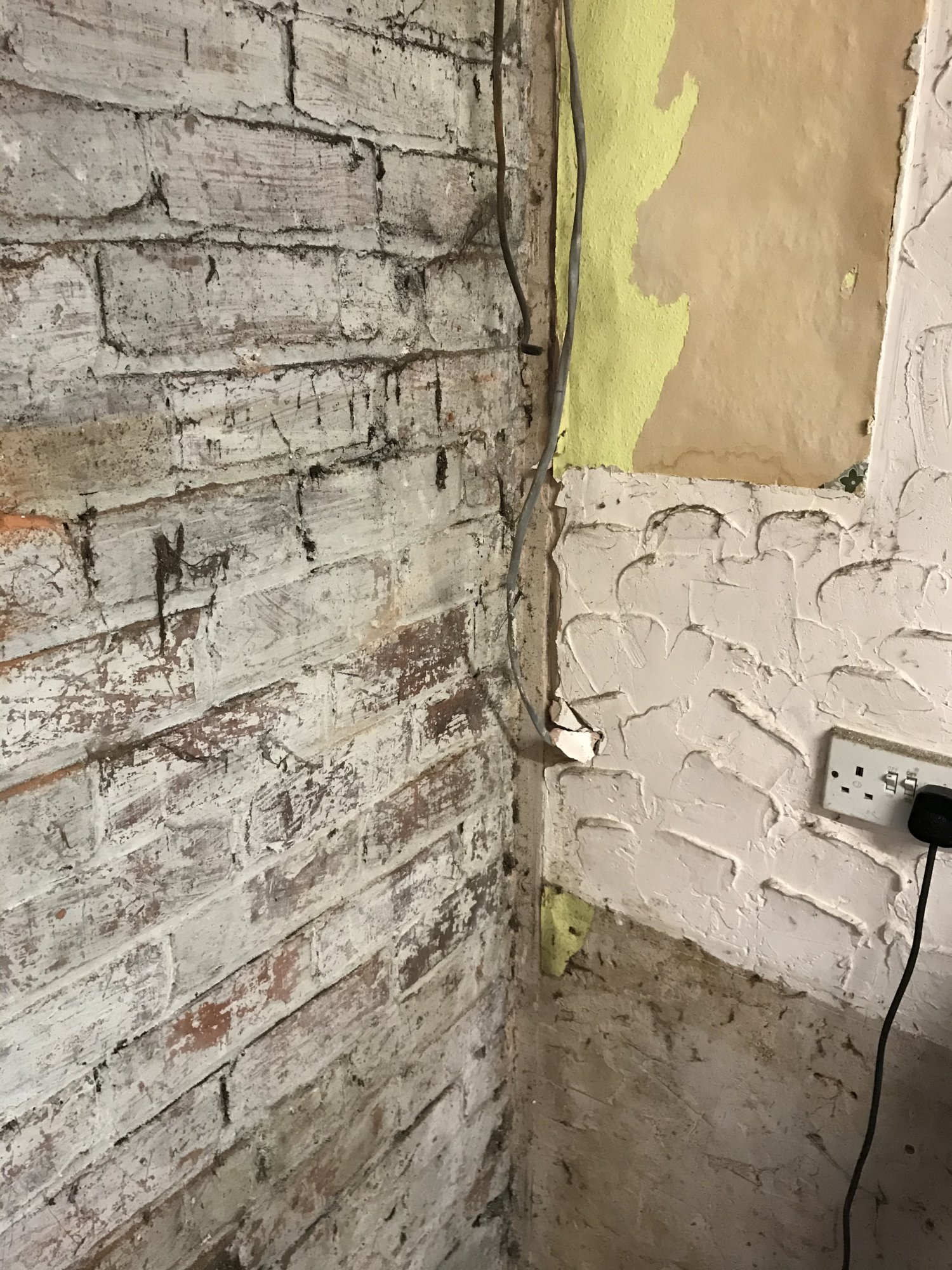

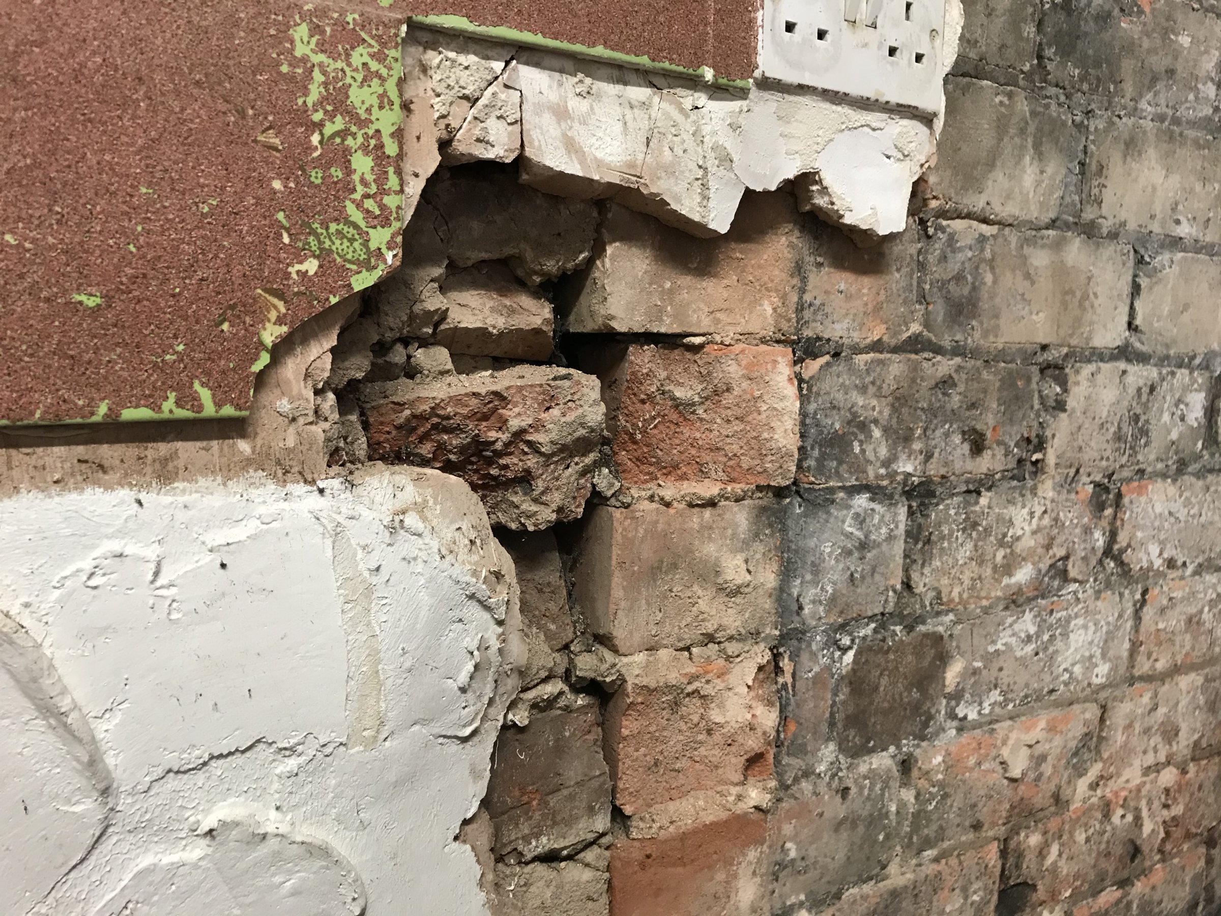

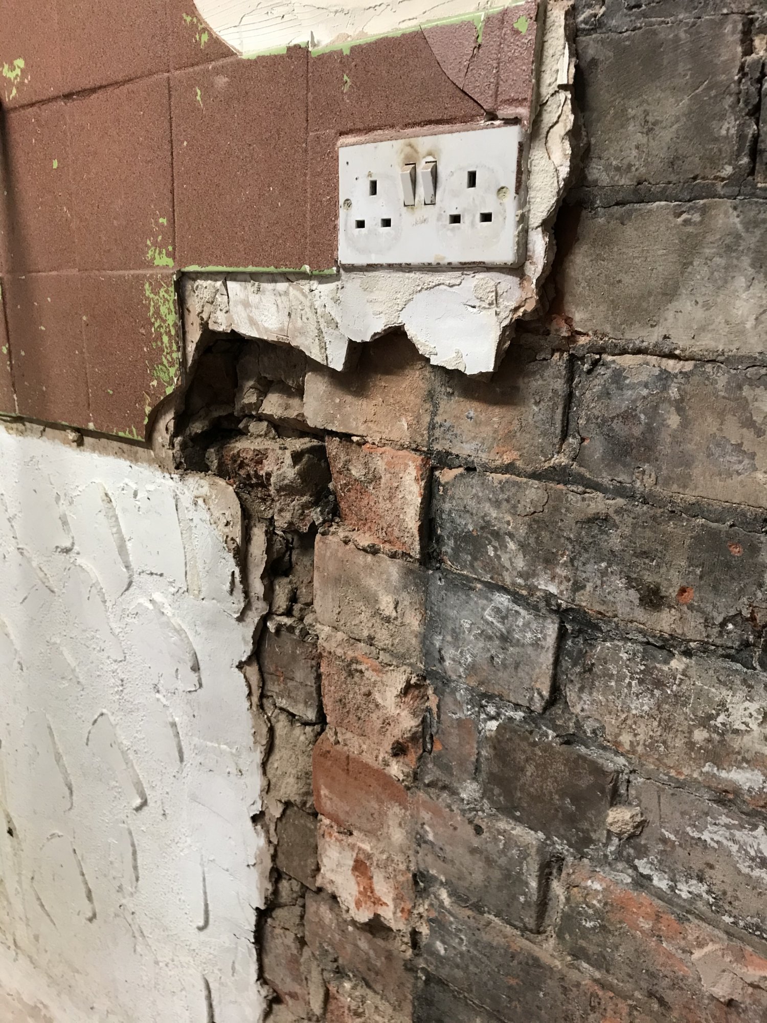

Ok, so the wall is mostly back to brick now. Oh the joys of ancient electrical work.
Safe zones? Wth are they?
There are so many potholes, I’m wondering if rendering might be better? Or at least some cement based gear?
I now don’t think that d&d will work. I’d have to pack the low points out with so much board adhesive that I’m just not convinced it will be the best way.

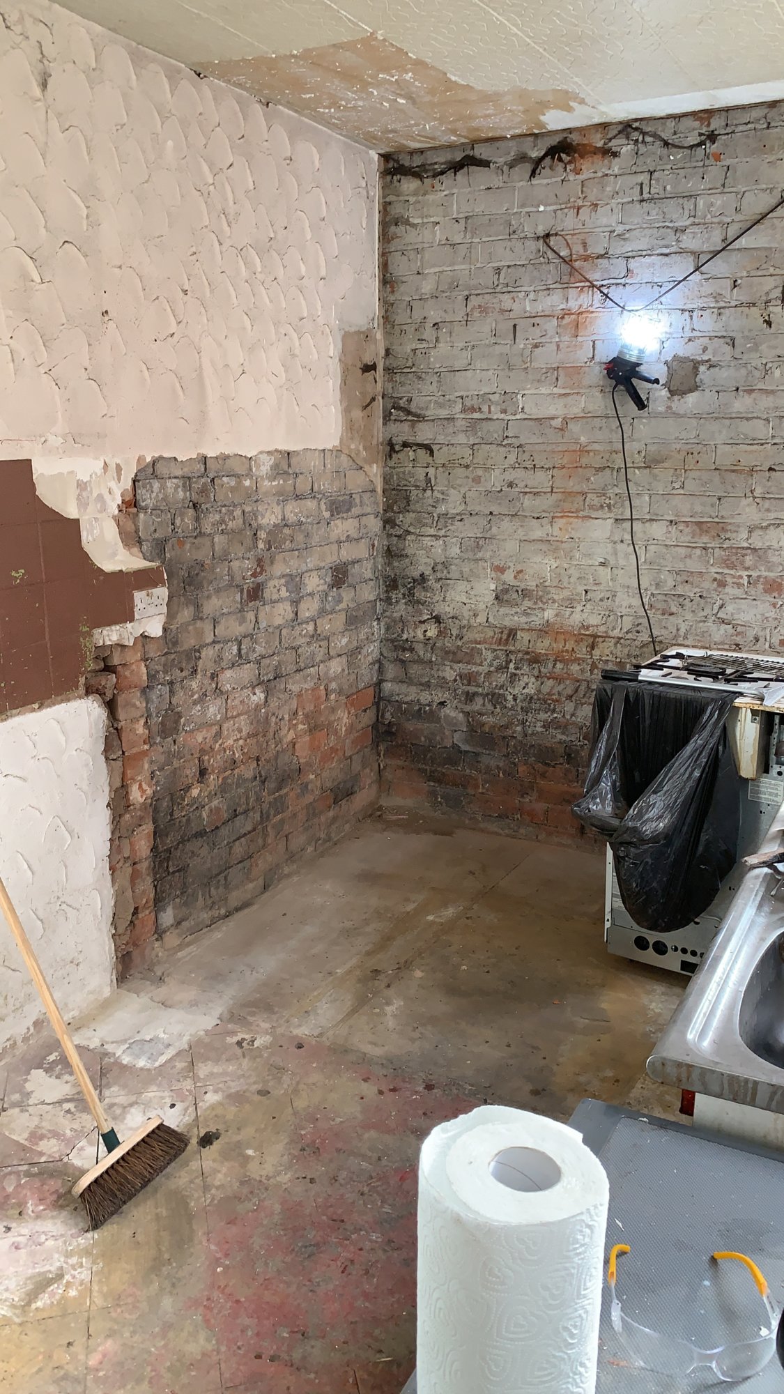

So, I’ve decided to have a go at rendering the wall. (What’s the worst that would happen? ) Having seen the pics posted previously and consider that some parts of the wall will need building up more than others, would you go for sand and cement render or drywall? What prepr would you do? PVA or light cement brush with EML(?)
Please give reasons for your answers, thanks
