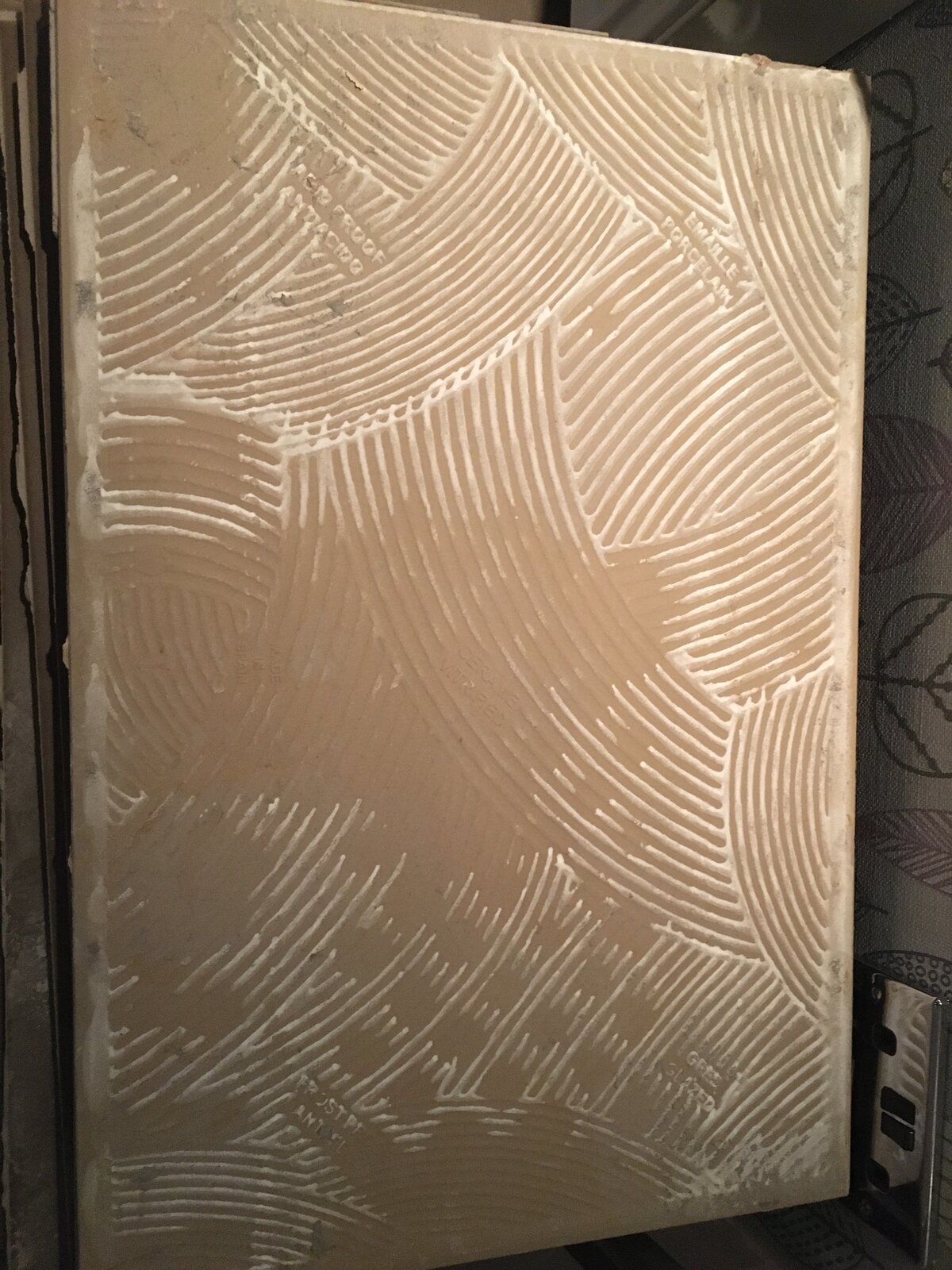

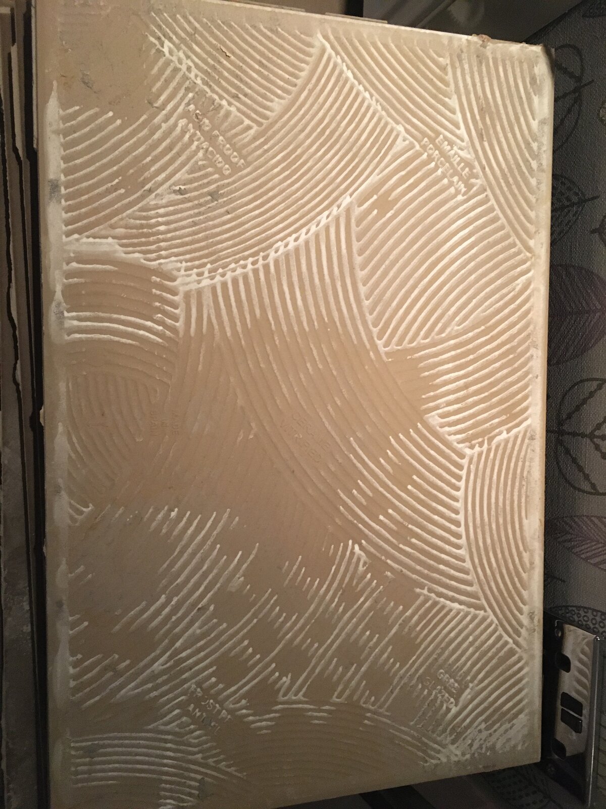

Bonded ceramic floor tile cracking, sounds hollow

The reason it failed is because the tiles were not properly bonded to the adhesive - 44 tiles? if they're 300x600s that's only 8 sqm. Personally I'd repair the slab with a bit of cement, clean up any loose bits of the old tile cement and re-lay some new tiles. It's a doable DIY job - and this time back-butter the tiles rather than just lay them dry onto the combed adhesive - it helps to ensure a really good bond - over 8sqm and the old adhesive I wouldn't use a decoupling membrane on that small area unless there is huge temperature fluctuation summer/winter.
I’ve probably miscalculated somewhere along the line but the floor is 13.5m2.
We’re not wanting tiles down again now - will go for laminate instead but that will obv mean having to remove the cement from the concrete and given none of it stuck to the tiles ...... that’s a lot of work required!
Making a claim is what I feel like doing but we wouldn’t want to spend on the repairs if there wasn’t much chance of getting money back - so it looks like a DIY job.
That being said, they are sending somebody out to look at the base so I guess ‘if’ they agree repairs need to be made then they should also agree that the tiles needed lifting in the first place.
