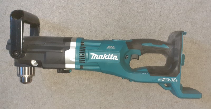

I have no idea why the price differential, however as mine came to me in 2015 with a "Made in Germany" sticker, and Metabo have moved a lot of production to China in recent years, might that not be part of the answer? TBH at the time I bought mine I could not find a suitable alternative. Bear in mind that I akready had am 1100 watt heavy duty 2-speed drill, that there really weren't any viable cordless angle drills (I did own a Makita 18 volt cordless LXT angle drill back then) and that the one readily available, relatively affordable heavy duty angle drill, a Makita, was over £300. So Bosch and Metabo adaptors were really the only other game in town. And if you want to attach an angle head to a conventional corded drill they still are, although there are quite a few heavy duty cordless angle drills out there now, from DW, Milwaukee (the "Hole Hawg") and Makita:Yes
