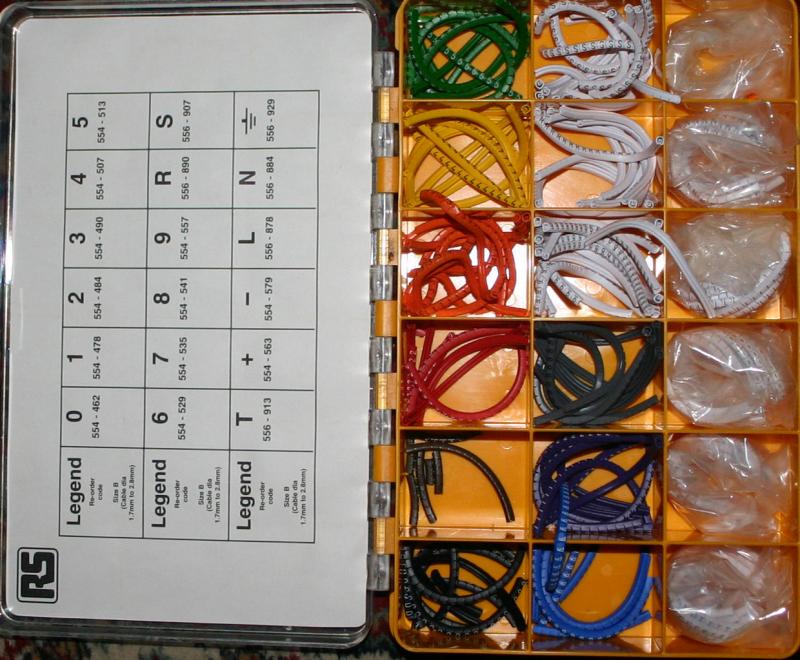

Not fiddly at all with the right tool, failing that a 2" round headed nail works just as well for sliding them over cable ends. (Its amazing what you have to do sometimes on site! :LOL: )
Too slow! :LOL:
Those plastic 'tube' type toothpicks also work well for small CSA wires, but are not too easy to find onsite!
2" round nails aren't either!
Thats why I always carry a few in my box!
If you use good quality markers of the correct size then no tools are needed at all.
I always use Partex PA1 series which covers conductor sizes of 0.75mm2 to 4mm2.
You could use coloured heatshrink over the crimp ends if you need to, if there's a real risk that crimp size ID might get confused with conductor ID.
You can also get clear heatshrink for attaching labels with.
However no-one technically unaware should be anywhere near anything crimped as it should all enclosed and inaccessible without the use of a tool.
These are a good idea too but a bit fiddly to use.
They're not fiddly at all as long as you use the ferrule tool to get them on to the wires and don't **** around trying to use a screwdriver or fingernail!
