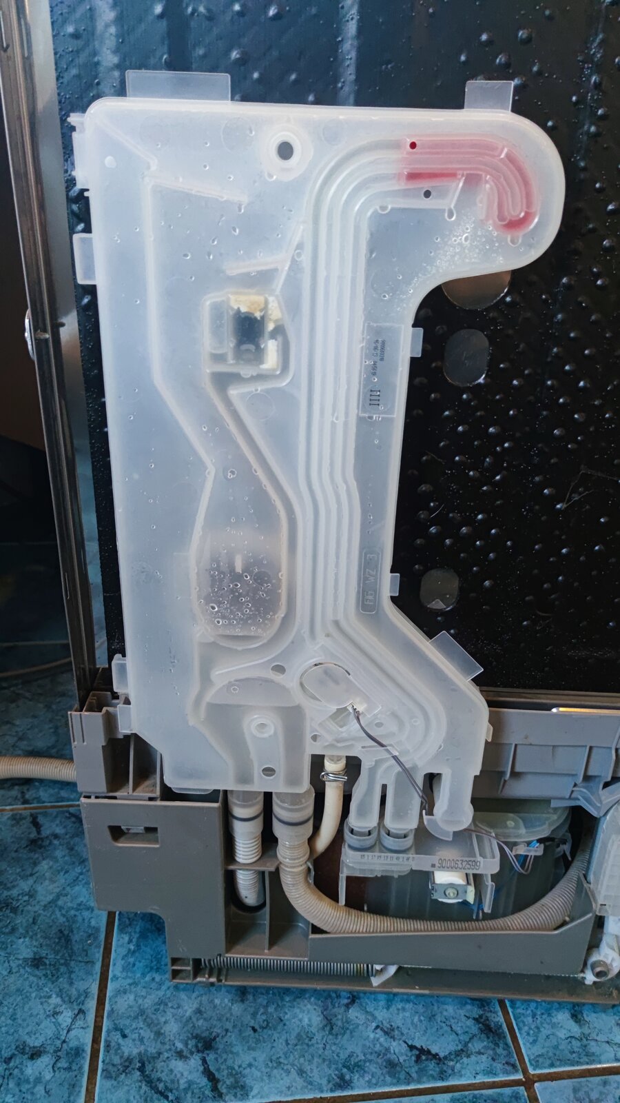

I've removed the plastic matrix, there are two plastic components on the inside left of the dishwasher one near the base and the other half way up. Once removed you can also unclip the metal clip on the water inlet and disconnect the grey wire. It should then just pull out of the other hoses. I've cleaned it but can still see gunk around the black float at the top left. I also have the orange stuff - no idea what that is?

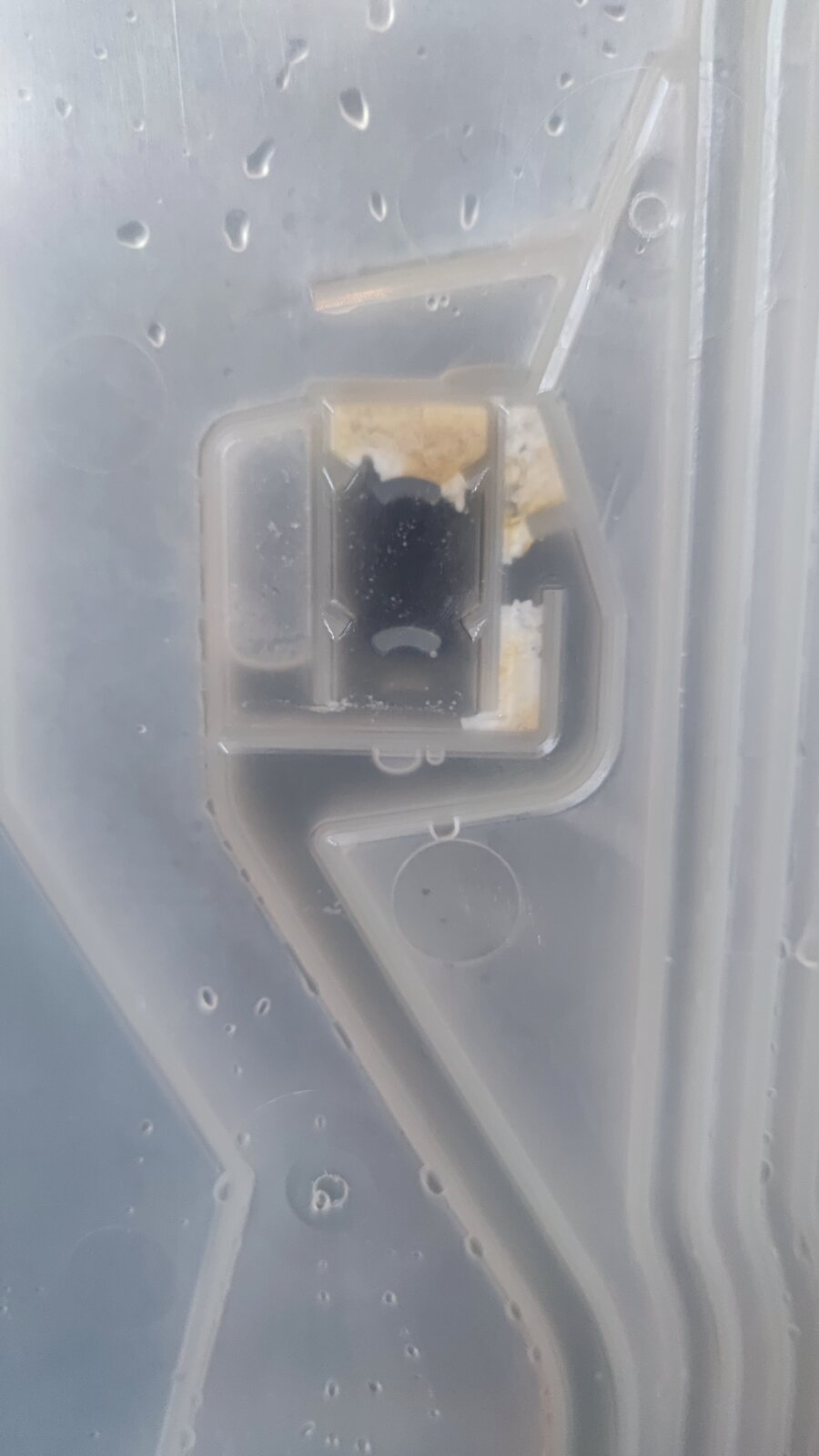

I could see on youtube the possible issue and once i had removed the side panel it was a textbook example of a serious clog. (identical to pics in original post)
My big problem was that Bosch have changed the design making it much harder to remove the matrix. (I think thats why some of the above posters have found it easier to remove than others)
In the end i took it into the garden and managed to unattach the outlet hose (which was the only one to come off easily)
Chucked a bottle of dishwasher cleaner in the now upside down dishwasher, which did a little in terms of moving the gunk, and then put in some bleach which sorted it out in under an hour. Then rinsed it out with a hose and connected it back up and its running fine.

Thank you so much for this. I fixed my 8 year old Bosch D/W with no parts. I originally thought the E14 error meant I had to change the sensor. When I took the machine out I saw all the gunk in the matrix and decided I needed to clean it out. I had trouble understanding how I could take the matrix off. I read the comments re the two components inside the dishwasher on the left wall that had to come off. (The grey water inlet at the bottom and the big dryer exit). However there were no instructions on how they came off. I found another video on 'How to replace a drain hose' which showed they had to be screwed off just by twisting the parts. https://www.ransomspares.co.uk/dish...w-to-replace-a-drain-hose-on-a-dishwasher.htm. I cleaned the matrix as well as I could but could not get all the gunk out. The sensor switch looked okay so I put everything back together and the program went fine until the end when I had an E15 - leak. I had accidently kinked the black washer round the dryer hole, plus maybe water from the matrix (when removed) had spilled into the water sensor underneath. I re-situated the washer and tipped the machine 45 degrees to the right to get the water out (should have been backwards?) but that seemed to fix it.

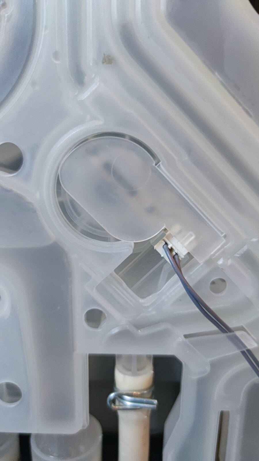

I have a Bosch integrated dishwasher (SMV50C00GB) which is about 5 or 6 years old.
It completes the cycle perfectly but we have a small amount of water that ends up under the dishwasher after every cycle (i.e. in the tray that also contains the anti-flood float and switch).
I have traced it to what appears to be the overflow in the metering / fill tank, on the left hand side of the dishwasher. There are 3 areas of the tank that look like they have filled up with 'gunk' and I think this is what is causing the overflow to be in use - albeit it's only a couple of teaspoons worth of water per cycle.
So, rather than buy a new dishwasher, which seems rather OTT to fix this (!) I'd like to perhaps try and remove the metering tank and attempt to clean it out.
I have added some photos below.
1. Metering tank. Overflow is on the left side of it.
2. Upturned 'U Bend' (waste flows right to left) showing the 1st blockage (above it).
3. 2nd blockage - higher up
4. 3rd blockage (small).
Is the metering tank something that would be cleaned/unblocked sufficiently if I use a good dishwasher cleaner liquid/powder on a full cycle? We have never used cleaner, nor any salt, since our water is quite soft. Would it be wise to start using salt?
If I want to remove the tank to try and clean it, it looks like there are a couple of retaining clips either side (grey clip on picture 4 above) which would need releasing after pulling out the drain and feed hoses (O-ring seals)? Is it common to remove this tank and refit it easily? What's the best way to clean it thoroughly and remove all the blockages?
I've also noticed a lot of crystallised orange material in a larger tank underneath - shown in this photo - is this normal?
Any help would be much appreciated - I'd rather not buy a new dishwasher because of this, but will do if there is too much to sort out (the tank containing the orange stuff looks impossible to get out, for example!).
