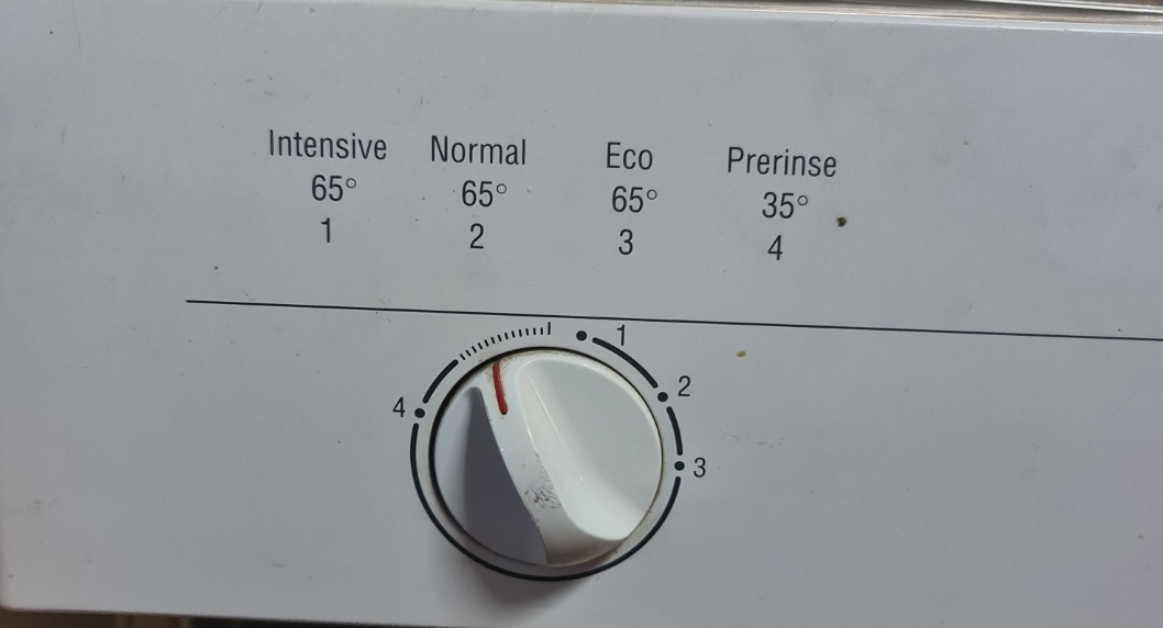

Dishwasher is bosch SGS4012GB/01
My dishwasher kept tripping on the end of each cycle. I assumed it would be something to do with the drain pump as it was the end of the cycle so I took all panels off and inspected wiring and water bladder.
As you can see the pressure chamber was filthy and where I marked on the top left of the bladder was completely full of black gunk. I've cleaned everything including the pipe that joins the pressure chamber. Now i reassembled everything and gave it go It keeps on filling till the overflow float hits the lever causing it to drain then fills and keeps repeating this process.
So my drain pump is working . I can turn the dial to different parts of the cycle and it no longer trips. If I engage the blue lever on the pressure chamber it will start the cycle I'm guessing it something to do with this also there is no water on the bottom of the machine
So I don't have enough pressure in my system ? , the pressure chamber works I blew into it and it engages the blue lever. I have seen online similar issues with a faulty flow meter (impeller jug) online so I'm unsure on what the issue is hopefully someone can shed some light I also find it strange that it no longer trips

You don't have an impellor jug on yours the fill level is controlled by the pressure chamber. You say you have cleaned the ribbed pipe with the o ring going from the pressure chamber to the sump, did you take it right off because a blockage in there gives you the issue you are having. If you remove the lower door panel if not already done so and the front lower access cover that pipe will come right off.
Hi , yes pipe was taken off completely cleaned so no issue with a blockage
