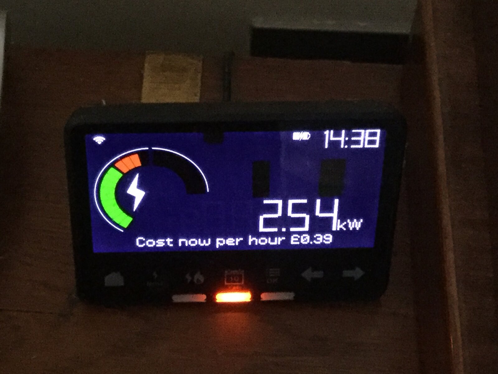

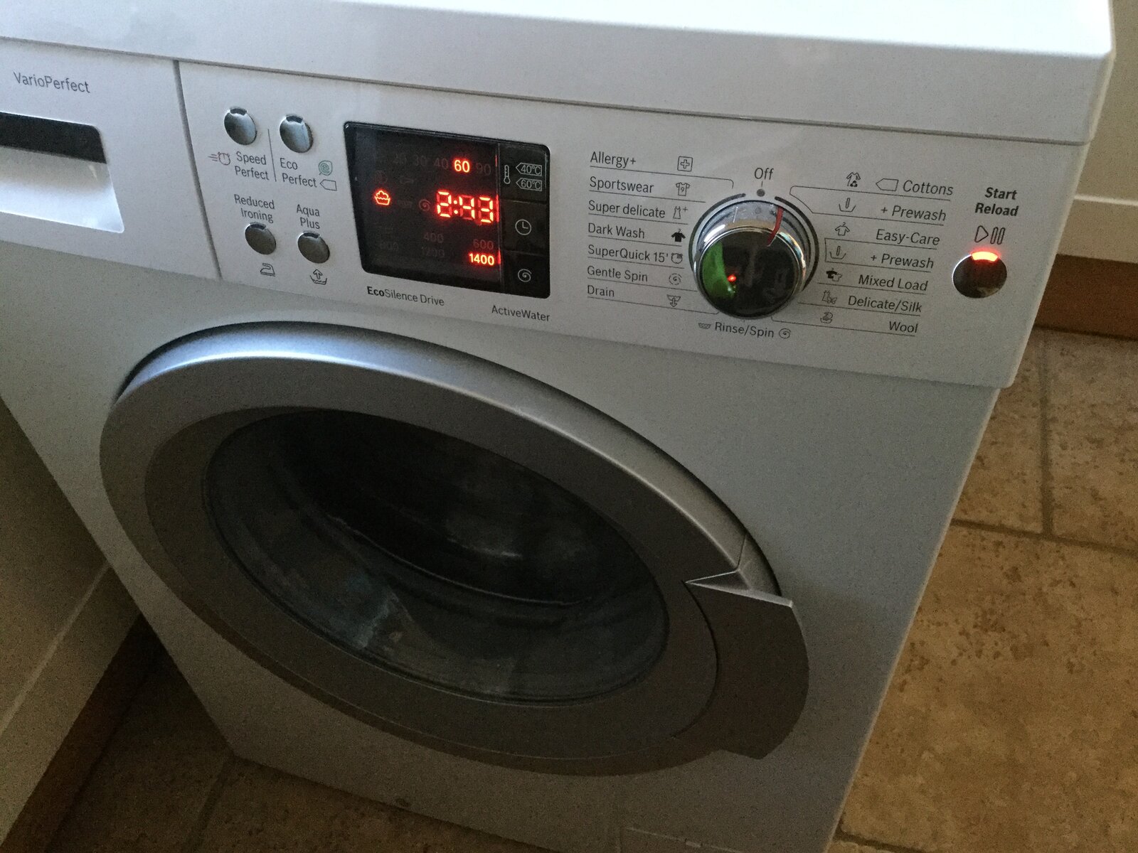

Eternal thanks once again. (2nd photo proves it’s heating up).
