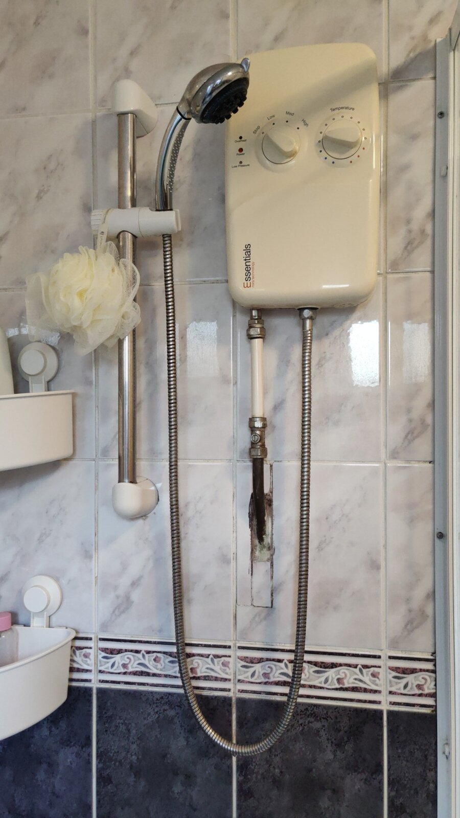

Hi everyone,
I've just bought my first home, and trying to slowly put right all the bodges and outdated decor. I am useless with DIY, I've been renting all my life, so trying to fix things is completely new to me. This '90s Mira shower is one of the first things that has to go, but I don't understand how to sort out this horrible exposed pipe. What needs to be done to get a newer shower installed so that the pipe is hidden? Is it going to be very intrusive/expensive to put right?
Thanks so much in advance!

Oh dear!
These showers allow a water inlet through the back.....what is behind the wall where the shower unit is? In other words, is the water pipe accessible?

I really don't know. Sorry to sound so uneducated, but how can I check this? It's on an external wall, on the ground floor (Vic terraced). I should say, I've only been in this house for a week, so I'm still very much getting my bearings.
With an external wall behind it, almost certainly it will be brick. Try tapping it, if it sounds hollow, probably plasterboard, so not a difficult job to hide it behind. Brick will need chasing out.
Ok thank you so much, I will investigate!
The wall behind is indeed brick as far as I can tell. I may need to just condemn this shower and have a mixer tap and shower fitted to the bath instead, until we can afford to properly renovate the bathroom..

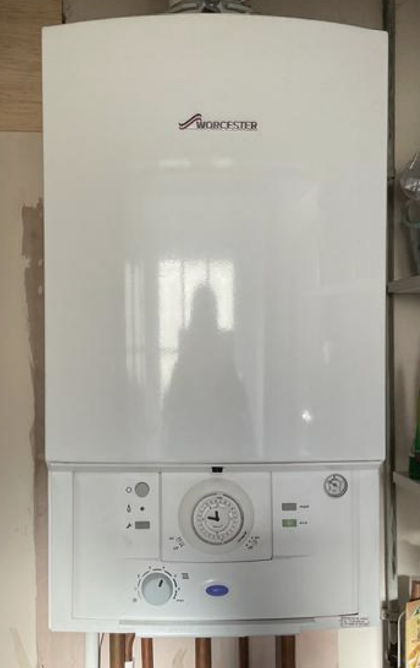

So being a combi should give you a far better shower than the electric shower.
Fitting thermostatic taps like these should enhance a good shower.
