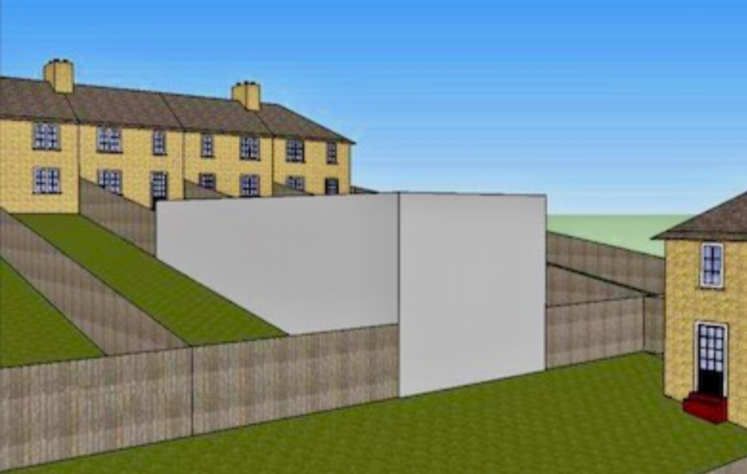

There used to be a website called planning jungle which had drawings illustrating some of the "idiosyncrasies" of the permitted development rules when it comes to sloping land - the image below demonstrates in the extreme what is perfectly legal.

No, the height (maximum 2.5m) is to be measured from the highest bit of natural ground level adjacent to any part of the perimeter wall of the building.
The key word is NATURAL ground level. You cannot raise the ground or build it up with a thick concrete slab and measure from the top of that.
But as cdbe's and freddie's illustrations, on a naturally sloping site you can have a perfectly compliant building that is well over 3 metres high on the neighbours side. One of the many glaring anomalies in our rubbish planning system.
